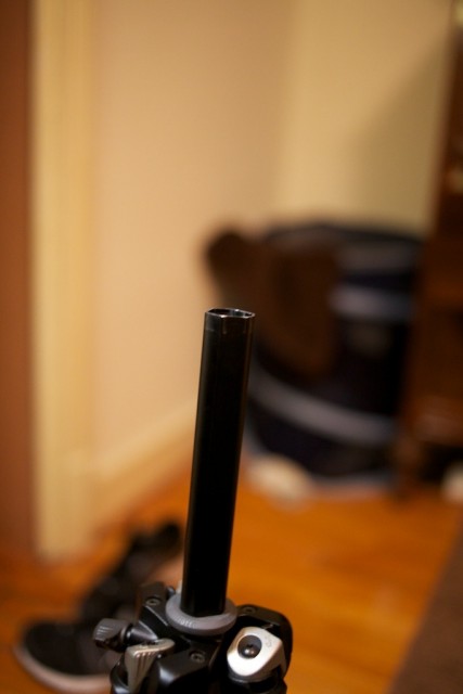

I just was shooting a film in the backyard with some friends and the tripod head of my Manfrotto 494RC2 popped off of the legs! I cannot figure out how to reattach it. If anyone has any advice, that would be greatly appreciated!

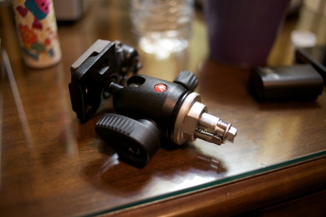

I'm not quite sure if the stud was sheared off, but here's some pictures of the results. From what it looks like online, the mount that is generally attached to the legs is now dislodged and with the ball head.

I've heard of that happening before with that tripod. Best repair option is to clean the mating surfaces well, rough them up slightly with some coarse emery cloth (or sand paper) and re-attach with JB Weld adhesive. http://www.jbweld.com/product/j-b-weld/ - available at Lowe's, Home Depot, etc.
If you want to do an extra neat job, wrap the column with masking tape, and after the glue has had a short while (15 or 20 minutes) to begin setting up, pull off the tape to remove the extra glue which oozed from the joint.

that is the top of the centerpost (the platform) and your head is still attached to it.
looking up from the bottom (silver) you should see 3 screw ports 120 deg apart on the base outer portion. there should be probably slotted screws in these ports. loosen them and you should be able to take the actual head (black) off of the platform (silver). that will make it easier to work with.
if you are good with tools and have some (metric sockets with extension) it maybe a relatively easy fix. if not see my first line.

The platform on my 055ProB is assembled the same way, which is to say the platform is a press-fit into the top of the column. I recall seeing a YouTube video of this failure a few years back. I agree that if the tripod is under warranty, let Manfrotto pay, but if not, the JB Weld will do the trick.

I agree with dcains that it’s a press fit from what I can see. It looks like a conical nut/screw inside edge that presses the trifurcated mount against the column walls when the nut/screw is torqued down. If this is the case I believe an extended socket wrench from the bottom of the column will remedy the situation.

Agreed, but there's a problem re-assembling as original. The bottom end of the column will be sealed with another press-fit part, so accessing the nut through the column will not be possible without doing some additional damage. And, the thin aluminum at the top of the column is very likely stretched, which is why the two pieces separated. I'd bet that nut isn't loose at all. It's a silly design, not meant to be serviced.
Here's a pic of the short top column section from my 055ProB to illustrate the lack of access to the nut:
http://deanwcains.smugmug.com/photos/i-9q33HML/0/L/i-9q33HML-L.jpg
So, see what Manfrotto has to say, but if they're not agreeable to a free replacement/repair, I'd go with the JB Weld fix. Properly applied, that adhesive is damn tough to break loose.

I actually did both - tightened the bolt back down and applied JB weld. A few hours later and it already appears to be good as new. Thanks for the help, everyone!

(For what it's worth, the nut was loose)
