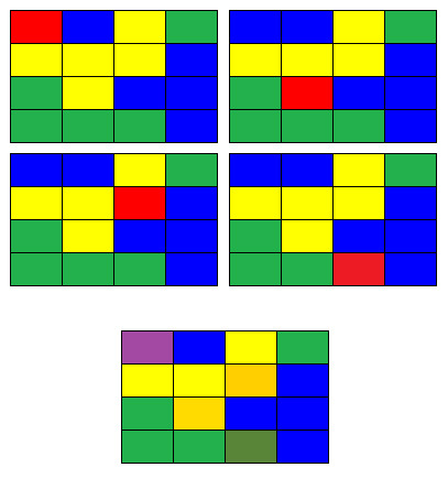

BrianO
p.1 #15 · Mult-exposure averaging on 5DM3 to reduce noise
AGeoJO wrote: ...I didn't quite get how the noise reduction works by averaging several images exposed at the same exposure value.
As others mentioned, a lot of noise is random in nature, generated by the amplifier in the sensor, stray photons, etc., and so it appears in different places in the image, whereas actual image elements will be in the same position.
By stacking multiple images, the fixed data is increased in "density" by the number of images, but the random noise isn't.
If we were to shoot four exposures of a sixteen-block color array it might look like this, with the red blocks representing introduced random noise and the bottom image representing the combined "noise-reduced" image.
