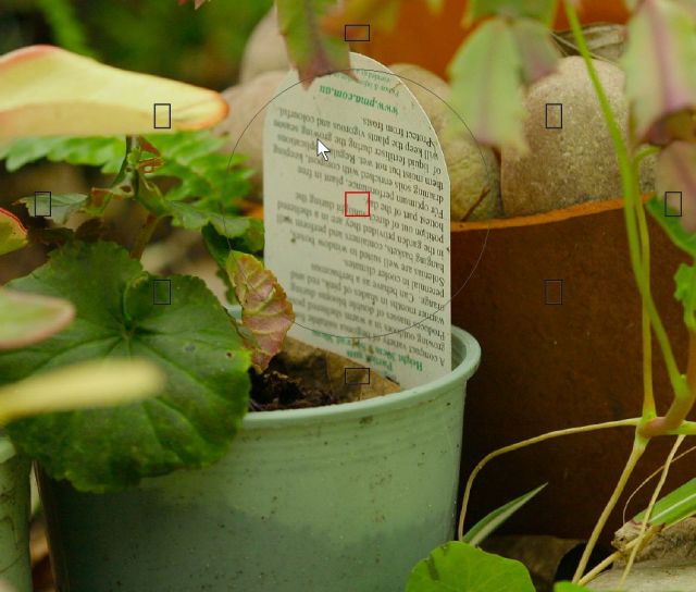

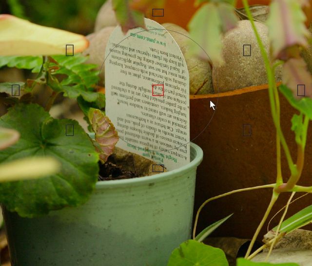

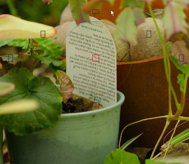

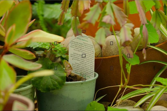

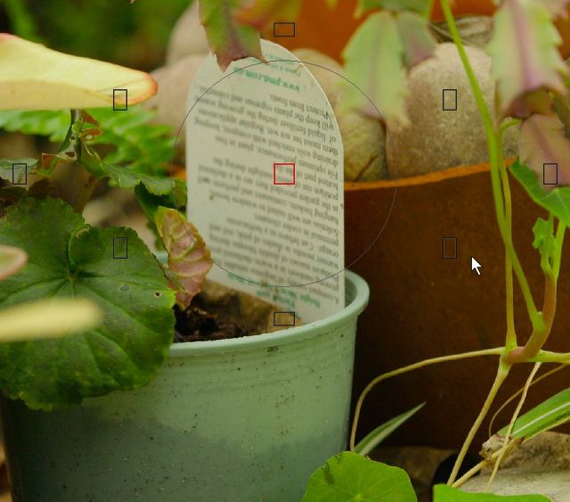

The next 7 posts will contain images that are screen dumps taken from a BreezBrowser display of a set of photos that show the focus drift on my new 40D. They do not show the entire images - just the portion with the AF sensors and below that. The 7 that I have shown represent all 16 that were shot as some are almost identical and not worth posting.
I was using a Tamron 180mm f/3.5 macro lens handheld.
ISO 800
shutter speed 1/1000
aperture f/3.5
The card that I photographed had little interest other than to show how wel the focus worked. It was in a pot plant almost 3m away from me.
I should add that BreezeBrowser was set to show the photos in fit-to-window size rather than 1:1, and that image enhancement was on (increased sharpness, etc.). Therefore you should not take these samples as an indication of 40D image quality - just the focus problem.
- Alan
Edited by Alan321 on Sep 19, 2007 at 01:42 AM GMT
Sep 18, 2007 at 11:18 AM
Alan321
Details
p.1 #2example of 40D focus drift in AI Servo.
#1,2 & 3 all were OK...

p.1 #3example of 40D focus drift in AI Servo.
#4 is pretty much OK but shows the first signs of drift. The aiming is still OK.

p.1 #4example of 40D focus drift in AI Servo.

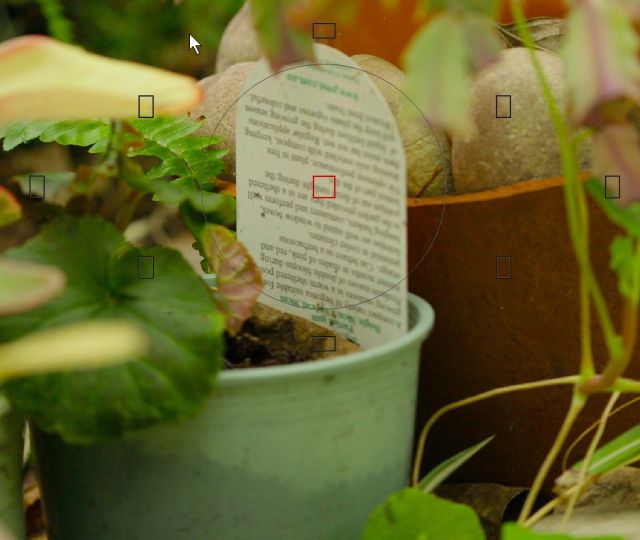

#5, 6, 7 & 8 are all way off. Notice the sand on the near surface of the pot is in focus, and yet that is way outside the AF sensor area. The aiming is still pretty much where it was, however.

#9 is coming back towards where it should be focused (and used to be).

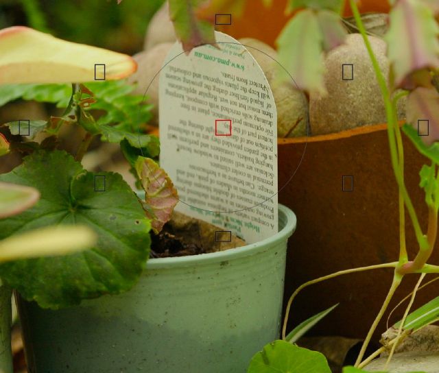

p.1 #6example of 40D focus drift in AI Servo.
but #10 overshot. #11, 12 were the same.

#13, 14 & 15 are back on target again. Still the aiming is almost identical with no appreciable aiming errors.

#16 is going south again, but this was the end of the sequence as the buffer was now full.

To my way of thinking this is definitely focus drift that has nothing to do with the size of the AF sensor (I was using just the central one, which is shown in red while the others are shown in black).
If it is not just focus drift then there is a problem wherein the other 8 AF sensors are being used when they should not be, and without any indication that they are being used. However, in a separate sequence I got it to focus on something that was covered by none of the sensors, so to me the problem is just AI Servo focus drift.
My 40D is now off to Sydney to get the AF tested and hopefully repaired.
So far my 1Ds2 has not returned from having its AF fixed.
I seem to be pretty good at buying cameras with AF problems but hopefully you'll agree with me that this series of photos shows a genuine problem and not just a case of imaginitus

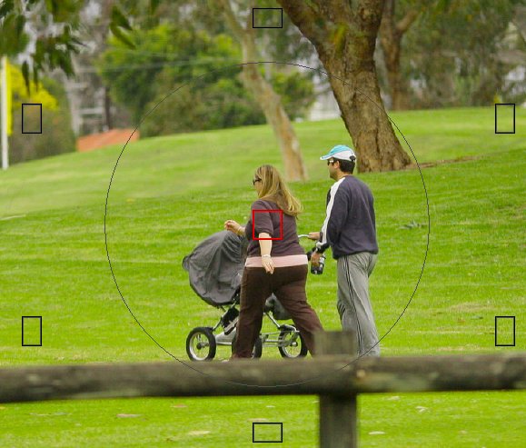

As I said earlier, the problem is not just for static subjects. If you're photographing people who are moving then you need to use AI Servo and keep it active, and yet I found that it still mis-focuses during a sequence of shots in which the AF sensor remains correctly aimed.
