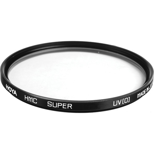

1       2       3              39              41       42       end
Archive 2007 · 'Master' EF 16–35mm f/2.8L II USM Thread
Harold makaske
p.40 #1 · 'Master' EF 16–35mm f/2.8L II USM Thread
If I look at the example photo΄s at that page I would never buy this filter
May 04, 2007 at 08:44 AM
hahr
p.40 #2 · 'Master' EF 16–35mm f/2.8L II USM Thread
ward1066 wrote:
anybody know where to get some nice UV filters for this lens that won't break the bank? Anybody going naked?
my lenses go naked 99.5% of the time.   i only add a UV when i need to shoot in inclement weather or add a polarizer when i need the effect.   with that said, i just picked up an 82mm B+W MRC UV filter for my 16-35L II to shoot close-up watersports this summer.
-erik
May 04, 2007 at 09:30 AM
EB-1
p.40 #3 · 'Master' EF 16–35mm f/2.8L II USM Thread
The 16-35 II can benefit from a filter in adverse conditions since the front group moves in and out quite a bit during zooming. I'm not sure how much dust would enter without it.
EB
May 04, 2007 at 06:22 PM
Ross T.
p.40 #4 · 'Master' EF 16–35mm f/2.8L II USM Thread
hahr wrote:
my lenses go naked 99.5% of the time.   i only add a UV when i need to shoot in inclement weather or add a polarizer when i need the effect.
-erik
Exactly!
I would be amazed if this mark II lens would be sucking in a bunch of dust.
May 05, 2007 at 07:38 AM
cineski
p.40 #5 · 'Master' EF 16–35mm f/2.8L II USM Thread
Don't want to get this too off topic, but this is my favorite pro-filter story:
Shooting at LMU in LA, early pm, shooting the waterfountain out front for a sunset shot. Setting up my tripod when suddenly the in-ground sprinklers turned on full bore and SOAKED the front of my (thank Gawd) rental 16-35 without a filter. I mean high pressure soakage. Luckily it was only for a moment, and I have no idea what happened to the internals of the lens, but I'm sure glad it was a rental. Also, reminded me why I use filters, seatbelts, etc. You don't plan on accidents, which is why they call them accidents.
May 05, 2007 at 04:29 PM
Stunnaz
p.40 #6 · 'Master' EF 16–35mm f/2.8L II USM Thread
The weight of 16-35mm is posted on Canon's website now (it wasn't available until recently)... the weight is 640g.
May 05, 2007 at 09:21 PM
beewee
p.40 #7 · 'Master' EF 16–35mm f/2.8L II USM Thread
Just finished a week of shooting in Hawaii and the 16-35/mk2 performed beautifully (even after being dropped from the seat of a van to bare concrete!).
Hopefully, I'll have time to post some samples in the coming days.
This lens is a definite keeper.
May 05, 2007 at 10:04 PM
neilgundel
p.40 #8 · 'Master' EF 16–35mm f/2.8L II USM Thread
Just tested my non-slim polarizer. Focused at infinity, it is basically the same as the slim version in terms of vignetting - i.e., just barely noticeable wide open compared to naked when looking at white wall shots.
As you focus closer, the picture is not as clear. Focused all the way in, you cannot stop down far enough to eliminate the dark corners. Focused at 1.5 feet, it is basically the same as non-slim filter from f/11 onwards.
So I would say for most purposes, you should be OK with the non-slim (mine is heliopan), since I rarely shoot wide open or closer than 1.5 feet with a polarizer, but if I had to do over again, I would probably order the slim so I wouldn't have to remember the limits.
Needless to say, all of the above is at 16mm, and I would expect no issues at longer focal lengths.
Edited by neilgundel on May 06, 2007 at 10:03 AM GMT
May 06, 2007 at 09:38 AM
Ross T.
p.40 #9 · 'Master' EF 16–35mm f/2.8L II USM Thread
Has anyone found their mark II to be sharper in the corners but Less Sharp in the Center than their mark I ?
May 06, 2007 at 09:40 AM
EB-1
p.40 #10 · 'Master' EF 16–35mm f/2.8L II USM Thread
Ross T. wrote:
Has anyone found their mark II to be sharper in the corners but Less Sharp in the Center than their mark I ?
Beyond about 28-30 mm, my old version is better. The MK II seems to be optimized for the wider part of the range. However, I have the 24-70 for the longer part of that range. At 24 mm the 16-35 II is better than any Canon I have had, including the 16-35 MK I, a couple of 24-70s, 24-105, 24/2.8.
EB
May 06, 2007 at 09:58 AM
alfieri
p.40 #11 · 'Master' EF 16–35mm f/2.8L II USM Thread
EB-1 wrote:
Beyond about 28-30 mm, my old version is better. The MK II seems to be optimized for the wider part of the range. However, I have the 24-70 for the longer part of that range. At 24 mm the 16-35 II is better than any Canon I have had, including the 16-35 MK I, a couple of 24-70s, 24-105, 24/2.8.
EB
EB, have you ever tried the 24L? i'm just curious how well it compares to that at f/2.8 and up. thanks.
May 06, 2007 at 11:58 AM
remixity
p.40 #12 · 'Master' EF 16–35mm f/2.8L II USM Thread
Ross T. wrote:
Has anyone found their mark II to be sharper in the corners but Less Sharp in the Center than their mark I ?
Ross, I certainly have noticed this, too. From 24-35mm, f/2.8-f/4.0 looks noticeably muddy in the center but cleans up by f/5.6. I'm planning on exchanging the lens for another copy.
May 06, 2007 at 12:21 PM
beewee
p.40 #13 · 'Master' EF 16–35mm f/2.8L II USM Thread
I've posted some of my pics from Hawaii with the 16-35/mk2 and 70-200/2.8IS with a 30D online.
Enjoy (click)
May 06, 2007 at 02:15 PM
Phil Bonner
p.40 #14 · 'Master' EF 16–35mm f/2.8L II USM Thread
Very nice! I envy your chance to feed your camera and lenses such beautiful content! I especially like the sillouette of the palms, the mid-range zoom of the volcanic valley and then the close-up of the crater. Gorgeous blues in the lighthouse shots. Thanks!
May 06, 2007 at 02:43 PM
CMOS
p.40 #15 · 'Master' EF 16–35mm f/2.8L II USM Thread
Nice shooting, Billy! You have a good eye for composition.
May 06, 2007 at 05:18 PM
beewee
p.40 #16 · 'Master' EF 16–35mm f/2.8L II USM Thread
Thanks all!
There will be more coming, I still have to process my photos from Kauai's Na Pali coast and Mount Kilauea crator.
Updated:
New images of kauai's Na Pali Coast are online.
May 07, 2007 at 01:38 AM
khurram1
p.40 #17 · 'Master' EF 16–35mm f/2.8L II USM Thread
snowboarder wrote:
For those looking for a good 82mmm polarizer - photofilter.com
sells a slim multi coated Heliopan:
http://www.photofilter.com/heli.htm
Amazing service, very good price. They just got some in stock.
Highly recommended
Andrew
Since Singh-Ray is not ready with a 82mm circ polarizer, i'd like to get some advice on my options.
Does anyone know the difference between the Hoya Pro 1 Digital Multi-coated Circ polarizer ($270 at B&H & $170 at photofilter.com), the Hoya Pro 1 SMC circ polarizer ($260 at photofilter.com) and the Hoya pro 1 super HMC circ. polarizer ($330 at B&H)
the sales guy at photofilter.com recommended the digital circ polarizer over the Pro1 SMC if used with a digital camera, bcoz he says there is a cyan color shift with it. Does anyone know if the digital is better for digital cameras
Lastly, does anyone know how the Heliopan SH-MPC UV filter ($132) compares with the Hoya pro1 super hmc UV filter($104) Does the Heliopan have front threads does it vignette with the 16-35
May 07, 2007 at 11:41 AM
tsdevine
p.40 #18 · 'Master' EF 16–35mm f/2.8L II USM Thread
Here are some sample shots using a Kenko Pro 1 Digital bought of eBay for $75 shipped. I have a Singh-Ray in 77mm and didn't want to spend much since I was eyeing a Singh-Ray down the road when/if they release a 82mm model. Most of these are shot on the wide end of the lens, so forgive the uneven polarization. I was trying to put the filter through its paces to see how well it worked. All of these were shot in RAW, processed through Capture One, standard sharpening (34) using Magne profiles.
http://imageevent.com/devine/shoaffsmill?z=3&l=0&c=4&n=1&m=24&w=4&x=0&p=11
Again probably a little over the top, but I figured I'd see how the Kenko performs. It's supposed to be the Asia marketed equivalent of the Hoya Pro 1 Digital.
-Tim
May 07, 2007 at 12:08 PM
khurram1
p.40 #19 · 'Master' EF 16–35mm f/2.8L II USM Thread
I actually have a Kenko Pro 1 in the 77mm size, unfortunately they don't make them in the 82mm size.
tsdevine wrote:
Here are some sample shots using a Kenko Pro 1 Digital bought of eBay for $75 shipped. I have a Singh-Ray in 77mm and didn't want to spend much since I was eyeing a Singh-Ray down the road when/if they release a 82mm model. Most of these are shot on the wide end of the lens, so forgive the uneven polarization. I was trying to put the filter through its paces to see how well it worked. All of these were shot in RAW, processed through Capture One, standard sharpening (34) using Magne profiles.
http://imageevent.com/devine/shoaffsmill?z=3&l=0&c=4&n=1&m=24&w=4&x=0&p=11
Again probably a little over the top,
...Show more
May 07, 2007 at 02:59 PM
khurram1
p.40 #20 · 'Master' EF 16–35mm f/2.8L II USM Thread
Just to let anyone who is interested in getting Singh-Ray 82mm size filters, I just talked to Bob Singh, and he has told me they are going to produce one batch of 82mm Color combo polarizers and the Vari ND filter in about 6 weeks time. They are taking orders right now, but only those who have pre-ordered will get one, as they are ordering enough parts only to produce how many were pre-ordered.
I have ordered both. In the meantime i do need to find a regular polarizer. I am looking for a slim mount option that has front threads (so that my wide angle lee hood can be attached). Would appreciate if someone can let me know if there are any options other then the Hoya Pro 1. Not sure if there is any other cir polarizer out there other then the Hoya that will meet my needs. I'm also a bit confused on which Pro 1 to order. As I've seen different naming conventions for their multi-coated filters
-Hoya Pro 1 Digital Multi-coated Circ polarizer
($270 at B&H & $170 at photofilter.com)
-Hoya Pro 1 SMC circ polarizer ($260 at photofilter.com)
-Hoya pro 1 super HMC circ. polarizer ($330 at B&H)
I have a 77mm Kenko Digital Pro 1 polarizer but was told that there isn't one available in 82mm.
May 07, 2007 at 03:01 PM
1       2       3              39              41       42       end
1       2       3              39              41       42       end
