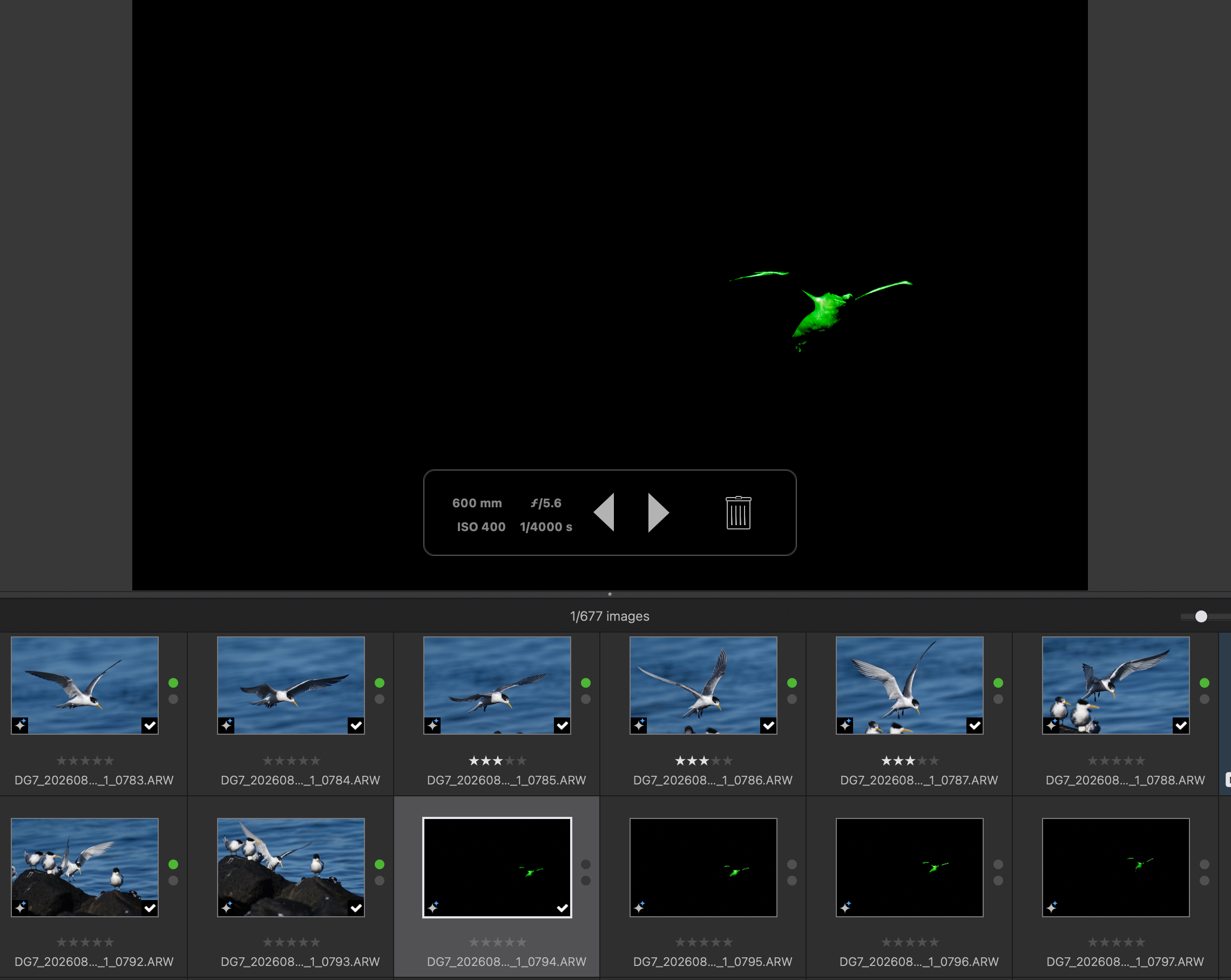

Just released but there seems to be a problem with the support for Compressed RAW files. Compressed HQ seems fine.
Anyone NOT having problems with Compressed RAW files in PL10?

I have the same problem as you but in PL 9.12 black and green images

They have started to make some support, PL 9.11 wasn't able to view the image at all but with 9.12 they open but the colors are wrong

Yes both Compressed RAW and Compressed HQ are included in PL9.12 and PL10 but there is a bug with processing the Compressed RAW files.
Compressed HQ files work find on both.
I just send some sampled files to DxO - they couldn't reproduce the problem with the RAW files they have.

OK so I have found that the PL9/10 problem is with A7R6 Compressed RAW files that are taken in one of the Continuous Shooting modes - I tested H+ files and Lo files and they all fail to render properly in PL.
Using Single Shot Compressed RAW the files are processed correctly in PL.
Lossless and HQ in one of the burst modes seems to work fine.
DxO have acknowledged there is a bug with processing of HDR and NR files - and I assume these are also shot using one of the burst modes so hopefully that will fix the processing of any normal burst mode Compressed RAW files.

Compressed RAW Are they 14 bit in single shot and 12bit in high burst?
Sep 03, 2026 at 08:57 AM
biggles2002
Details
p.1 #14DxO PhotoLab 10 is out with support for A7R6 Compressed HQ and Compressed RAW
Tested my self
Compressed RAW:
* single shot = 14-bit
* continous shooting = 12-bit
So DXO can't handle the 12-bit files.

I just downloaded the demo 10.0.1 onto one basic machine (9700X and 4060) and everything from a7RVI with lossy compressor is green and black.
