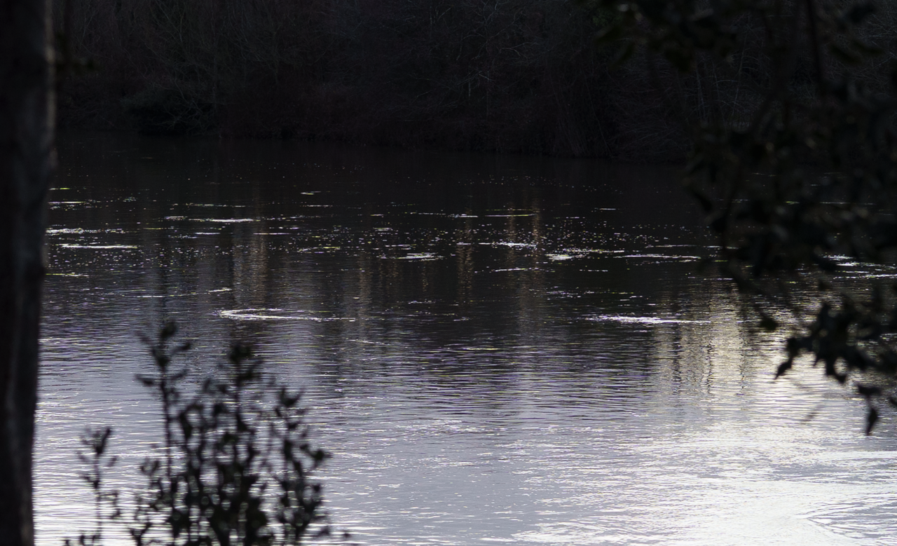

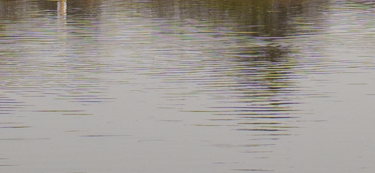

How are folks dealing with the moire?
I see it so often, across a wide range of lenses, often with water but also buildings and just appearing randomly sometimes and not insignificantly.
Using the defringe tool robs colour in other parts of the frame and still doesn't remove it entirely.
I've seen raw shots from mobile phones that also have it, but the processed JPGs from the camera will make it imperceptible.
I've found the "remove CA" option in lightroom to do almost nothing for my own shots.
It's been getting on my nerves more and moire.

Is that really moire? I wonder it is isn't a kind of CA. Moire happens when the small (= in focus) objects interfere with the sensor resolution ability. Here in this image nothing is sharp.
It was possible to remove using the Moire reduction tool in Adobe Camera Raw, quick enough but take it easy around the birds.

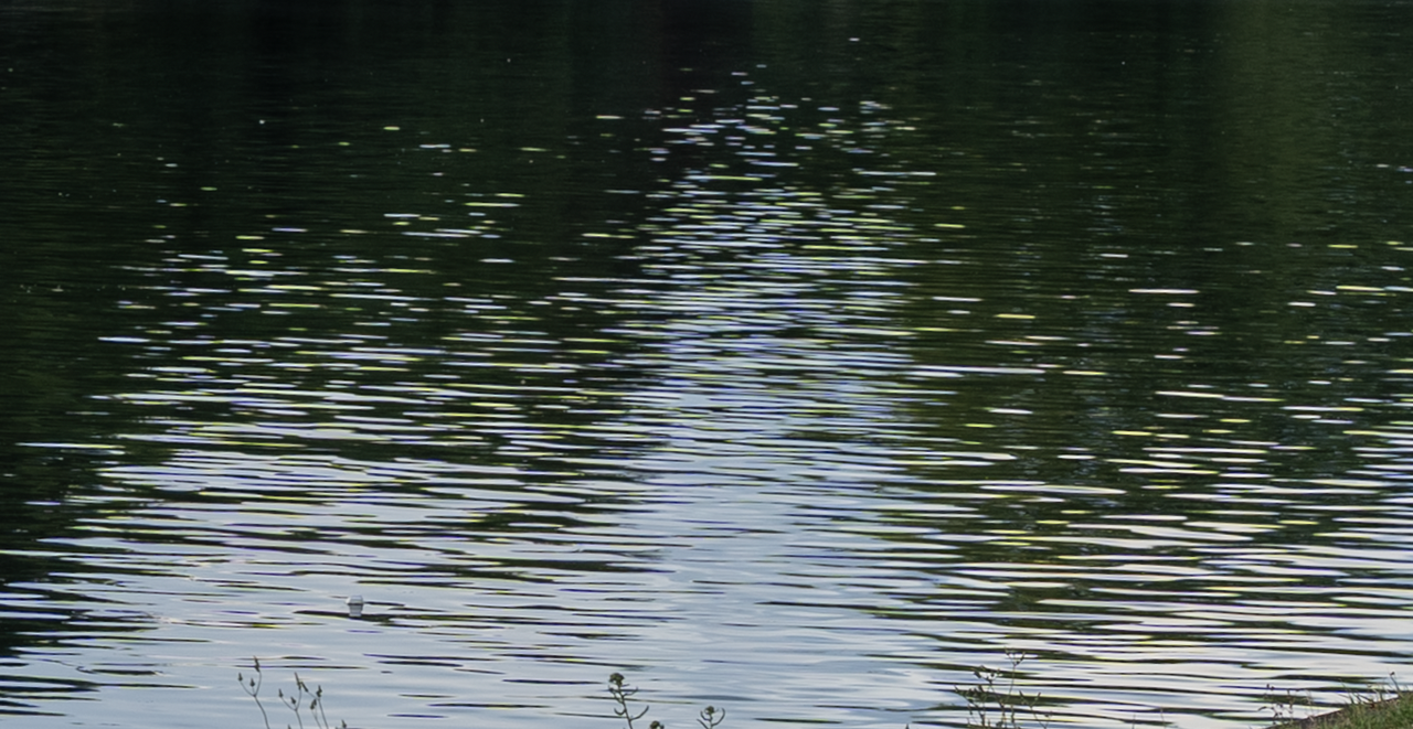

I'm not 1000% certain tbh. I do see the same thing with the APO-lanthar. When you zoom in you see it's lots of multicoloured pixels too but the yellow bands are the most common.
I know the traditional moire is like an interference pattern on clothes but I think this is a type of moire too where you see predominately yellow banding.
I tried the moire reduction tool with a brush and it does a pretty good job at the multi-coloured sections but not the yellow bands - it adds more yellow into the area instead.

I see what you mean. Well, whatever it it's ugly and disturbing. I haven't run into this problem. at least not the way it manifested itself here. With lenses giving us CA typical when shooting a fountain desaturation usually helps. In this case it may make the water look strange. The second image is dropped, right? Can you post a small version of the uncropped image?

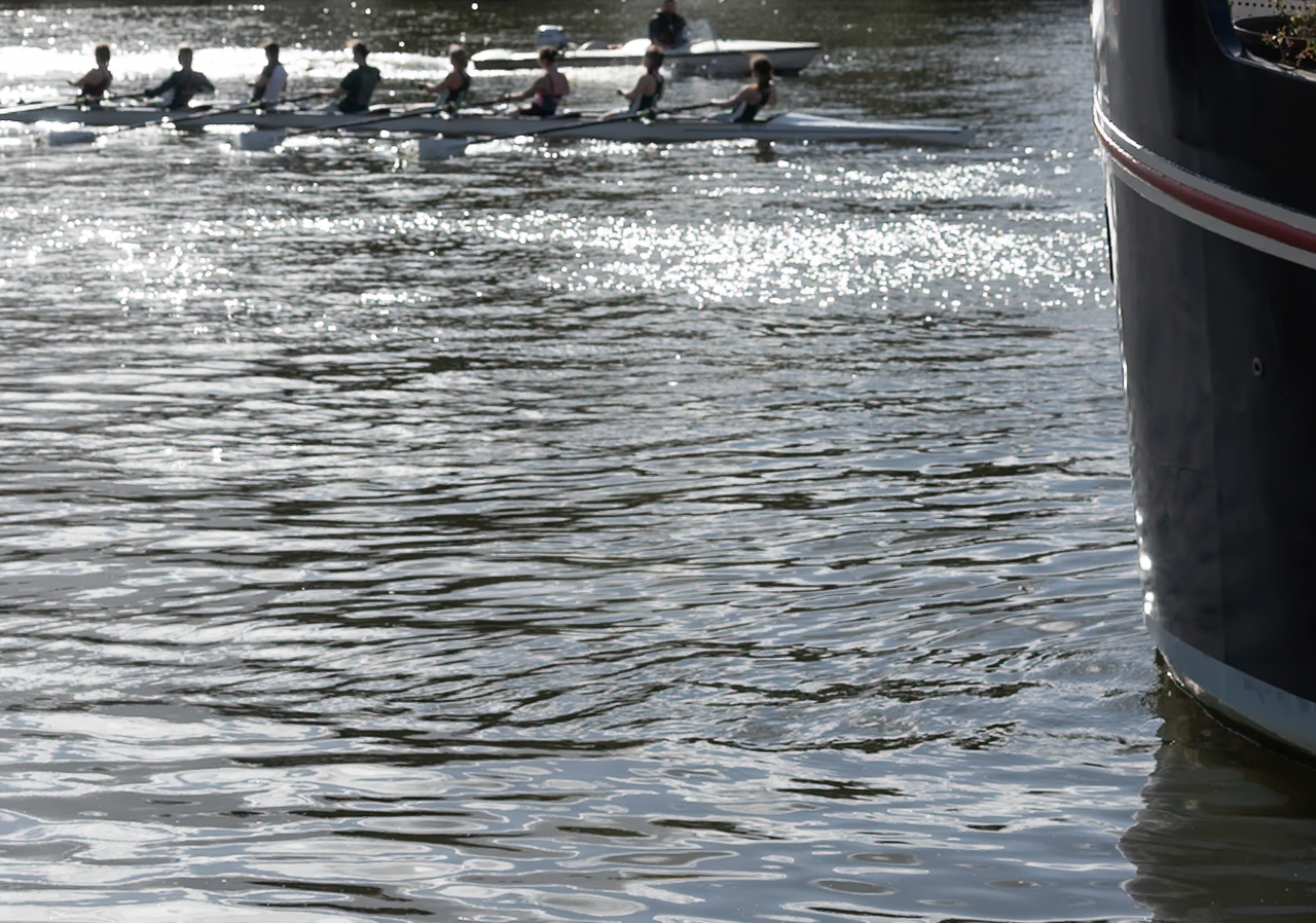

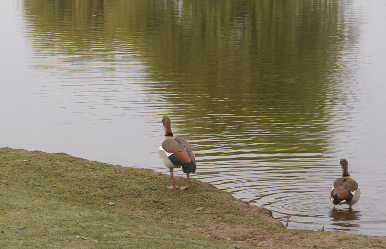

First image was a screengrab at 100% crop and this is uncropped on image 2 (small):
I can desaturate but it ruins the image a bit, defringe tool is worse because random stuff in the image gets affected.

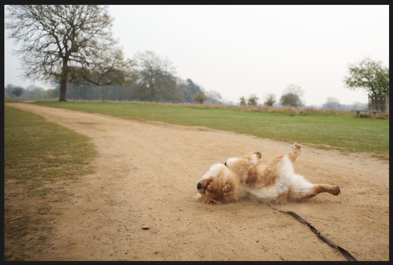

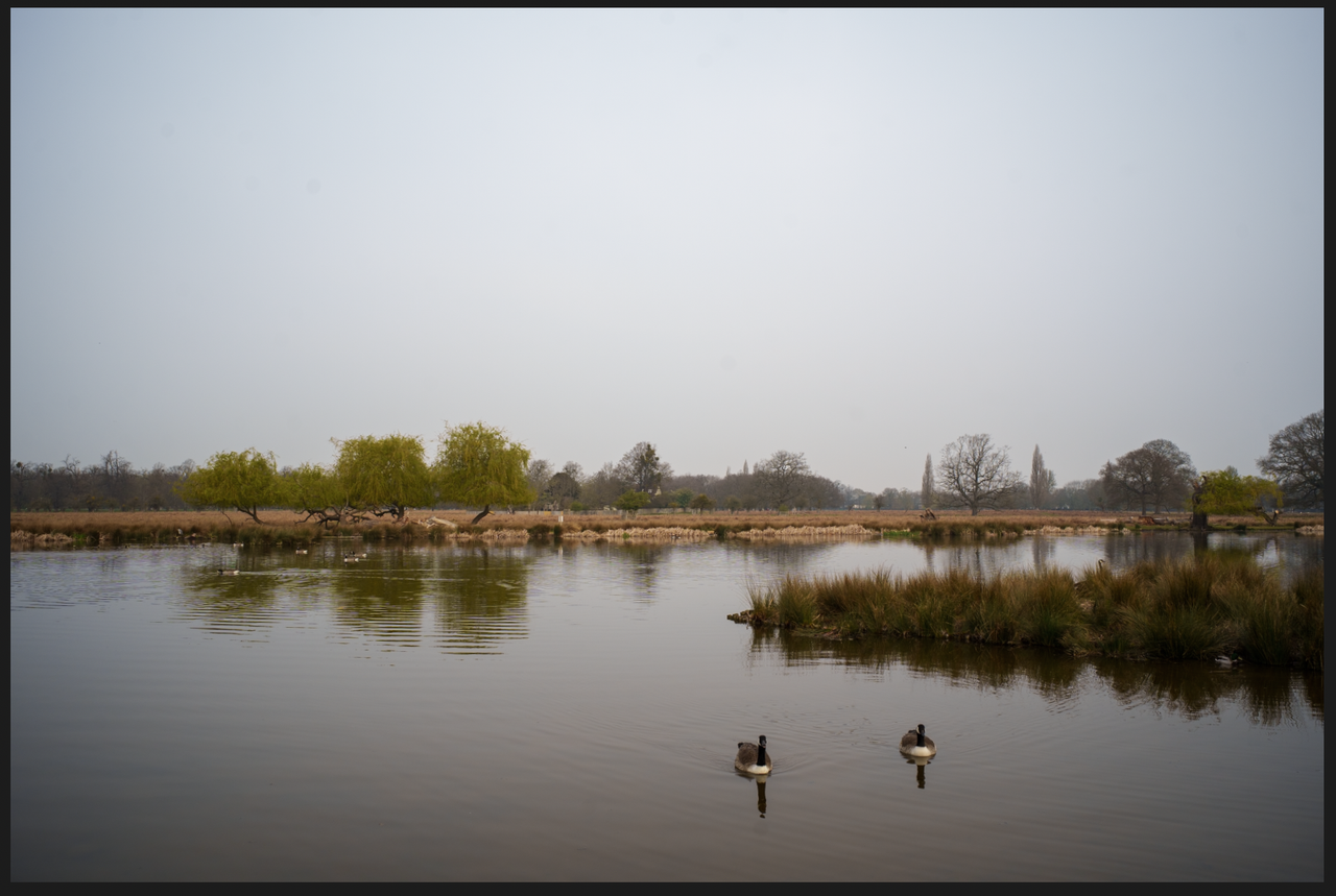

I see it often with my a7cii in lightroom, particularly with water but not all the time. 50 apo lanthar:

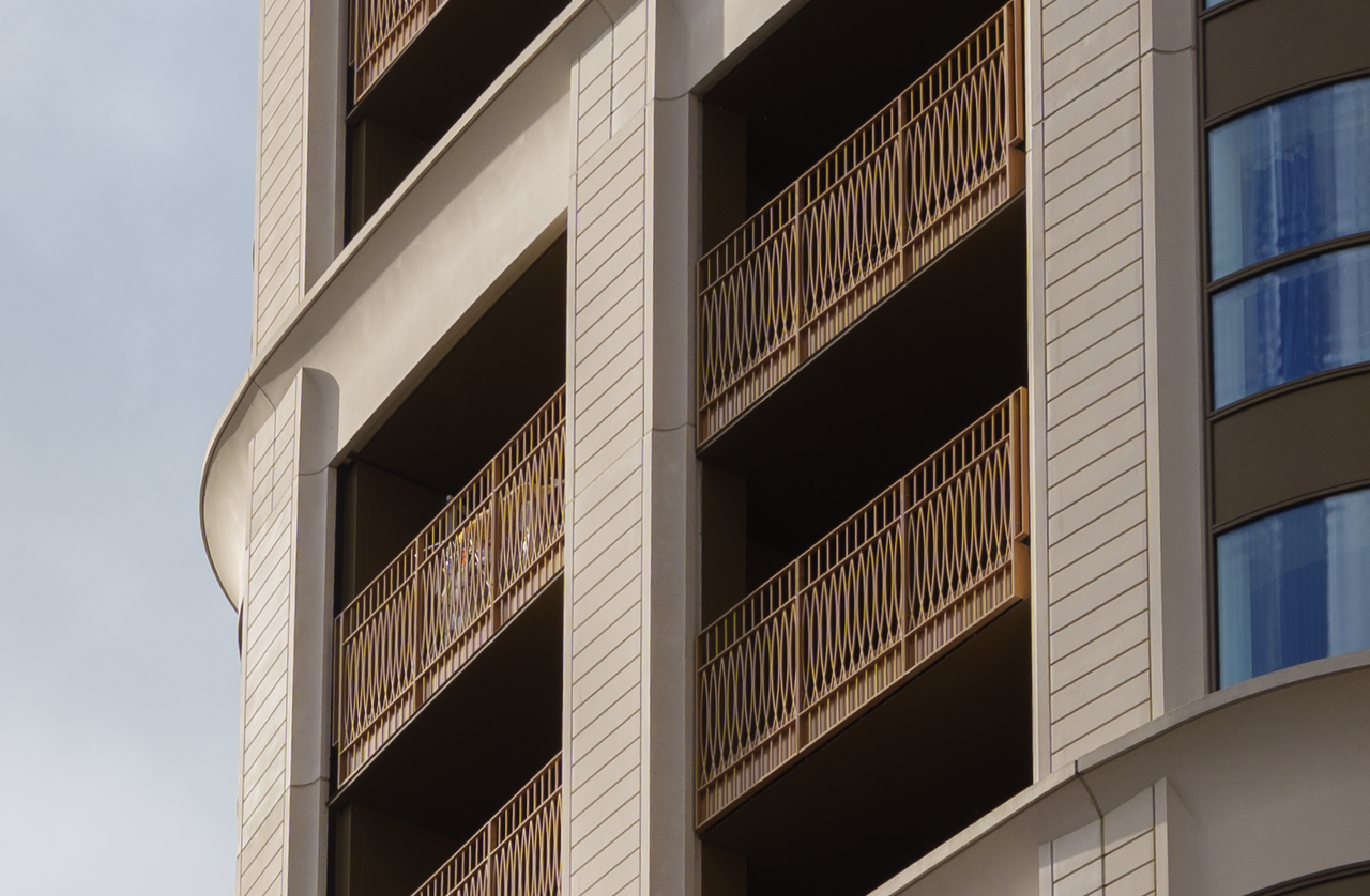

50/2 apo again, this time buildings:
using tools robs the colour

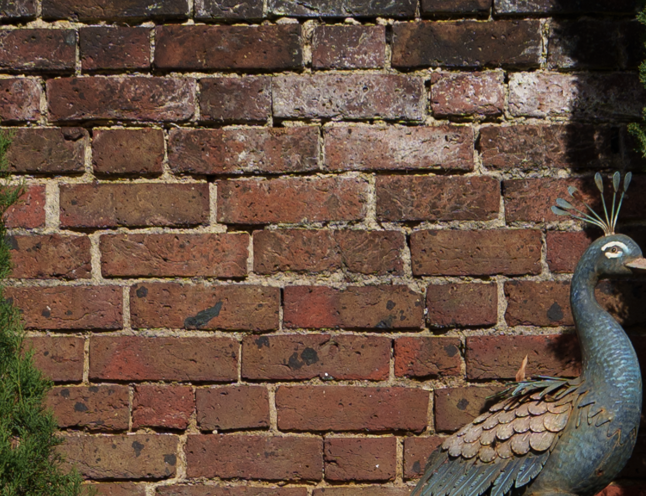

28/1.5 nokton:
I hope they re-introduce AA filters tbh. I've been considering nikon zf mostly because of this but it might not fit in the small bag I like.

OK thank you. I have no quick and simple solution. I got the best results with some tedious balancing by painting in more purple in the water and the use the moire tool and then brighten the area a little. But that's not really viable all the time, I think you really gotta love the image for such work.
The building. Very strange. No solution. Let's hope some expert teaches us something.

That is pretty strange, and I’ve never seen anything quite like it in water before.
One thought: I wonder if is is more related to CA than moire? I see it where the reflection is of what may well have been blown our or nearly blown out very bright sky against some darker tree branches and leaves, a classic cause of CA. The green/magenta colors also make me think of CA.
If it were moire, I’d think it would be more consistent a not just in the areas of reflected vegetation against sky.

I also noticed it in the higher contrast areas but I'm not sure if it rules out moire because of it, but you could be right.
I know the apochromatic lenses don't mean no CA whatsoever, but this is the 50/2 apo-lanthar again but with water at 140%:
100% crop but of a stitched image from my previous copy of the apo. I don't know how that affects the zoom level:
And the images might be scaling with viewer browser size/screen resolution, I'm not sure about that just the reported zoom level in lightroom when I screencap.

With the brick wall and the nokton 28/1.5 on the strong sunny day I noticed it actually got a little more intense as I stopped down. That together with the multicolours when you really zoom-in, I was thinking moire over CA, but not an expert.
Maybe it's the filters. I tend to use the hoya hd mk II protectors a lot (recently favouring the urth magnetic set though barely any lens cap sits nicely on it as they're so thin and I don't want to use the metal cap that's tough to get off).
I can test that when I'm back.
