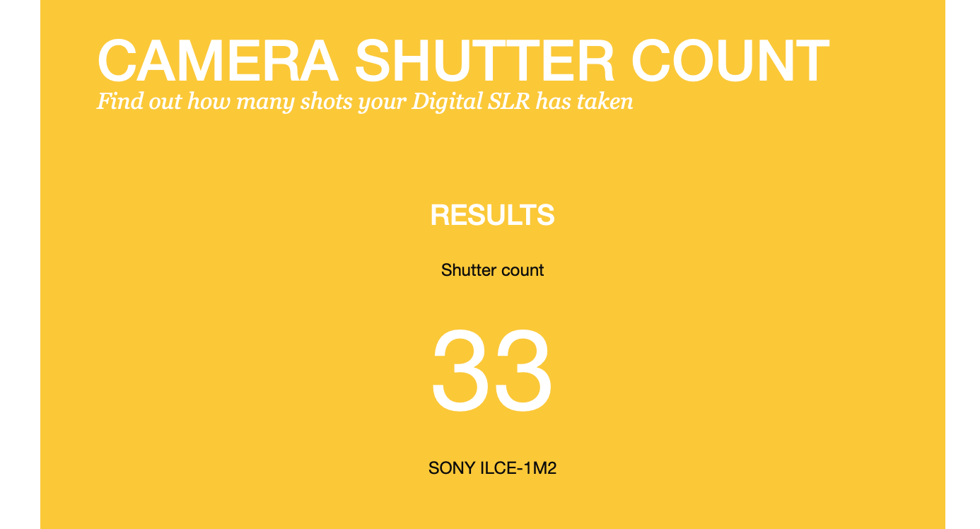

Odd, the one I linked isn't working for me either, below is from a few weeks ago. Check shutter count came back with 4.6 million clicks ! That's definitely wrong. I shot just under 800 frames total and only one short burst of exactly 10 shots were with the mech shutter. I didn't know the dust protect feature added to the count, that's probably why mine said 33 clicks.
Chris

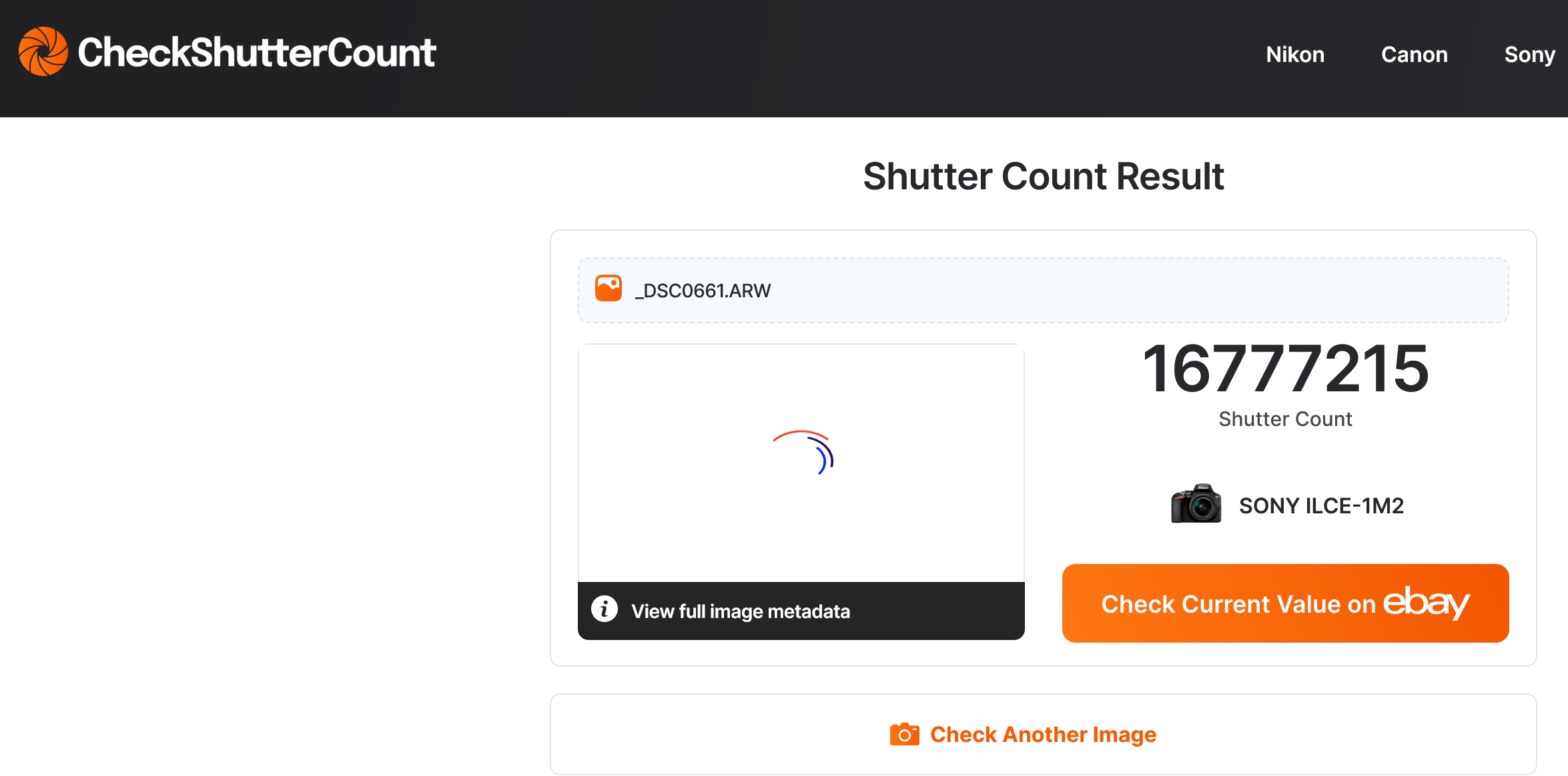

Doesn't matter what file I choose, I am getting the same number. So either the app doesn't like the RAW format or maybe firmware revision?

That looks like an error to me. It is a special binary number 2^24 - 1.
