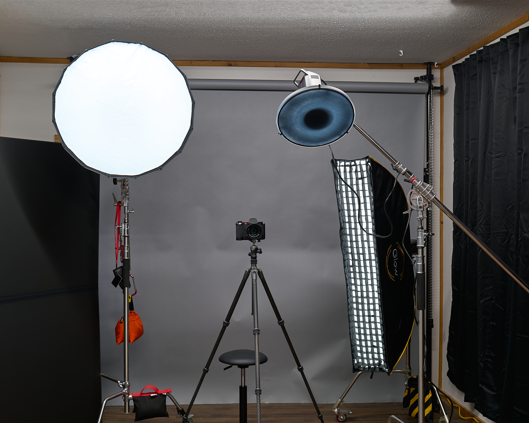

I've leased some space to set up a small studio and it's great. A few things I had to address were the paint on the long wall which I resolved by hanging black curtains, a long stretch of windows that I fixed by using a v-flat to remove unwanted reflections in peoples eyes, and unknown wall construction that I solved by using auto poles. One thing remains:
I bought a set of drive chain spindles which work great, but my 9' roll of seamless sags in the middle causing uneven roll out. I used a leader bar clamped to the leading edge, which helps, but I feel I'm missing something. Any suggestions?
At this point I bough a set of non-twist "U" hangers for the super clamps and a bar that comes with attachment points for the hangers, but this solution removes the ability to simply chain the rolls out and in. I'm thinking there's a bar I need that will slide into the rolls of paper that the expansion spindles fit into, providing better support, but before I make another purchase, I'm hoping someone can share what they do to ensure the paper remains unadulterated by the sag.
Adding a photo for reference. Hard to see the sag, but you can see the crinkle in the paper.
Thanks Rico. I went ahead and ordered a cross pole that is designed to be used with the spindles. I completely missed that when I was buying what I thought I needed.
Thanks JB. I'll bet those rubber grip pads eliminate the pole from spinning without the paper, but I just bought one from Adorama. I guess I'll see how it works knowing there's a better solution available thanks to you.
The rubber grip pads are actually shelf liner you can pick up from the dollar store.
You will have to experiment with the right size liner to wedge in between the seamless inner paper core and the aluminum core tube you just bought. There has to be a bit of clearance otherwise you would never be able to insert the metal core through the seamless core. The shelf liner acts as a wedge to grip the two together so raising and lowering your seamless works with your background system. HTH.

Thanks. I went back and clicked the thumbnail and now see that. I can appreciate a vendor that shows those sort of tips to make it work. I'll pick up a roll of shelf liner to see if it works with the one I ordered from Adorama....
When I use paper, I usually attach the wider rolls to a steel angle that I placed 4" below my studio ceiling. It is just ahead of my electric powered 6 backdrop 10' wide backdrop system, also hung from the ceiling, but I have used the paper on backdrops stands with a cross bar that telescopes from about 5' to 10', or I use two C-Stands with the boom arm raised to 90 degrees and the paper between them. A medium sized "A" clamp at each end through the roller hole and arm will prevent it from unrolling. I also use more of these clamps across the bottom of the paper to hold it from curling. These Backdrop systems noted above also come with small clamps attached to Velcro strips, so you can better stabilize the paper or cloth backdrop at several levels by attaching the backdrop to the uprights of the backdrop stand.
