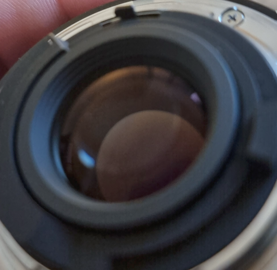

When I look at the rear of the lens glass, it looks fine. But if I tilt it a certain angle I see this:
I'm not sure if it's glue separation, or just how it is but thought to mention it.

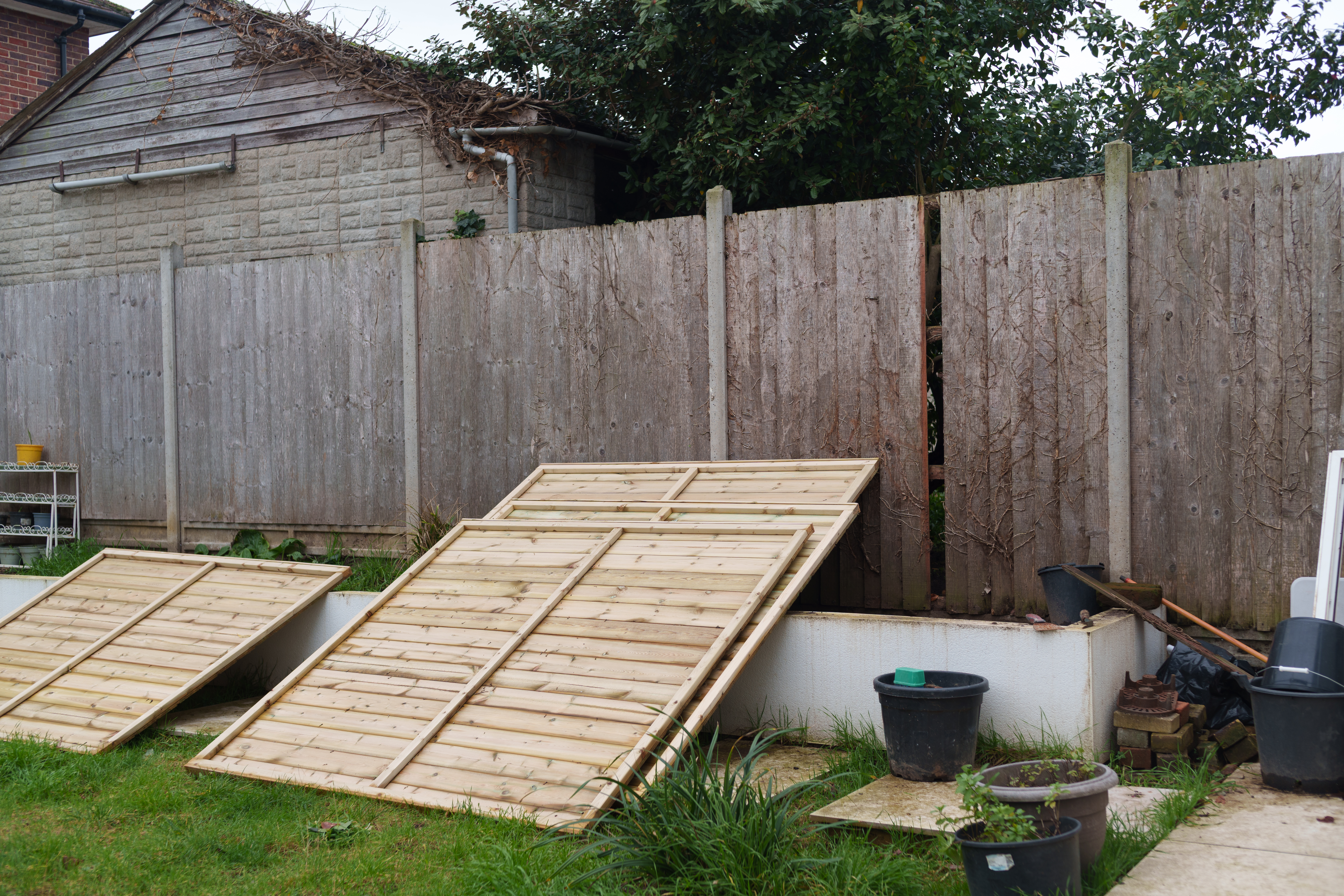

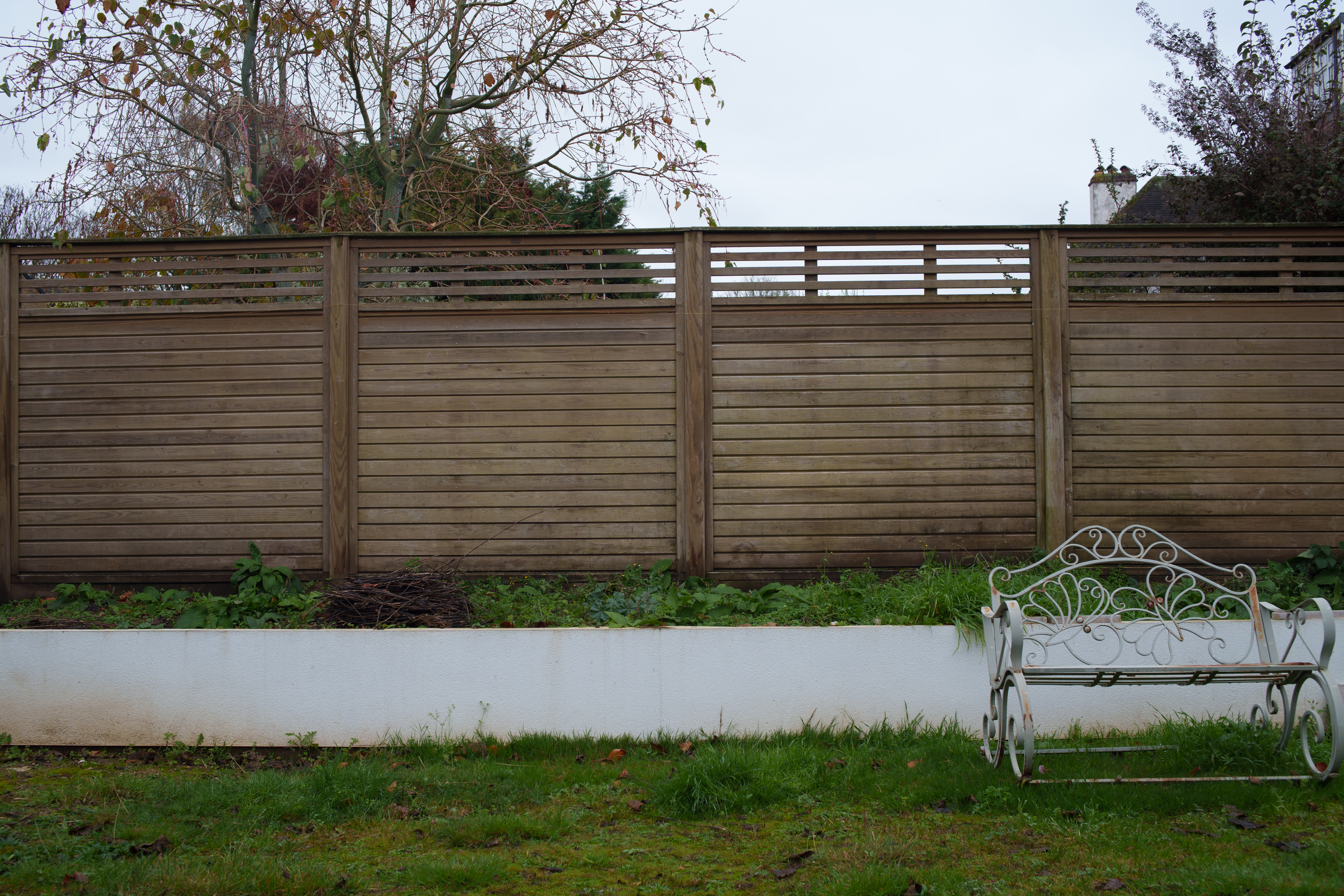

f8:
^ safe to ignore the contrast differences on the fence sides

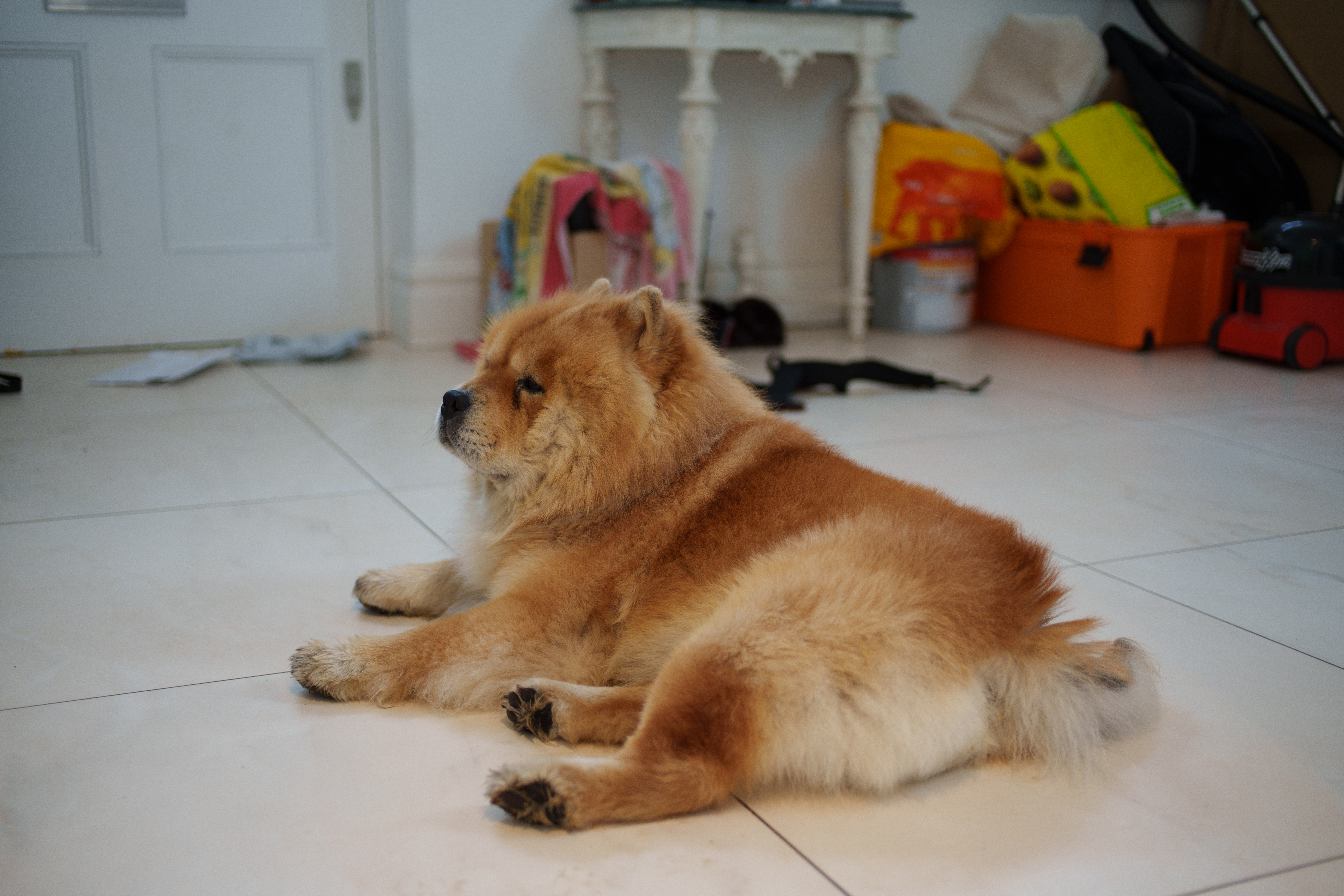

f2.8:
f2:
^ Last two shots I don't see the issue with as much, especially the doggo one, but I have wide open portraits where you can see the cruddyness/lack of transparency easily so I don't think it's the aperture... though they were both taken outside - and unfortunately no permission to share with those.

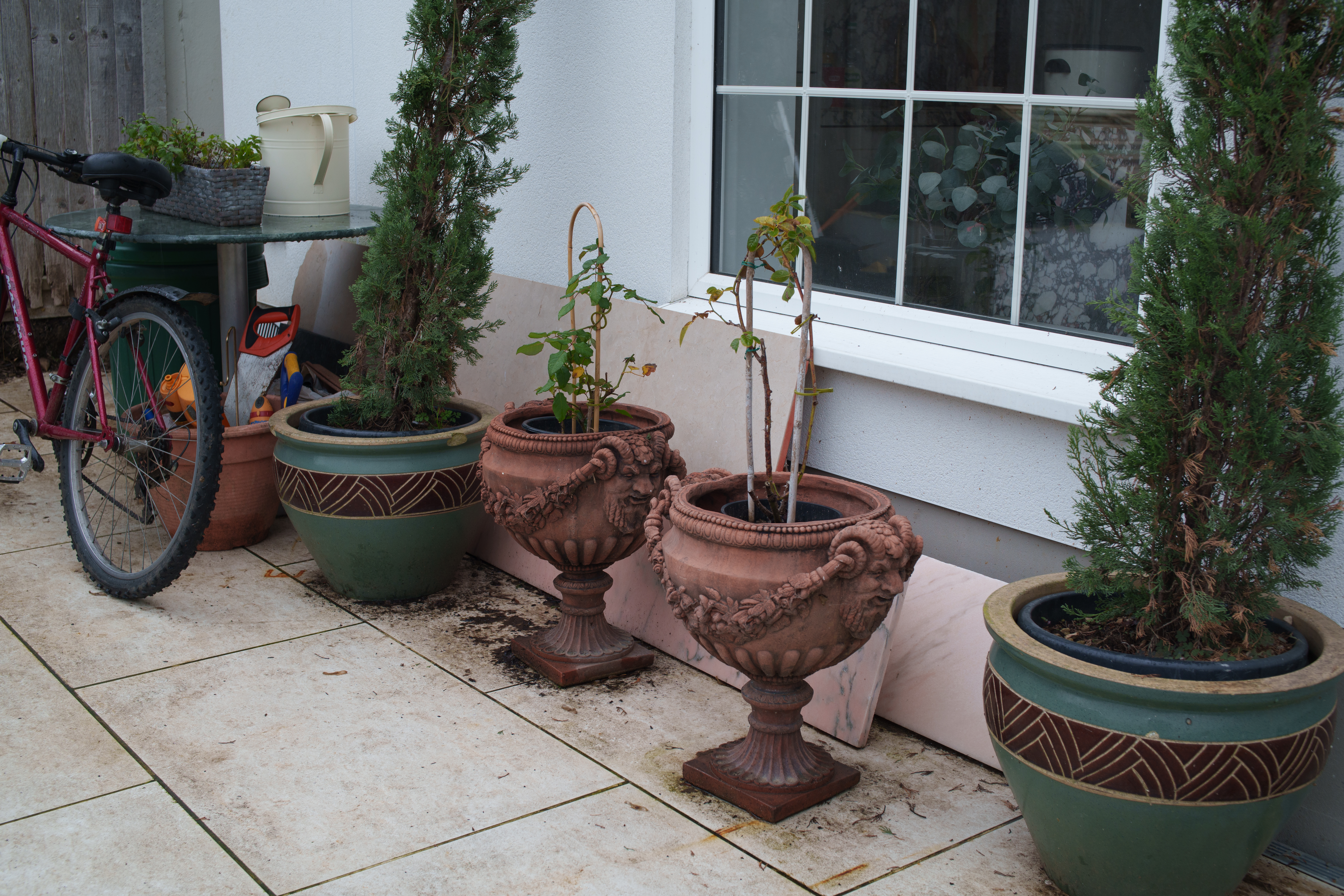

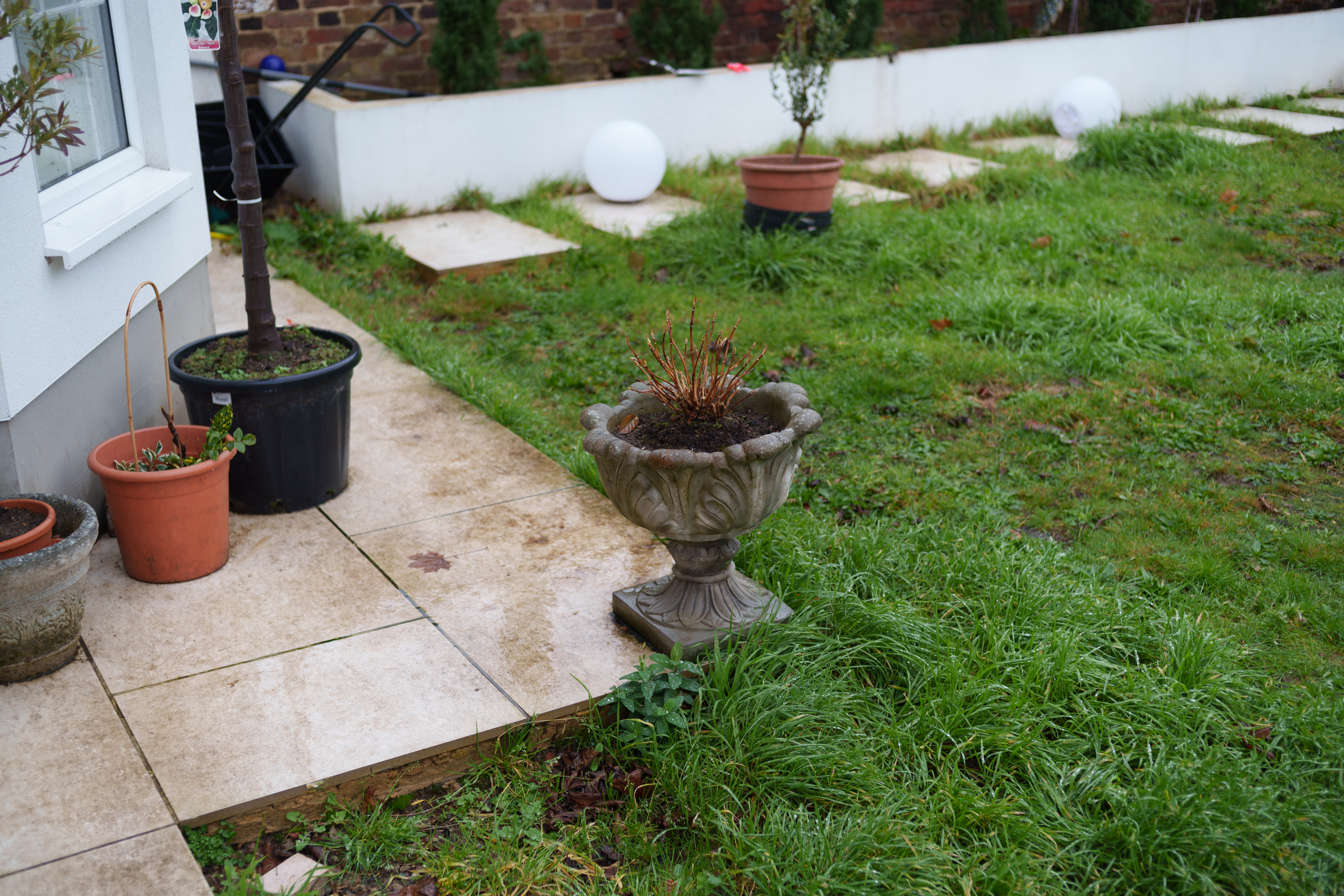

I compared it side-by-side with the CV 40mm f1.2 nokton (e-mount) to rule out the light, and when I white balanced on the same point, it did reduce the yellow tint on the ultron by 50 and give it +5 magenta which may have helped somewhat.
Both comparisons below are at f4, white balanced on the same point, and lens corrections on.
↓ Nokton
- focus is on the middle fence post
↓ Ultron
With the fence scene, the focus is on the middle post. When you look at the branches going up on the garage roof behind it, you can see how much sharper it is on the nokton. And it's the same on the other side. I know it's not in the plane of focus but on the nokton it's sharper both infront and behind so it's not field curvature either, I think? It's like astigmatism?
↓ Nokton
- focus is on the plant pots.
↓ Ultron
Notice the dirt in front of the front-most brown plant pot on the floor and how much more grimey it is on the ultron.
The hanging lantern just above the front plants compared to how it appears more unsettling with the ultron image.

I’m not sure what you mean by Transparancy, but strikes me you don’t care for the rendering of the Ultron as it has variances with oof, transition zones, contrast and micro contrast. I will say I’ve seen different rendering and DoF for similar apertures across different lens designs which might also account for some of the differences in transition zone appearance. Otherwise the old Ultron is find sharpness wise but it’s not a modern lens or design and apparently lacks some of what you hope for (but makes up for it in compactness - or not).
You’ve ruled out centering, if you shine a flashlight through it and don’t see massive haze etc then there ins’t anything wrong with the lens, it just isn’t for you (let me know what you want for it, I love them).
