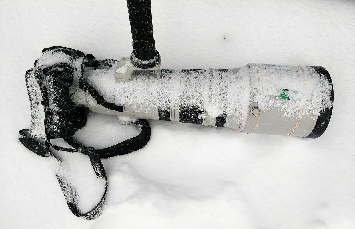

Halftime, Snow Bowl, Dec 2017, Colts vs. Bills. IDXII & 200-400:
IMO snow and ice is not nearly as bad as rain. If the equipment is cold enough for snow to gather on it, it's staying on the outside and not seeping inside. It looks bad, but it's just looks. What's probably worse is the hit on battery performance.
I also have a photo of my M240 covered in snow buildup, but don't have it conveniently online to share.
Lastly, one of the best 'innovations' in recent lens features has been fluorine lens coatings on front and/or rear elements. The above 200-400 has it and simply never had issues with water collecting on the front element in driving rain conditions. It was always a problem with lenses prior to this feature.
Yes, Roger from Lens Rentals has a love/hate relationship with the relative fragility of the fluorine coatings...
