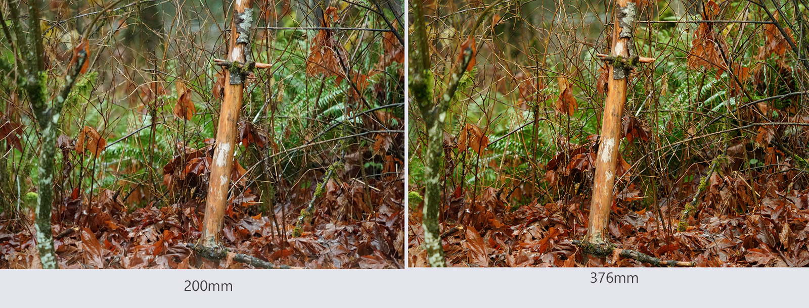

surgemaster
p.2 #4 · Sony 200-600 focus problem

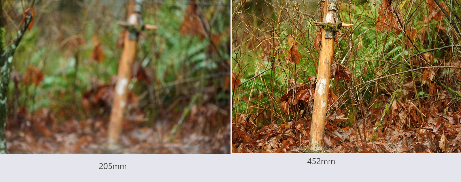

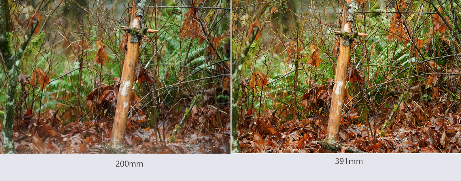

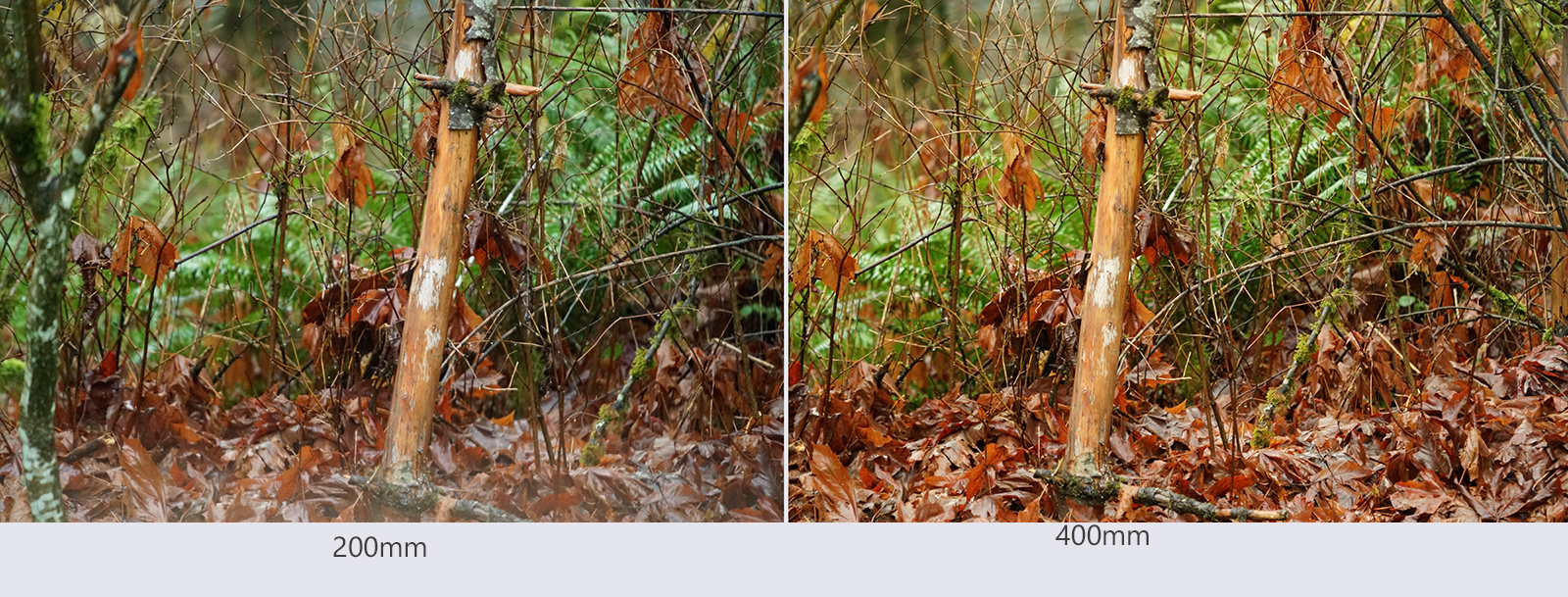

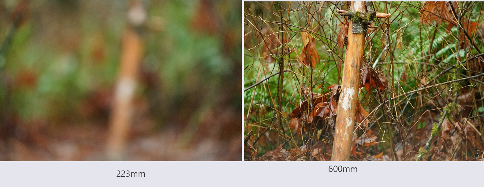

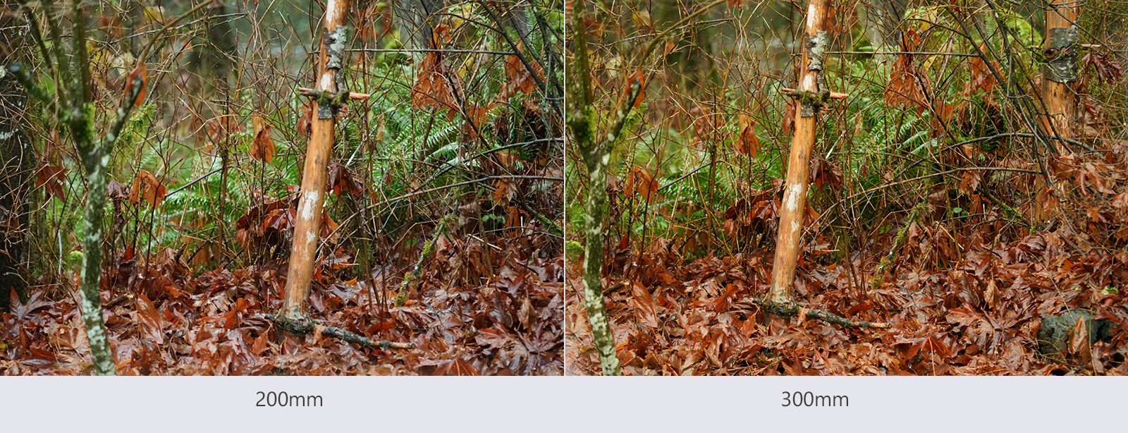

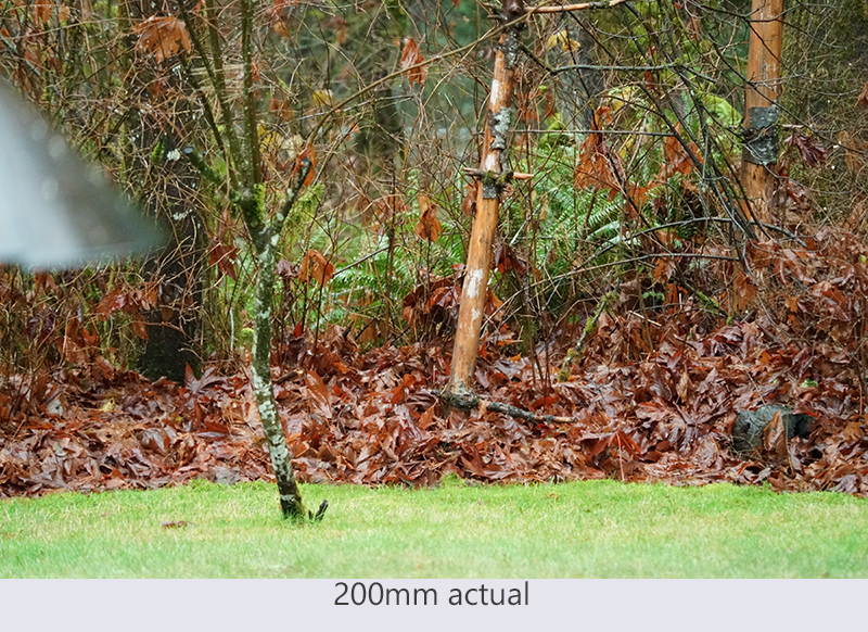

Maybe my experiment shows what Tim just posted above about the potentiometer.
The following images on the left side were taken when the camera-lens was performing incorrectly. I took incremental images from 200 mm to 600 mm. The right side images were taken when the camera-lens was working correctly. I tried to make the right side images the same size as the accompanying image. The focal lengths posted at the bottom of each image is from the exif on that image. This shows where the lens loses focus. My focus target was the snag in the middle of the frames. I used flexible spot s to focus. The left side focal lengths in the exif were incorrect except for the 1st image, which was 200 mm.

Dec 10, 2023 at 01:50 AM
