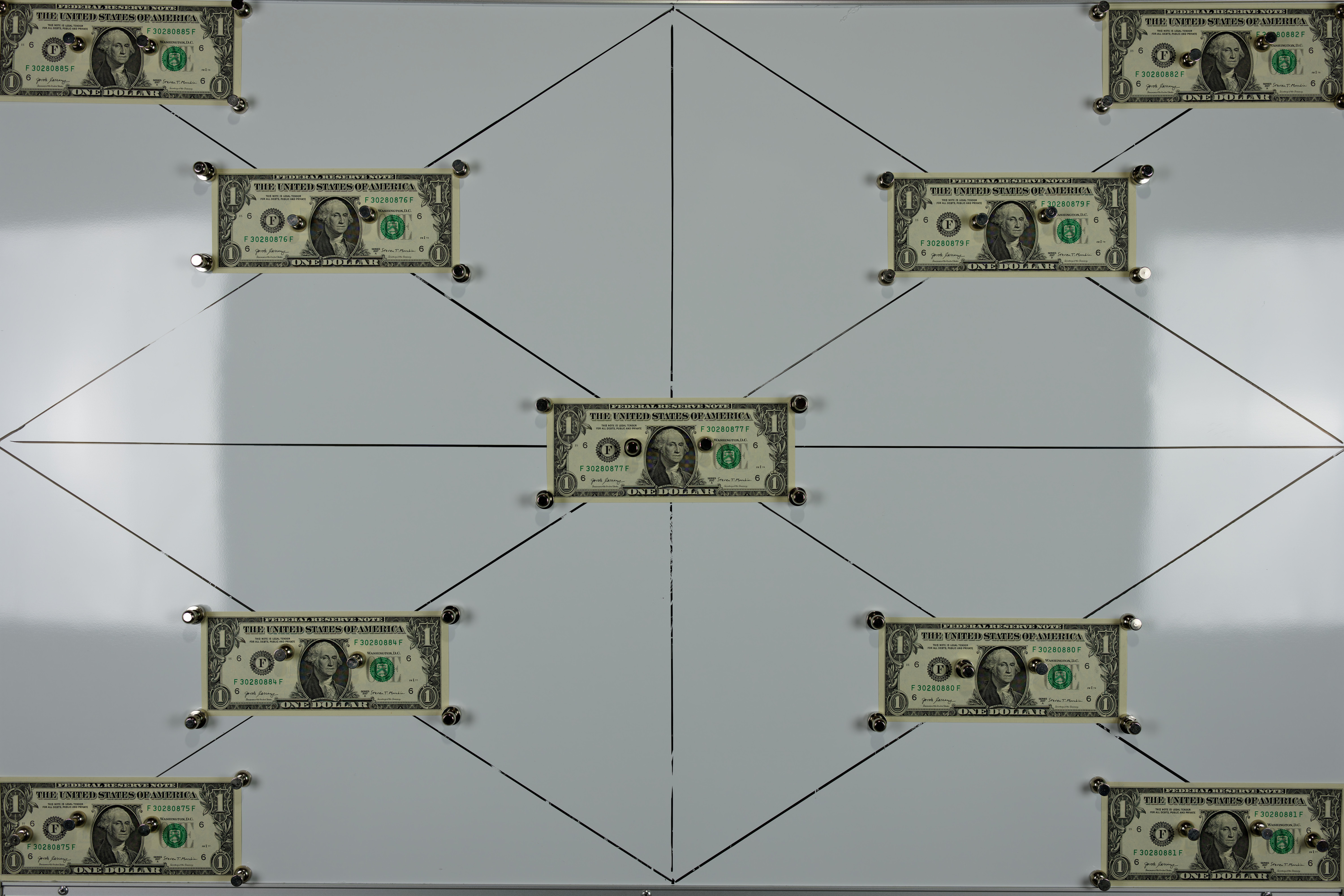

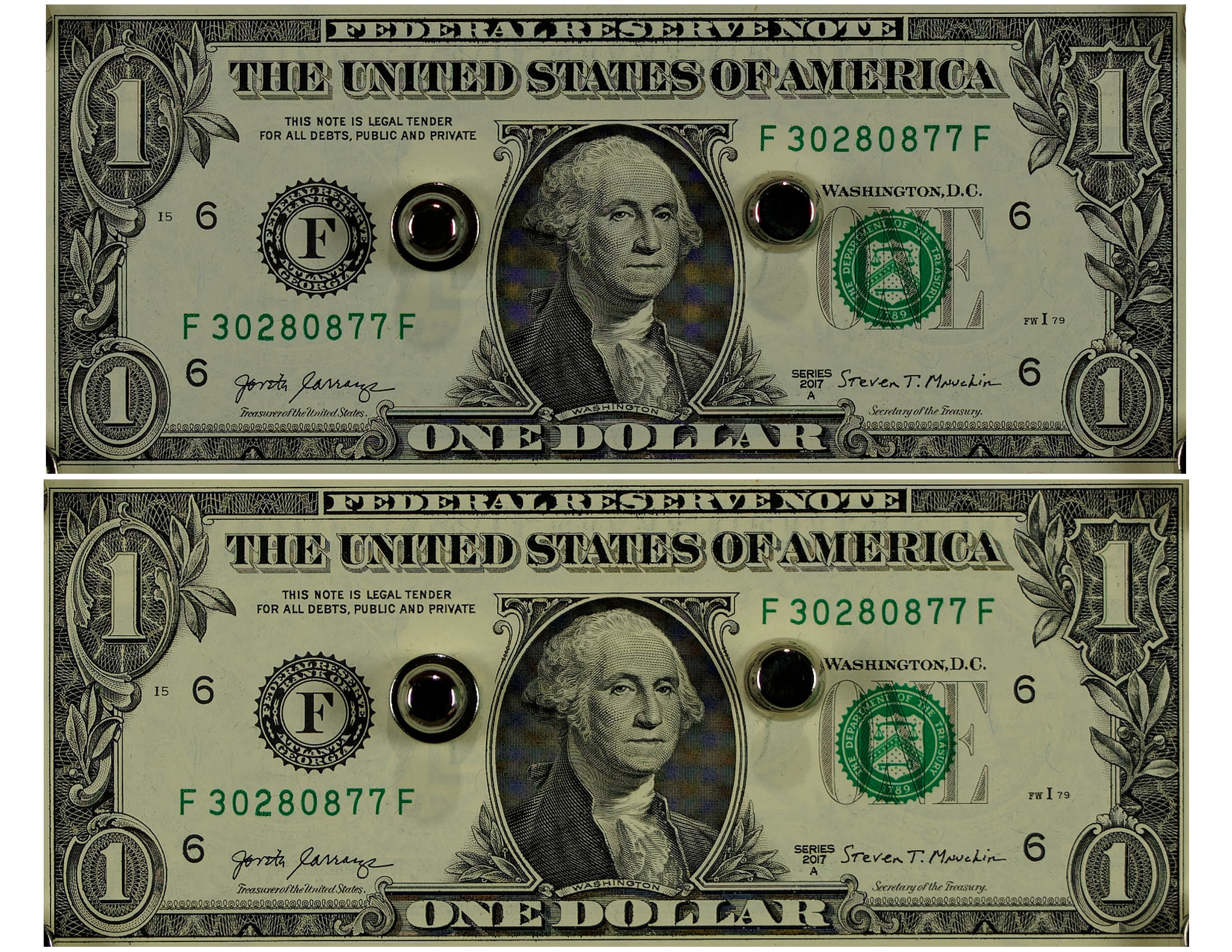

I compared my copies of the 35 GM and 35-150 lenses at F2.0, using this "nine-dollar chart" (see below).
The camera was 39" (1 m) away from the chart. At this distance, the Tamron is sharp in the center but it is softer in the mid-zone and in the corners. It would not be surprising, if the performance of these lenses should be different at longer distances from the subject. Thus, the observations reported here should be treated with caution, with the understanding that they may or may not be fully representative of the real-life behaviour of the lenses.
I don't see anything alarming. I have used the Tamron 35-150 at 35 mm F2.0. This usually happens in real low light situation, when the the corners are rarely in focus or rarely important anyways (for bokeh, it makes sense to work at 150 mm F2.8, instead of 35 F2.0).

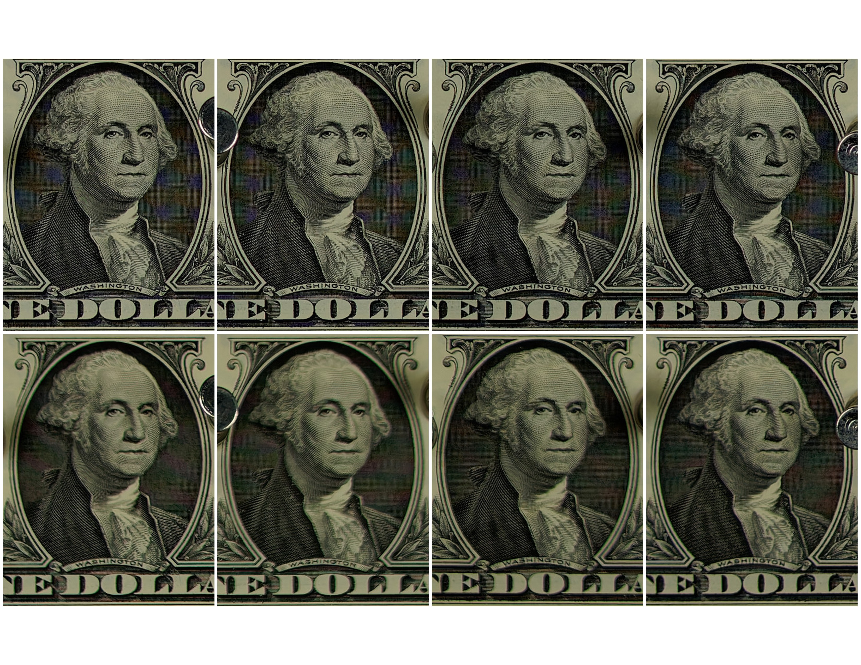

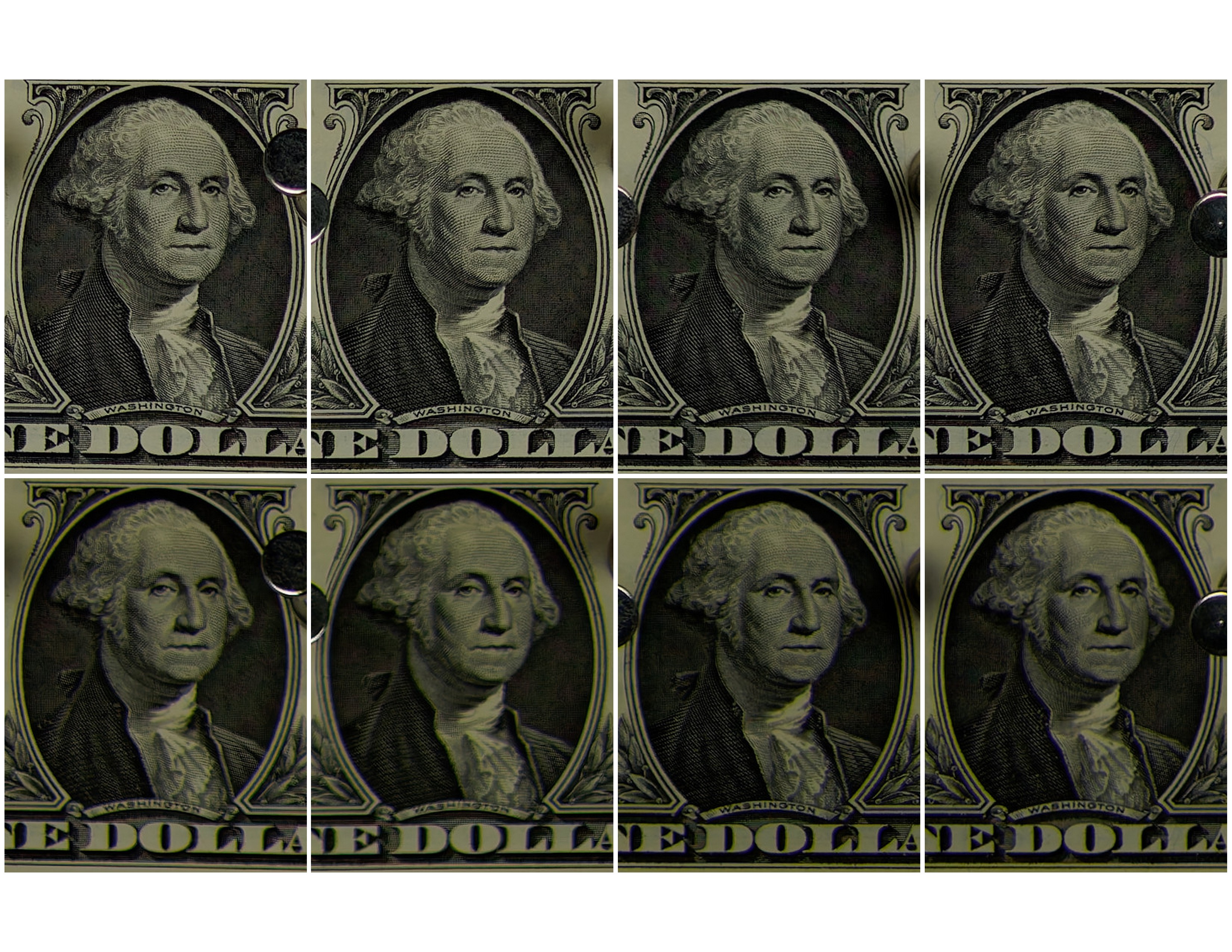

The following uploads are
1) The entire uncropped chart
2) Central crops
3) Midframe crops
4) The corners
The small crops are at about 400% magnification - this is like pixel-peeping.
The Tamron looks darker in the corners, and there is a noticeable color-cast that I know from my past testing this lens.

Sep 16, 2023 at 12:32 PM

The upper ones are better than the ones below. For the corners I don't care so much about ultimate sharpness, but the midframe is important.
I agree with you 150mm f/2.8 is better, however, if you bring a zoom like this it's because you can't shoot always at longer focal lengths.
Sep 16, 2023 at 03:25 PM
The question I am asking myself is how often the differences I see when pixel-peeping are going to be important in the pictures I take with the lenses? I believe that the answer most likely is, very rarely. I don't believe that shooting with the 35 GM instead of the Tamron at 35 mm should make my pictures better (when viewed on a 27" monitor). The choice of subject, the composition, the light, and the post processing are important, but this is like stating the obvious. When it comes to lenses, the question is not whether lens A is "better" than lens B. I believe the correct question is which of the lenses should allow me to capture the images I would like to take. There are different lenses for different uses.
Sep 17, 2023 at 03:26 PM
