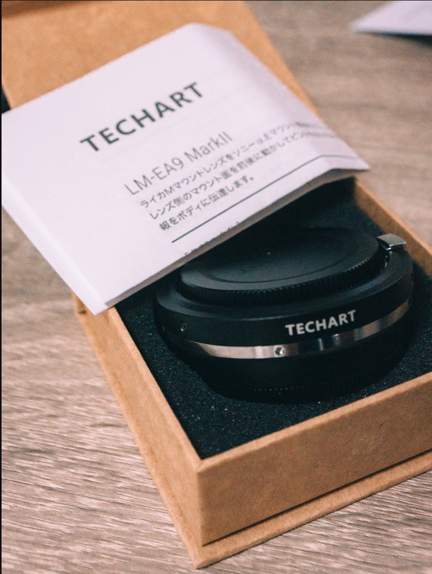

About the Techart Pro LM-EA9 adapter
It's now available for pre-order at B&H Photo for $399.

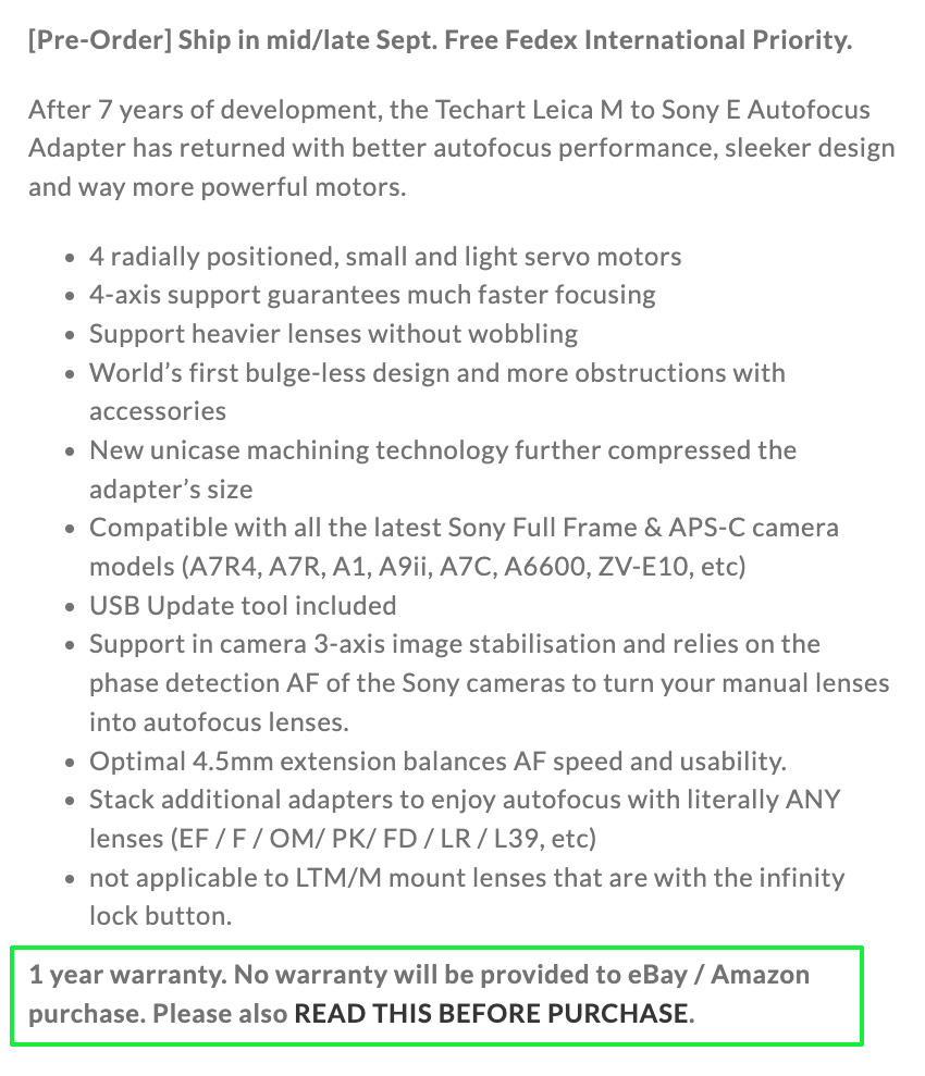

After 7 years of development, Techart officially released the new LM-EA9 adapter.
It's the company second generation Leica M-mount to Sony E-mount adapter, and it's capable of autofocus while reducing minimal focus distance for M-mount lenses.
Main Features:
  1. Allows Auto-Focus when using a Leica M Lens on a Sony E-Mount body.
  2. Compatible with older and all latest Sony Full Frame & APS-C camera models.
  3. 4 radially positioned, small, quiet and light servo motors.
  4. Reliable USB Dock firmware update.
  5. Shifts Lens up to 4.5mm for autofocus.
  6. Supports heavier lenses without wobbling.
  7. Compatible with PDAF with AF-S (contrast detect) & AF-C (phase detect) modes.
  8. Shortens lens minimal focus distance (MFD).
  9. Stack additional adapters to enjoy autofocus with literally ANY lenses (EF / F / OM/ PK/ FD / LR / L39, etc).
  10. Compatible with 3-Axis Stabilization (pitch, yaw, and roll).
  11. Drives Lenses weighing up to 500 grams on its own and heavier lenses with hand support.

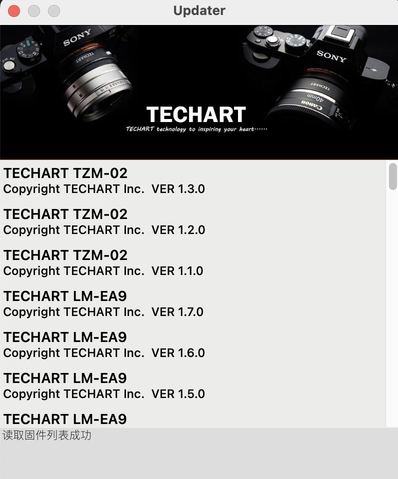

Another great feature is the set up for quick firmware updates through LM-EA9's rear cap with electronics built-in and a Micro-B USB 2.0 port -- instead of the previously cumbersome bluetooth update method.

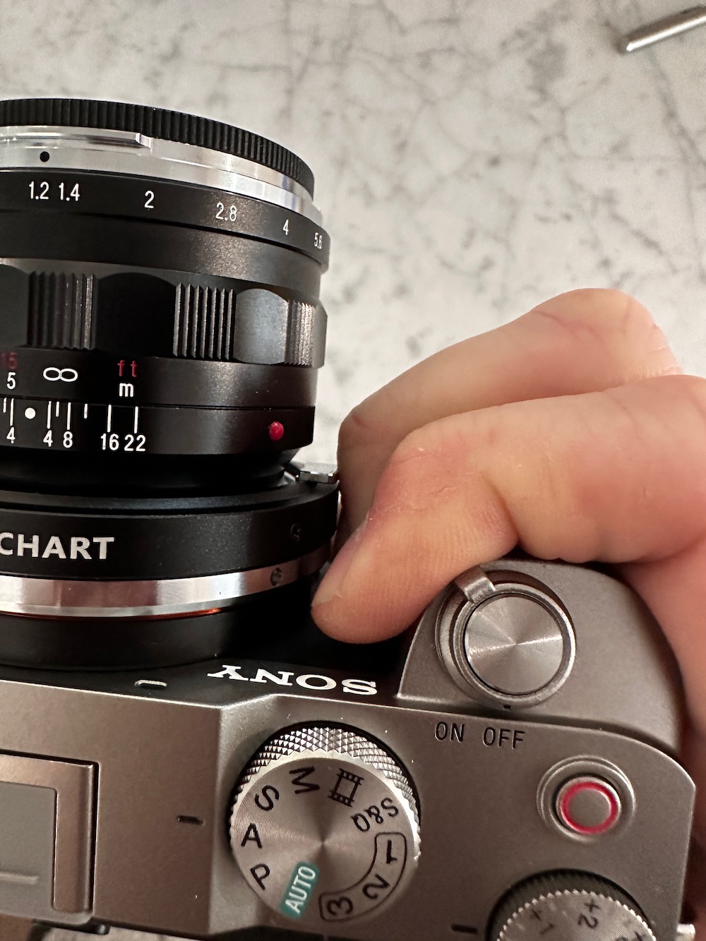

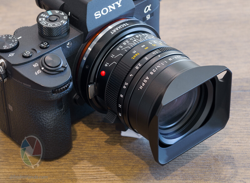

A potential issue for some shooters is that the adapter is noticeably wider than average and therefore the space between the grip and adapter is diminished. It does not affect my grip when shooting with the Sony A9 but could be an issue with other Sony bodies. Another shortcoming is the inability to set Focus mode to "MF", so this must be set as a custom button or in the case of the Sony A9 series and A1, it can be set via dial.
Sony A6100 + LM-EA9 adapter + Leica 35/1.4 Summilux v2. (Notice distance between grip and adapter is small)

> Compatible with all the latest Sony Full Frame & APS-C camera models (A7R4, A7R, A1, A9, A9II, A7C, A6100, A6600, ZV-E10, etc).
I saw this same list on TechArt's website as well and I wonder why TechArt include A7R in this list of compatible models (since it's one of the oldest models and very far from the latest) but they didn't include any standard A7 models like A7IV or A7III etc. that are some of the most popular bodies. Also since A7R4 is included but A7R3 and A7R2 are not, it would be strange to include the very first A7R.
I suppose A7R in the list is meant to be some other model instead but they made some simple mistake there...
It's good to see that my current actively used Sony bodies (A7C and A9) are both in the list of supported models anyhow. I'm not planning to get this adapter soon but might get one later on once my my camera / lens equipment budget has been recovered
...Show more
I'm not sure about support of the original A7R since it was not fully compatible with the EA7. However, I have only tested the LM-EA9 on the A9 and A6100 cameras. Perhaps it will have limited functionality when used on older bodies.
Aug 10, 2022 at 10:46 AM
MAubrey
p.1 #7 · Techart Pro LM-EA9 Review
The original A7r only had CDAF, so however well the adapter works, that body is the necessary limit on performance.

I don’t know why this is causing so much consternation. The A7R was never supported on the LA-EA7 so it’s obviously an error. Since “A7R” follows A7R4 and A74 is missing, it’s clearly meant to be A74.

I count basically all FF models (plus many APS-C) Sony have made on this page (scroll down a little): https://techartpro.com/?product=lmea9#iLightbox[product-gallery]/4

Here is the info from Techart:

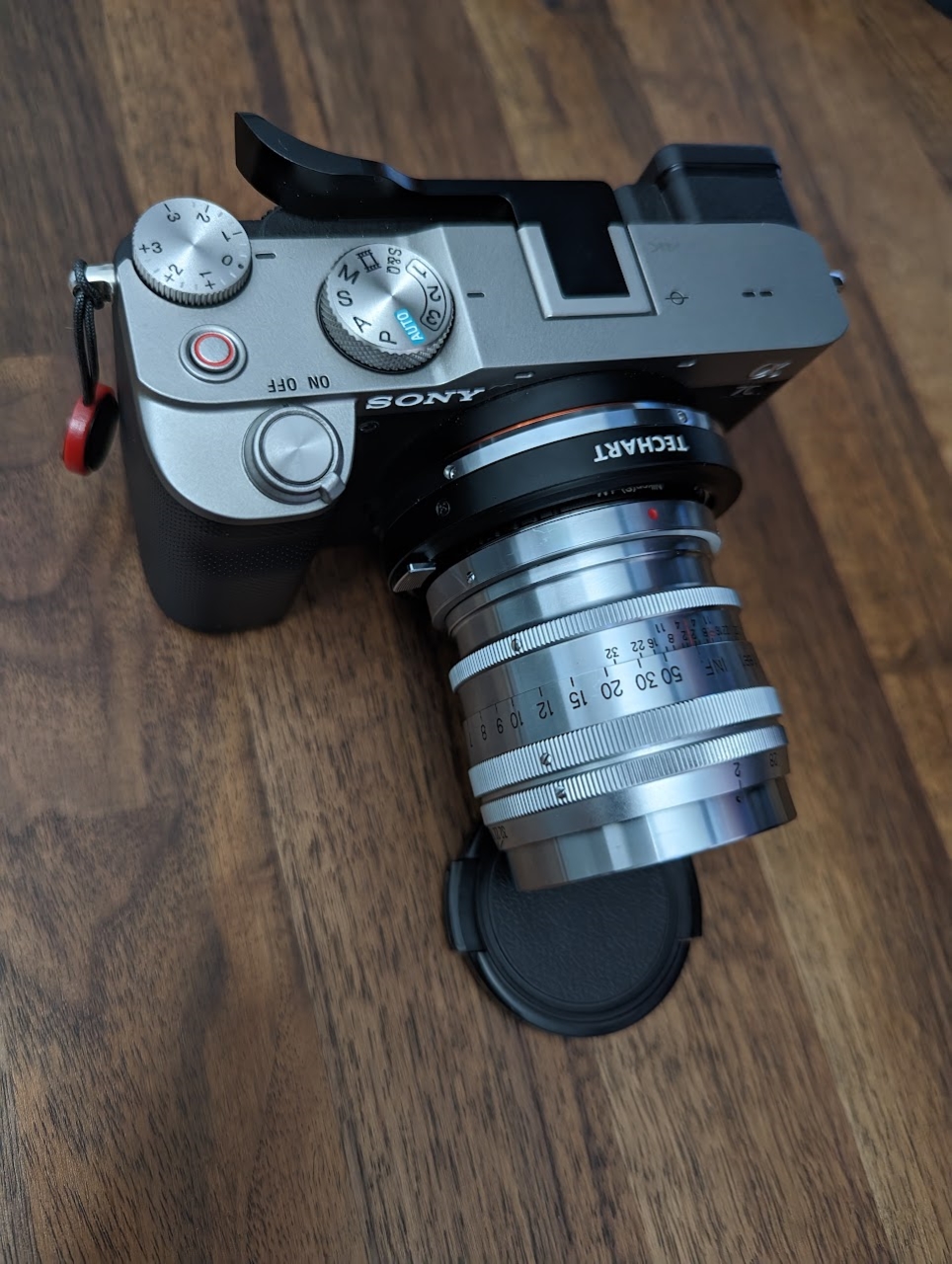

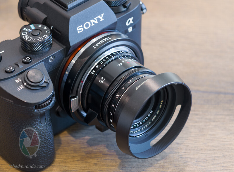

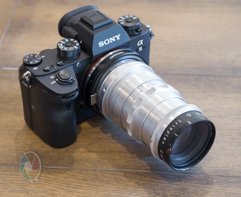

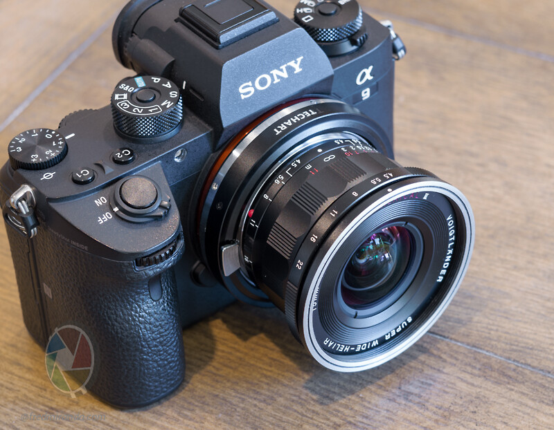

Extra images showing three other lenses I've tested on the LM-EA9 adapter:
A9 | LM-EA9 | Voigtlander 28mm f/2 Ultron II
A9 | LM-EA9 | Meyer-Optik Gorlitz Trioplan 100mm f/2.8
A9 | LM-EA9 | Leica 28mm f/1.4 Summilux
Aug 11, 2022 at 12:38 PM

Have you also tried putting another adapter on top of the new LM-EA9? For example M42-M?
I wonder how that might impact performance.
Aug 11, 2022 at 01:13 PM
Admin
p.1 #13 · Techart Pro LM-EA9 Review
Yes, in the case of the Triopan 100mm f/2.8. (It has a silver adapter on it)
It does not impact performance in any way but the adapter should be counted as extra weight.
Aug 11, 2022 at 01:39 PM
Alan Parker
p.1 #14 · Techart Pro LM-EA9 Review
I didn't even notice! Nice! Thank you for the info!

Yes, I also tested it on the Voigtlander 50/1.5 Heliar which just like the Triopan is a soft focus low contrast lens wide open. Surprisingly the LM-EA9 worked well with these two lenses.
