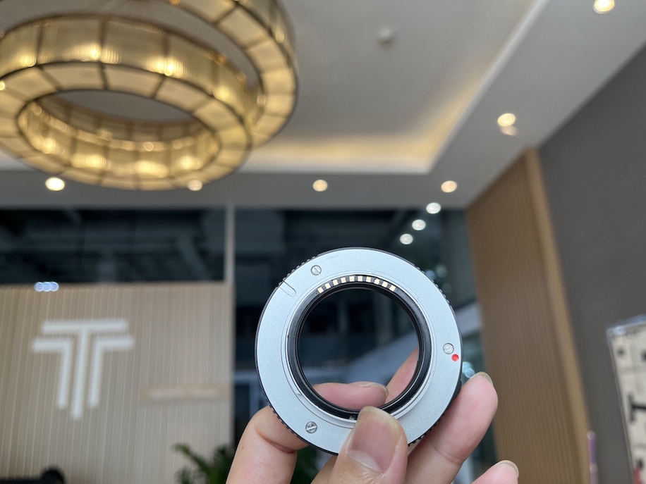

TTartisan to announce a new M-E lens adapter able to transmit 6-bit code to the camera. I'm not quite sure how it works but from the pictures, it looks like the adapter has a 6-bit code scanner and a focal length dial.
Currently this is only possible when using the Leica M to SL adapter so this could be exciting news to Sony shooters shooting with coded M-lenses.

I wonder if this infringes on any Leica patents around the 6-bit coding system? It's notable that none of the non-Chinese lens manufacturers selling M mount lenses also provide the 6-bit cutouts on the lens mounts for you to fill with paint. Both 7A M-mount lenses I own are 6-bit coded...
Maybe the dial is there for uncoded lenses? Normally the 6-bit code would provide the focal length and the dial would be redundant.

So what exactly would this add technically speaking? Focus peaking support, accurate IBIS settings and exif info?

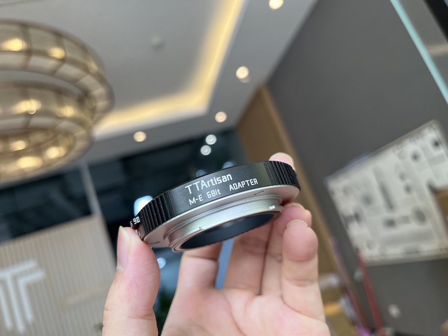

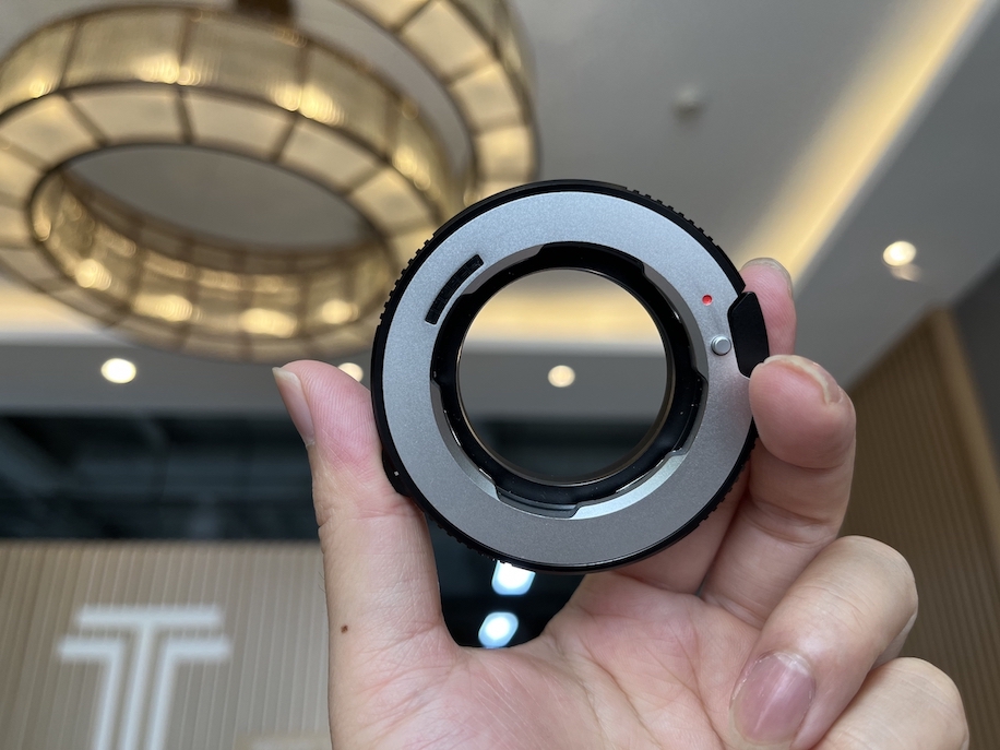

Have been using a pre production sample which didn't come with a wheel to set focal length for uncoded lenses
and also featured a narrower opening that lead to some vignetting issues with quite a few lenses.
Electronics already worked well, focal length is being passed on to IBIS.
Looking very much forward to this one.

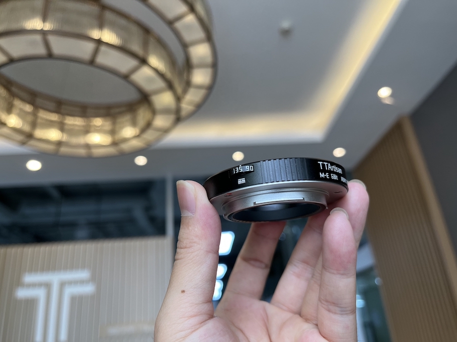

I received one of the final production models this week.
There are some minor quirks but generally it works well.
The wheel on the adapter allows one to set 28/35/50/75/90/135mm, so the typical Leica M focal lengths.
The opening is much bigger compared to the pre production sample I had, the only
lens where I still have additional vignetting is the rather obscure MS-Optics 135mm 2.4.
VM 75mm 1.5 / Leica 90mm 2.0 / SY 50mm 1.1 / MS 50mm 1.0 (which are my M-lenses with the biggest entrance pupil) all work without any issues.
I will have an article ready when it is officially released, currently just waiting on an update when that will be.

If the lens is not a focal length that is included in the options from the dial, how would the focal length be handled? Would the adapter FL value would overide manual FL value set in the IBIS settings in the camera menu?
May 07, 2022 at 11:56 AM
BastianK
Details
p.1 #11TTartisan Leica M to Sony E adapter with 6-bit code
1st priority: 6-bit code
2nd priority: wheel
So yes, whatever you set on the wheel will be passed on to the camera.
In camera you can still override that, but I can think of exactly zero cases where that would make sense
(except for some Samyang lens with a wonky firmware where the manual said you better use the override function).
