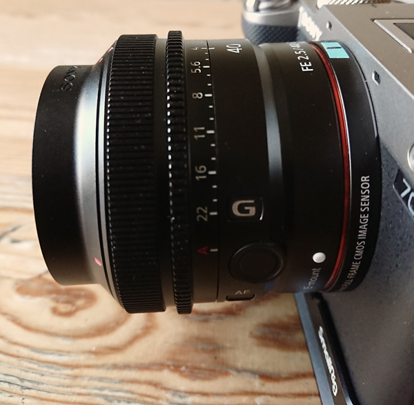

In the image above we can see some good and some not very good parts: The aperture ring is easy to find and easy to grip. The button is good. The focusing ring is abit nervous: when in MF or DMF mode the camera reacts on slight touches to the ring and the throw is also a little short. It is not as bad as the 35GM (see https://www.fredmiranda.com/forum/topic/1695162/0#15561085) but it is also not ideal for manual focusing. I wish Sony allowed for personal adjustment, a firmware thing.
Above: the AF-MF switch. Try it with gloves on... I guess the designer of this switch doesn't go outside of the cosy lab. At least I can bet that he/she doesn't take any outdoor images in the winter.

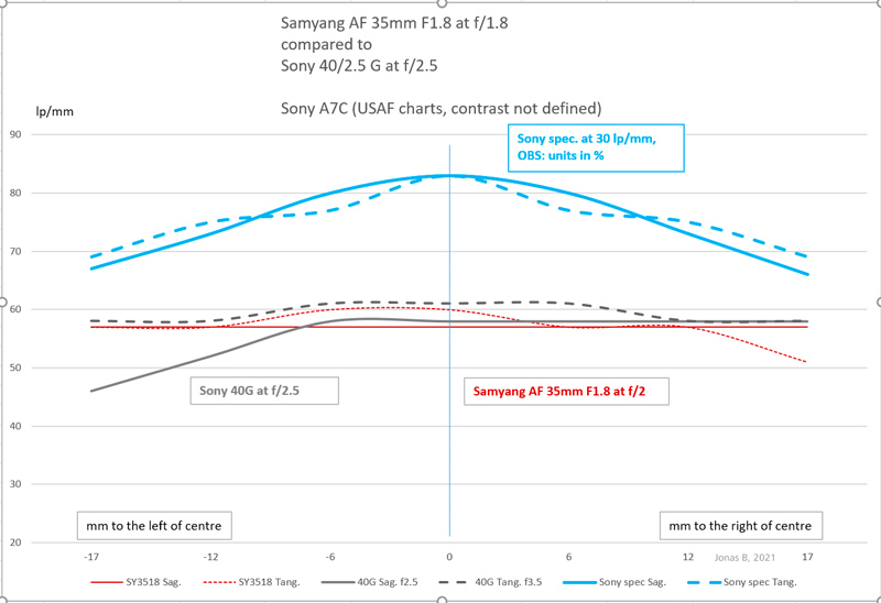

Resolution USAF Charts, short distance:
Passed. These days I just check for even sharpness from the left border to the right border. The corners are seldom of interest. I found good resolving power across the image:
The sagittal resolution drops a bit to the left, checked and checked again. This is with a small target (width 0.82m) and at a distance of 1.02m (giving us an "effective focal length of 44.5mm at this shootong distance). If interested, the method is described here: https://www.fredmiranda.com/forum/topic/1686080/18#15577758.
The drop at the left is unfortunate but small and when critical fixed by stopping down. Checking the Sony specifications also tells me I'll have no luck if complaining about it.

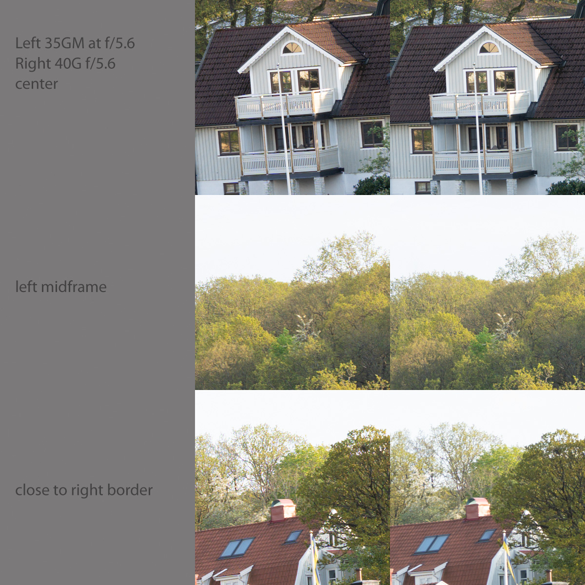

It took a while to get this section ready. I allready "knew" the result from regular use but as the weather hasn't been co-operating I haven't got anything to post until now. We haven't had a clear sky for a long time but yesterday I finally got some constant light at a part of the neighbourhood. Here goes.
My favourite target couldn't be used due to the light shifting so I picked a closer piece of the world. Here is the scene:
Above: red ring is the focus point, shooting distance is approximately 126 meters away.
For a 40mm lens that is a close neighbour to infinity. (Even if printed big, say 1x1.5 meters, having 20/20 vision and looking at that print from 1 meter the calculated DOF goes, easily, to infinity.)
Anyway, there was no tripod used but the exposure times were very short, I lean a little and didn't aim perfectly from one image to the another and so on. All that doesn't matter, we can safely evaluate these images.
I have no test charts of course so instead I used the 35GM as a reference. Not an exact method as the focal lengths are different. I downsized the 40G images to achieve the same magnification and the result was practically the same for the two lenses.
Here we have the two images with the 40G (downsized and rotated) on top of the 35GM. Just to show the difference in focal lengths and how much of the scene the lenses covered:
Here the 40G image is still downsized, the 35GM is original size and then I cropped them making it easier to compare:
It's a little stupid - you really can't compare things carefully when downsizing or fiddling around. However, to my eyes we have images from the two lenses where one of them is a miniscule bit better at one place, the other lens the same at another place. The differences are mainly due to shifting light/wind. My guess is that the 35GM would be sharper than the 40G at the borders if using a camera with higher resolution. As a "24MP and then downsize" sort of photographer this is of little interest.
A7C, handheld, IBIS on, 35GM and 40G, both at f/5.6, ISO100 and 1/80 sec.
PP: everything neutral or zero in ACR, cropped, compiled, turned, smart sharpened (41, 0.5, 0) and then converted to sRGB and 8-bit JPG-files. Exposure, contrast and so on are left un-touched.
I have looked at all the images, from f/2.5 to f/22 (f/16 for the 35GM) and the result is all the way the same as above: there are no meaningful or significant differences. Together with all the other "real life" images I think it is safe to say you can use the lens without hesitation for land- and cityscapes.

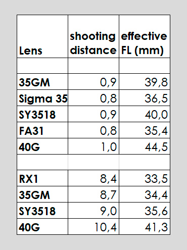

Breathing:
The focal length of 44mm at 1m raises the question about focus breathing. Or not really: the breathing immediately shows when focusing. Out of curiosity I decided to check this and got the following results:
I hope i got that right. Also see the part about distortion when taking close-ups in this post.

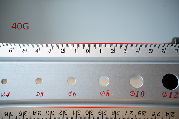

Working distance and distortion at close-ups
Here is what a ruler look like when shooting it at MFD:
and compared to this one...
...we can see similar performance. And the 35GM image is more enlarged despite its nominal shorter focal length and the 40G being at a shorter distance. That is unless I screwed something up.
Tech stuff about the ruler shots:
40G:
distance: 235mm
working distance: 160mm (hood on)
35GM:
distance: approx 250mm
working distance: approx 140mm (no hood), with my made-up hood from three step-down rings: 125mm
A7C:
raw
ACR:
There is no profile for the 40GM given yet (May 11, 2021).
The profile for the 35GM was turned off.

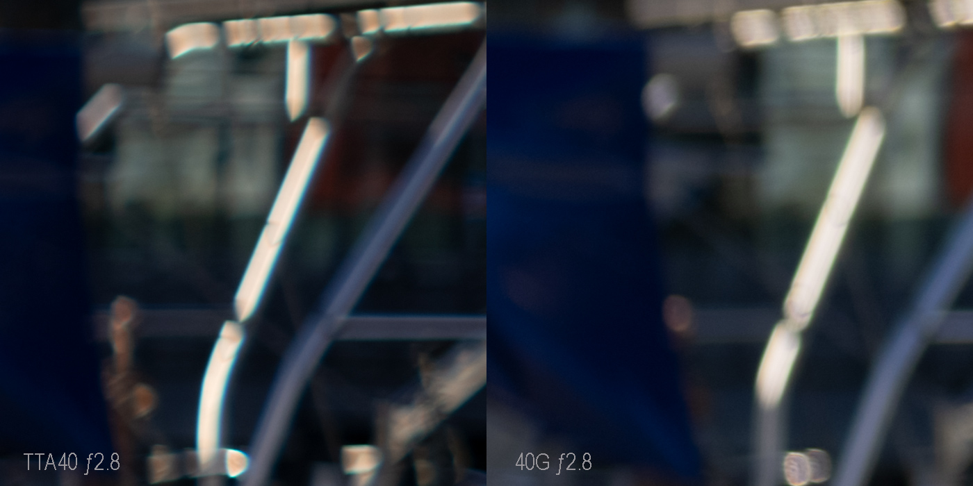

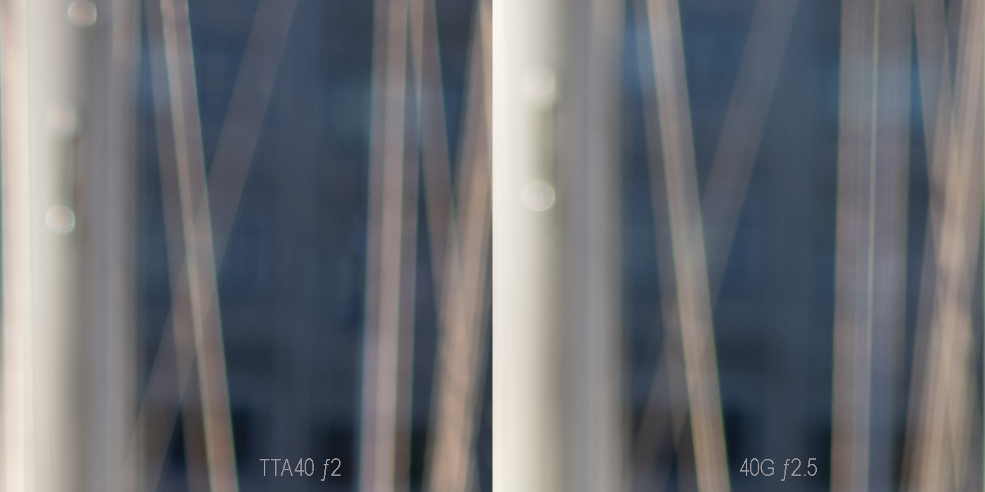

Assorted twigs - transition zone (and some bokeh):
I have tried this shot, a similar one, with the 35GM. Then I compared the 35GM with the Samyang AF35mm F1.8 lens. (Here [url=https://www.fredmiranda.com/forum/topic/1673762/79#15552707[/url]) This time I brought the 40G only so it's not a direct comparison. The images are around 700-800 kB each so I show one here only:
Above: f/2.8 at a distance of 1.5 meter (approximately for the 40G) and the aperture was set to 2.5
There are are couple more available:
1,5 meters, f/4: https://photos.imageevent.com/jonas_b/littledarling40g/Twigs_35GM_40G_f_4_1.5m.jpg
2.5 meters, f/2.8: https://photos.imageevent.com/jonas_b/littledarling40g/Twigs_35GM_40G_f_2.8_2.5m.jpg
2.5 meters, f/4: https://photos.imageevent.com/jonas_b/littledarling40g/Twigs_35GM_40G_f_4_2.5m.jpg
To my eyes the 35GM is "better". Not by much but there is a difference. That's no surprise considering what the 40G bokeh balls look like. The images aren't taken from the same spot and at different days. The light is similar but not the same. There is no PP except for adjustment of the white balance and, in the case of the 40G only, some darkening of the shadows to make the images look more similar.
Edited on May 14, 2021 at 02:44 PM · View previous versions

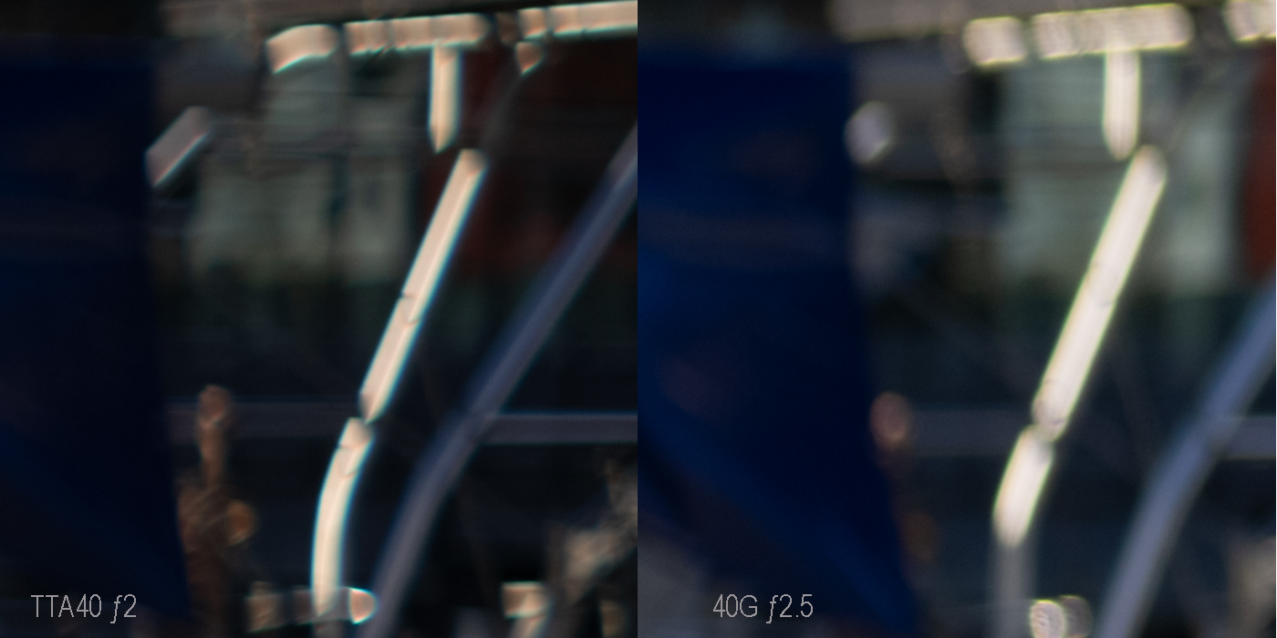

Bokeh and LoCA:
In the Eye-AF test image we can see a kind of harsh rendering when looking at the background but it is at least from double lining. or, most of the times it is.
The background can easily be a bit softer with a few seconds in post if we want. But a bokeh king, no the 40G is not that (either).
For the most of the time the LoCA isn't that bothersome:
7C, G40, f/2.5 (Btw: this is one of the very few misfocused images I got: you can't AF with the camera held vertical aiming for the for the rim of the clock at position 3 o´clock. Duh. Here the camera front focused.)
We can see some green at AFTER WORK and FIRST and then also some fringe at the roof construction. It isn't that bad though.

JVan_02
p.1 #17 · Sony FE 40/2.5 G - A little darling. Samples and opinions welcome!
@Jonas B : are you sure those effective focal lengths are correct? If they are, I clearly don't understand something about lenses as despite having the same MFD in manual focus (0.25m) the 35 GM has greater magnification. I would assume the 35 is more tele towards MFD, but it looks like from your chart that this isn't the case as the effective FL of the 40 G increases towards MFD.
Unless the 35 GM goes all the way to 50 or 55mm
May 11, 2021 at 04:12 PM
Mucho Betis
p.1 #18 · Sony FE 40/2.5 G - A little darling. Samples and opinions welcome!
Great analysis Jonas.
My wife is from Goteborg also, we travel quite often back and forth from Spain to Sverige.
In Spain lenses are much cheaper if you need something from here let me know, we’ll be there for midsomar.
Skål!
May 11, 2021 at 04:25 PM
j4nu
p.1 #19 · Sony FE 40/2.5 G - A little darling. Samples and opinions welcome!
JVan_02 wrote:
@Jonas B@ : are you sure those effective focal lengths are correct? If they are, I clearly don't understand something about lenses as despite having the same MFD in manual focus (0.25m) the 35 GM has greater magnification. I would assume the 35 is more tele towards MFD, but it looks like from your chart that this isn't the case as the effective FL of the 40 G increases towards MFD.
It's not magic, right?
According to this calculator:
https://www.kielia.de/photography/calculator/
at 0.23x magnification and 0.27m focus distance (35GM AF) you get 41mm focal length.
I always thought that's all there is to it, or am I missing sth ?
