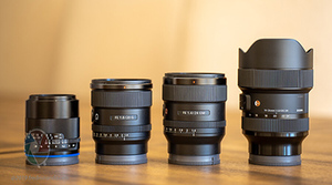

From left to right: Loxia 21/2.8, Sony 20/1.8 G, Sony 24/1.4 GM, Sigma 14-24/2.8 Art

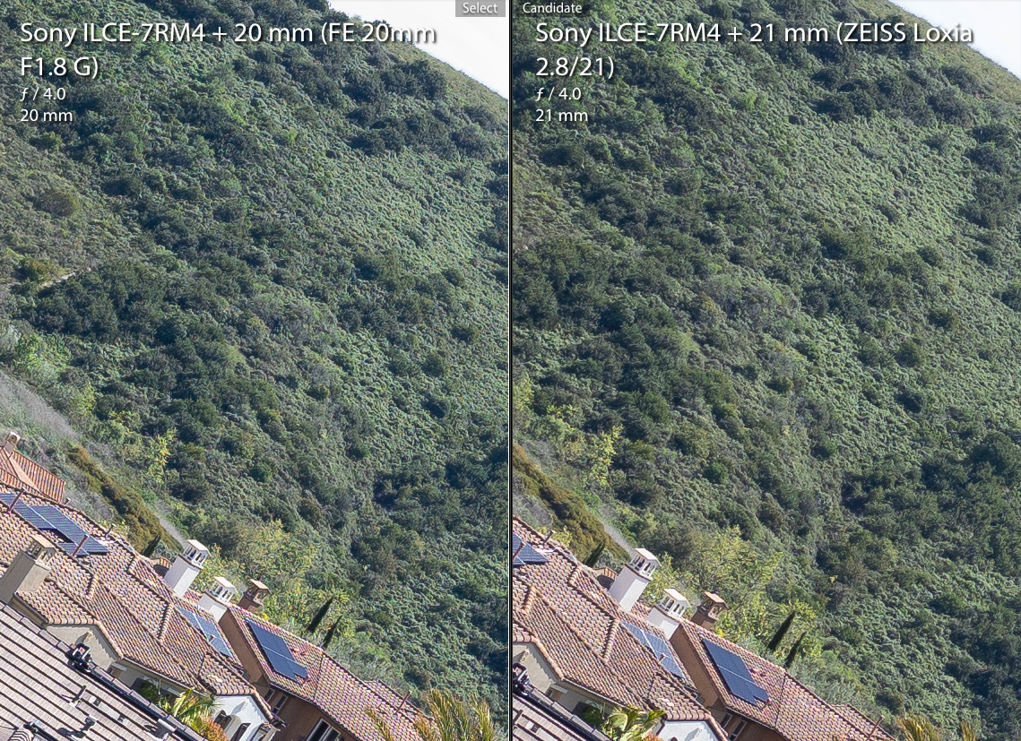

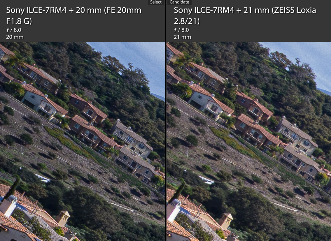

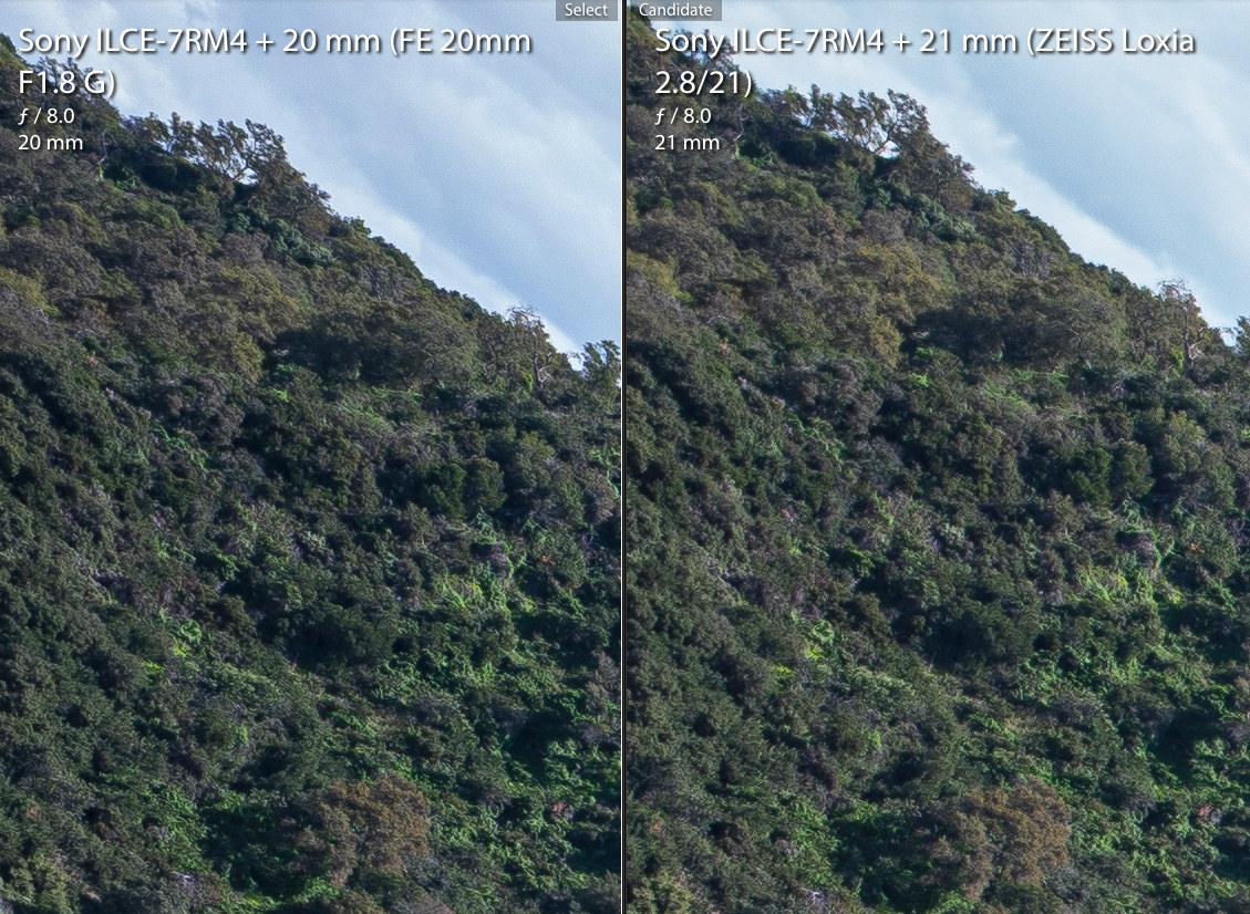

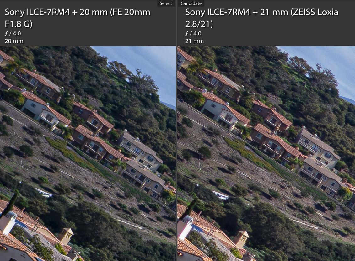

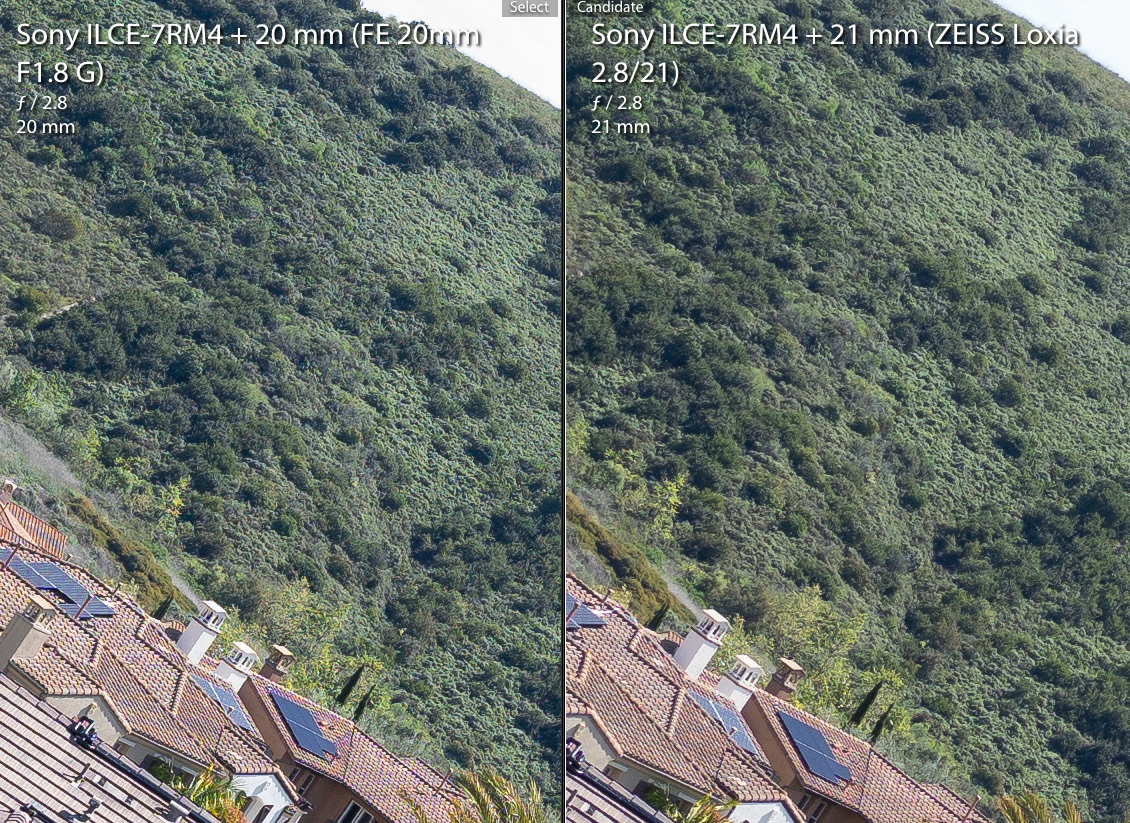

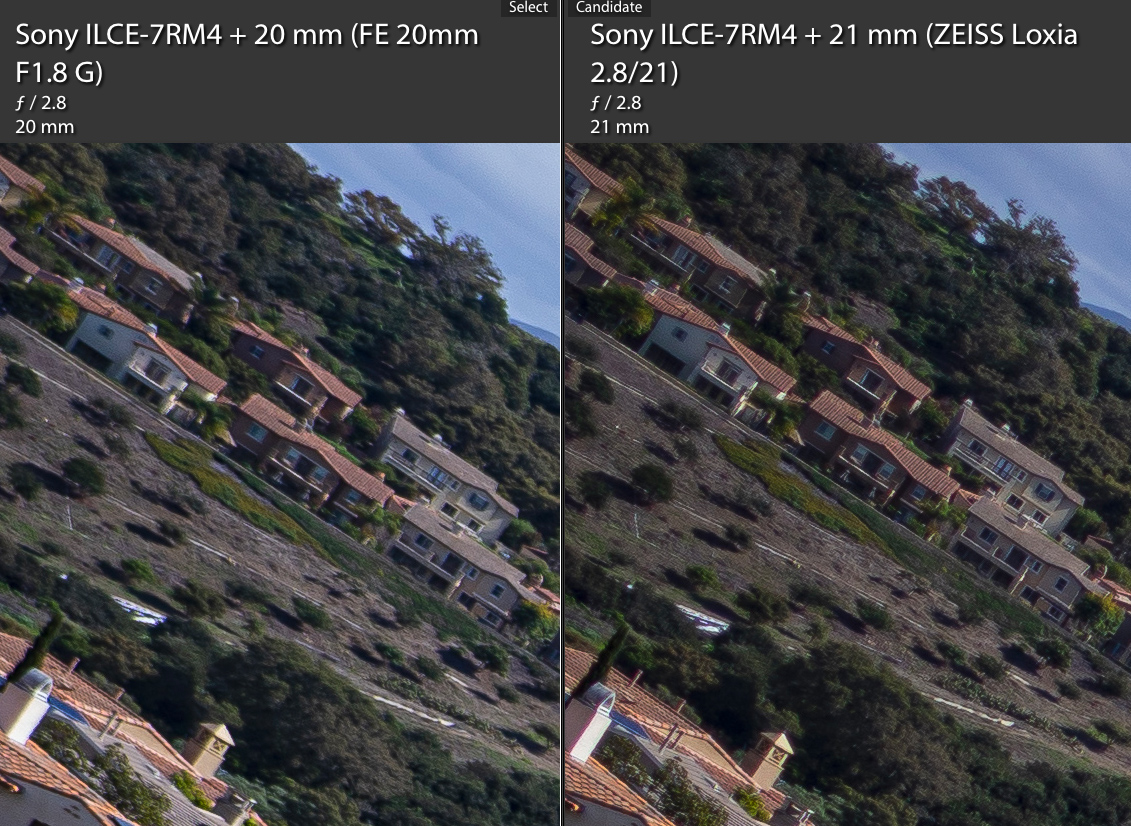

Sony FE 20/1.8 G vs. Loxia 21/2.8
Center resolution comparison between Sony 20mm f/1.8 G vs Loxia 21mm f/2.8:
Center at f/2.8: The Sony is capable of higher resolution (Keep in mind that the Loxia is wide open and the Sony is stopped down to f/2.8)
Center at f/4: The Loxia improves and both are now very similar at center and f/4
Center at f/5.6: Both lenses improve a little bit and perform very similarly
Center at f/8: Strong performance for both, although diffraction starts to reduce micro-contrast
Mar 15, 2020 at 04:56 PM
Admin
p.1 #2 · Sony FE 20mm f/1.8 G Versus Other Lenses

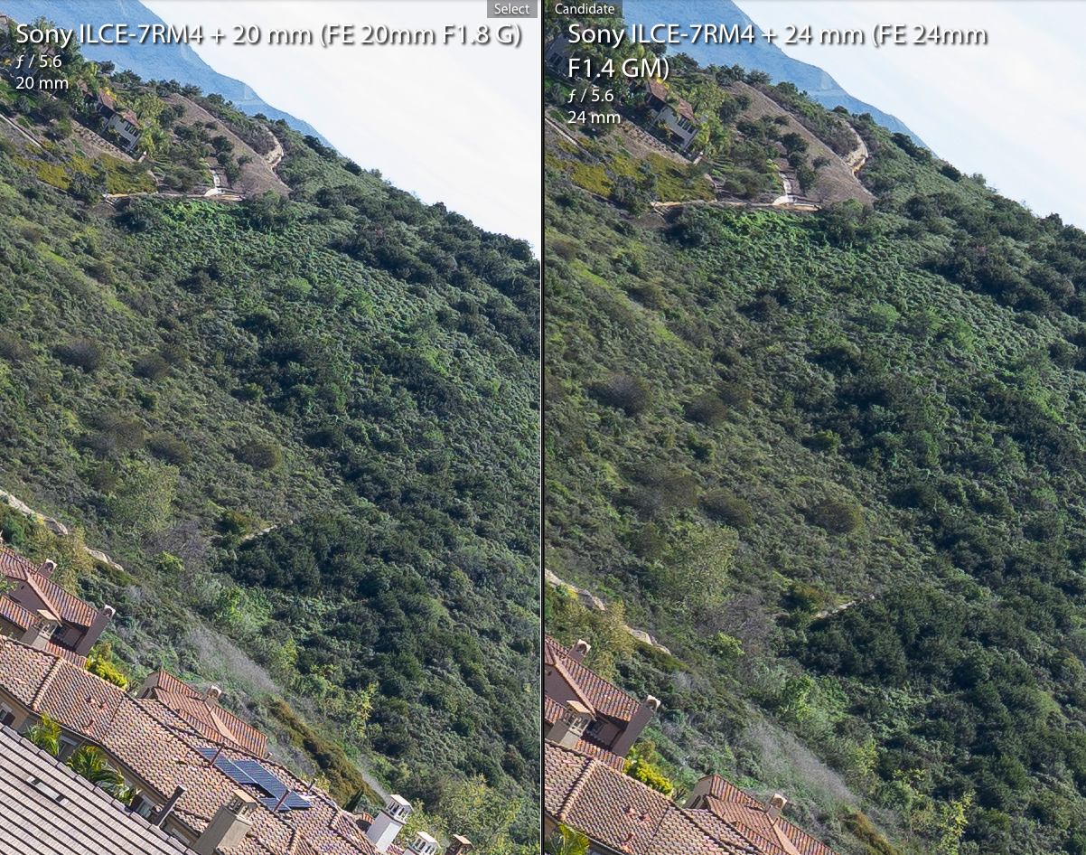

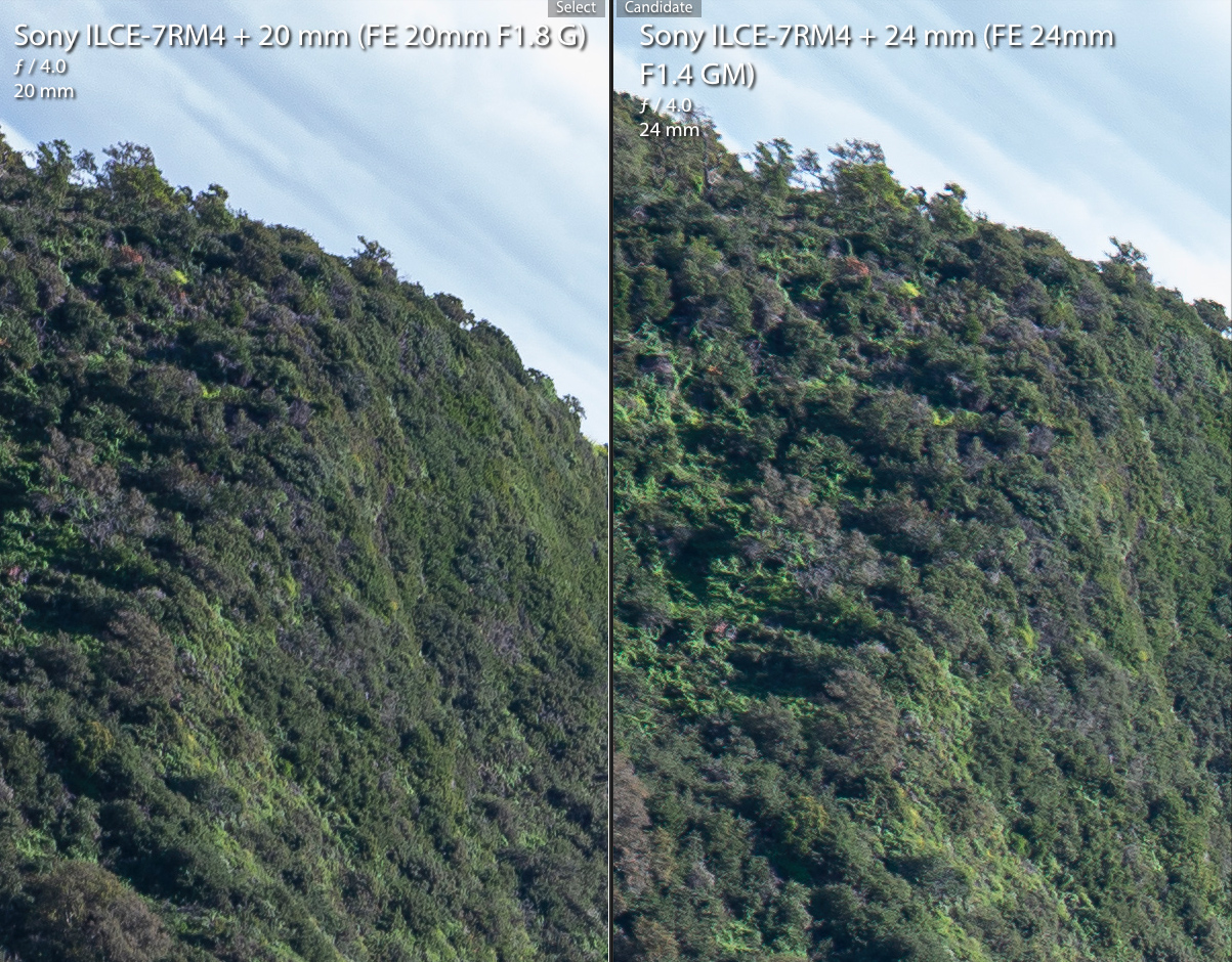

Mid-zone resolution comparison between Sony 20mm f/1.8 G vs Loxia 21mm f/2.8:
Mid-field at f/2.8: Strong performance for both, although the Loxia has the edge in resolution
Mid-field at f/4: The Sony FE 20/1.8 G improves at f/4 and it's now neck and neck with the Zeiss
Mid-field at f/5.6: Very similar performance with Sony slightly better
Mid-field at f/8: Very small difference from f/5.6. Both very strong
Mar 15, 2020 at 05:04 PM
Admin
p.1 #3 · Sony FE 20mm f/1.8 G Versus Other Lenses

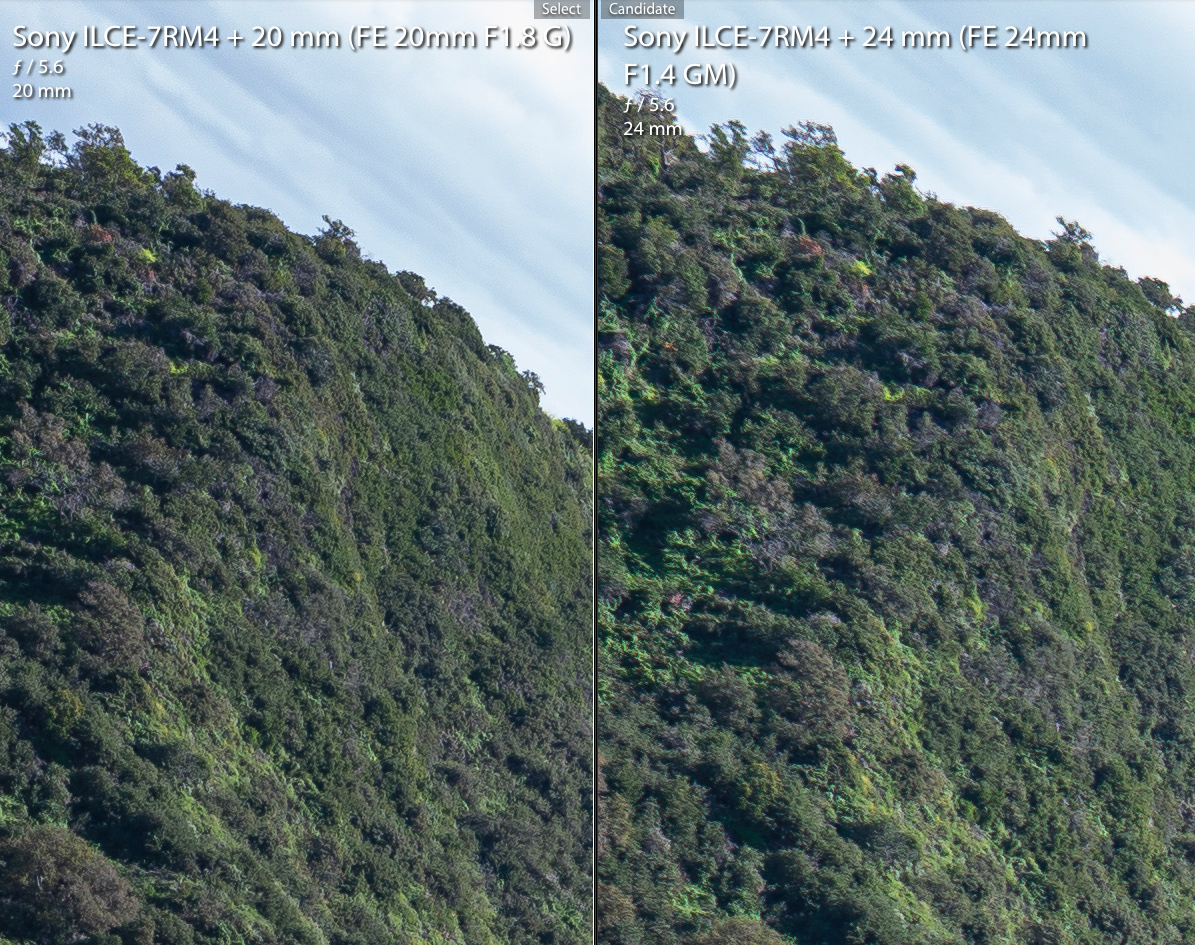

Extreme corner resolution comparison between Sony 20mm f/1.8 G vs Loxia 21mm f/2.8:
Extreme corner at f/2.8: The Loxia has a noticeable advantage even though it's wide open
Extreme corner at f/4: The Sony improves greatly and now matches the Loxia. There is also less lateral CA for the Sony.
Extreme corner at f/5.6: Similar performance. Amazing performance for both lenses
Extreme corner at f/8: Diffraction is now visible but still strong performance for both lenses

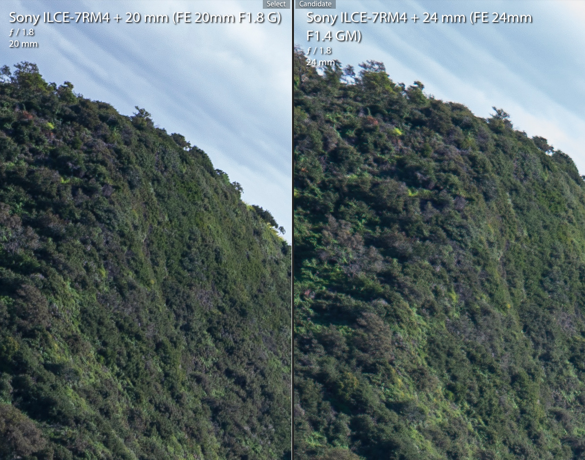

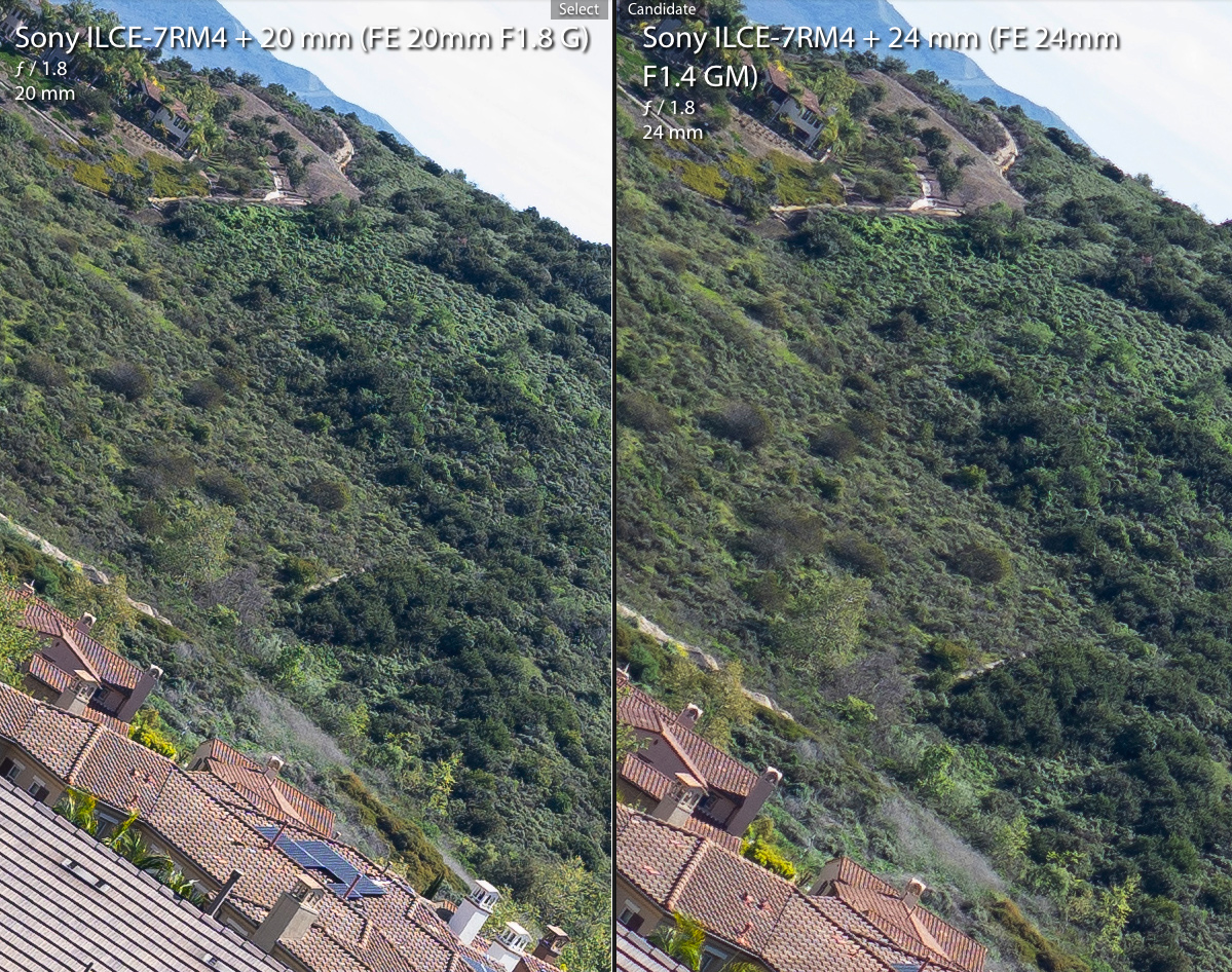

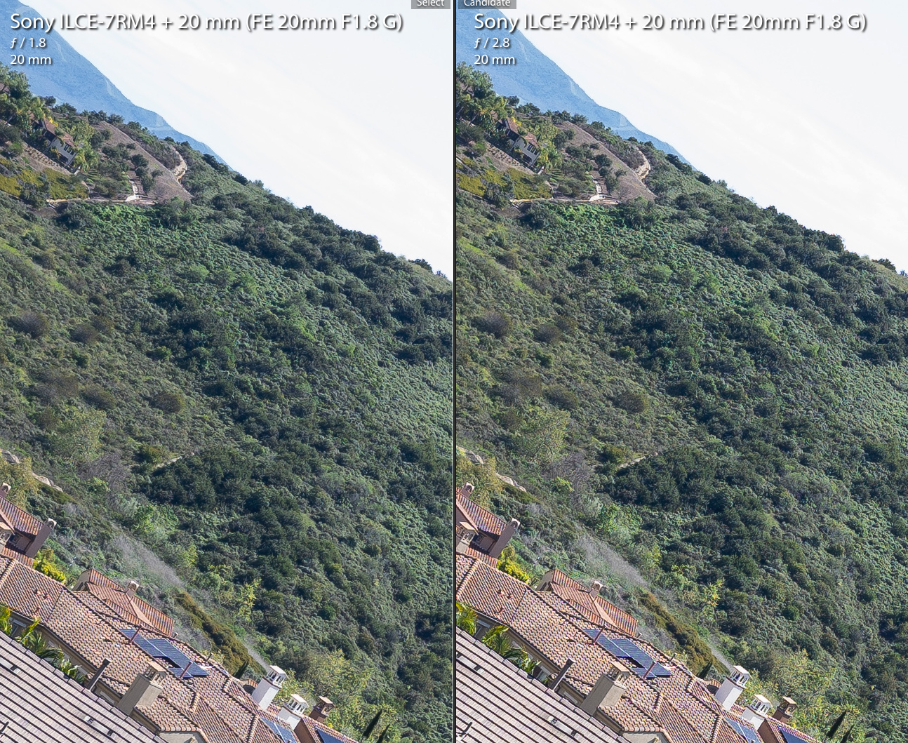

Fred, any idea wide open how the Sony looks, particularly in the center.
Mar 15, 2020 at 09:51 PM
Admin
p.1 #5 · Sony FE 20mm f/1.8 G Versus Other Lenses
Here is a comparison at center:
FE 20/1.8: f/1.8 vs f/2.8:
The 20/1.8 is already very sharp from wide open at center and improves slightly at f/2.8
FE 20/1.8 @f/1.8 vs FE 20/1.8 @f/2.8
Mar 15, 2020 at 10:21 PM

Thank you. Looks very good.

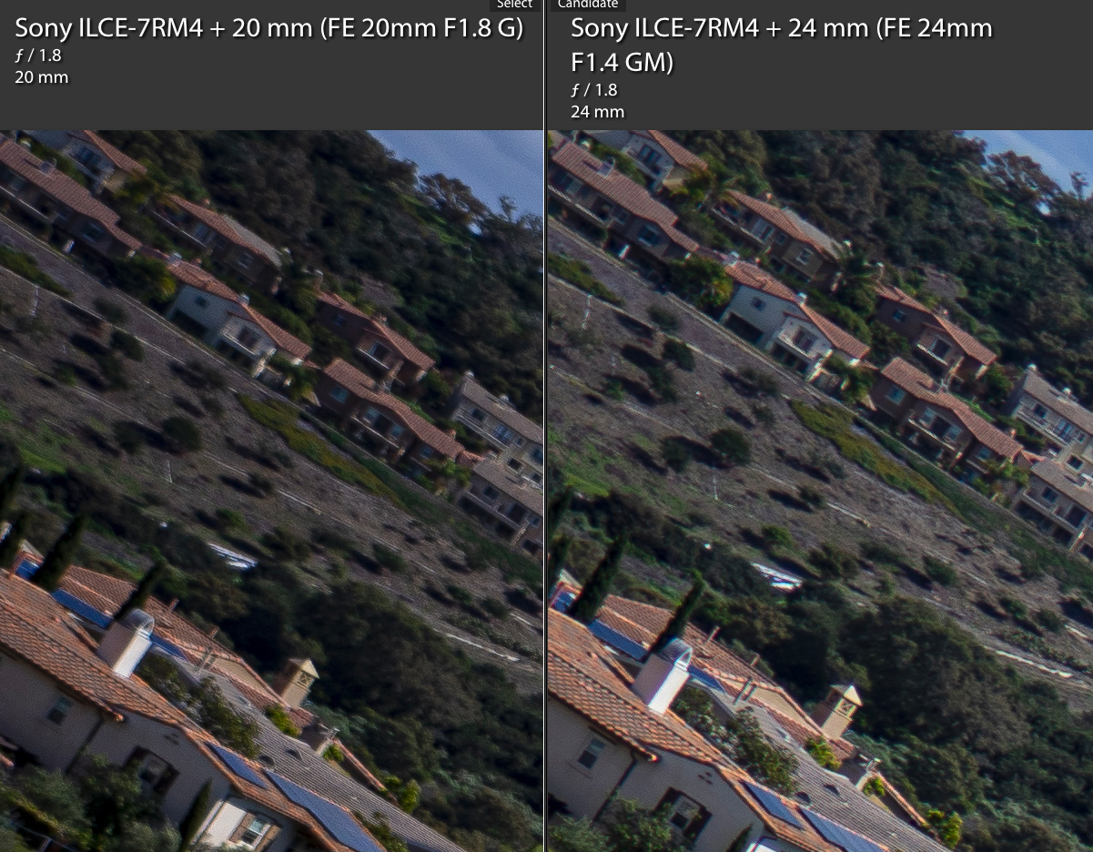

Admin
p.1 #7 · Sony FE 20mm f/1.8 G Versus Other Lenses

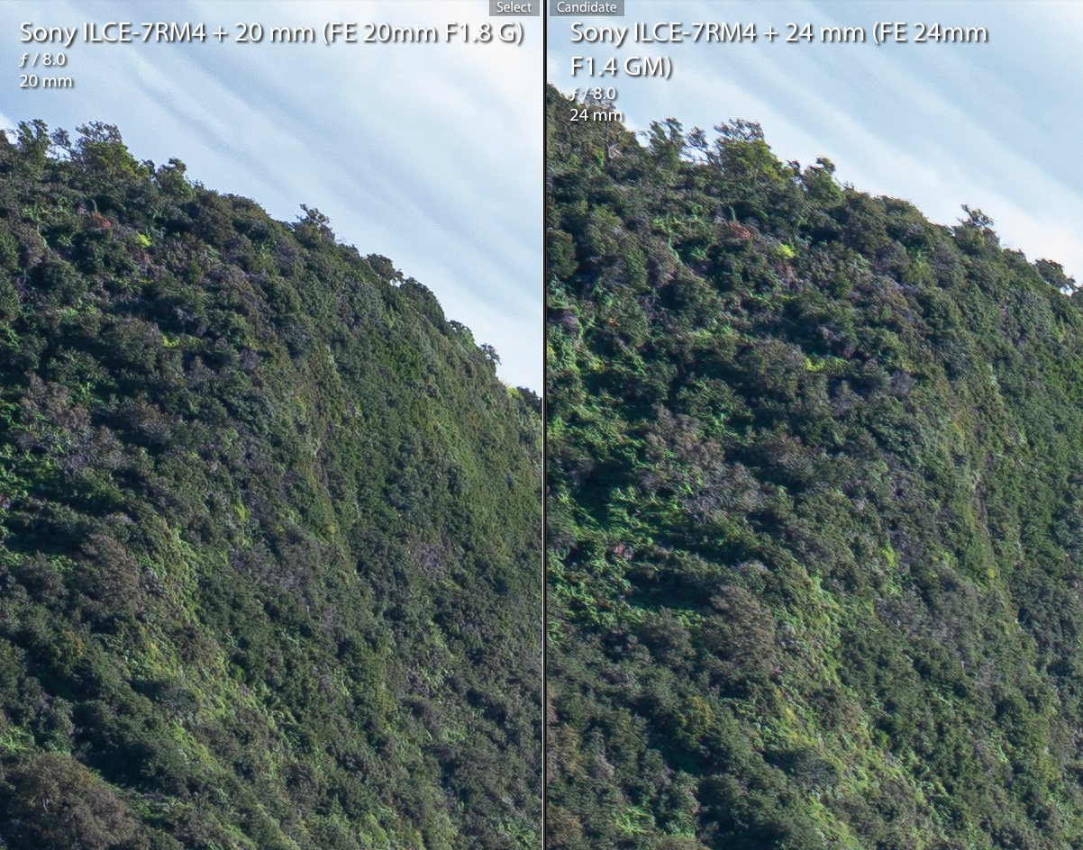

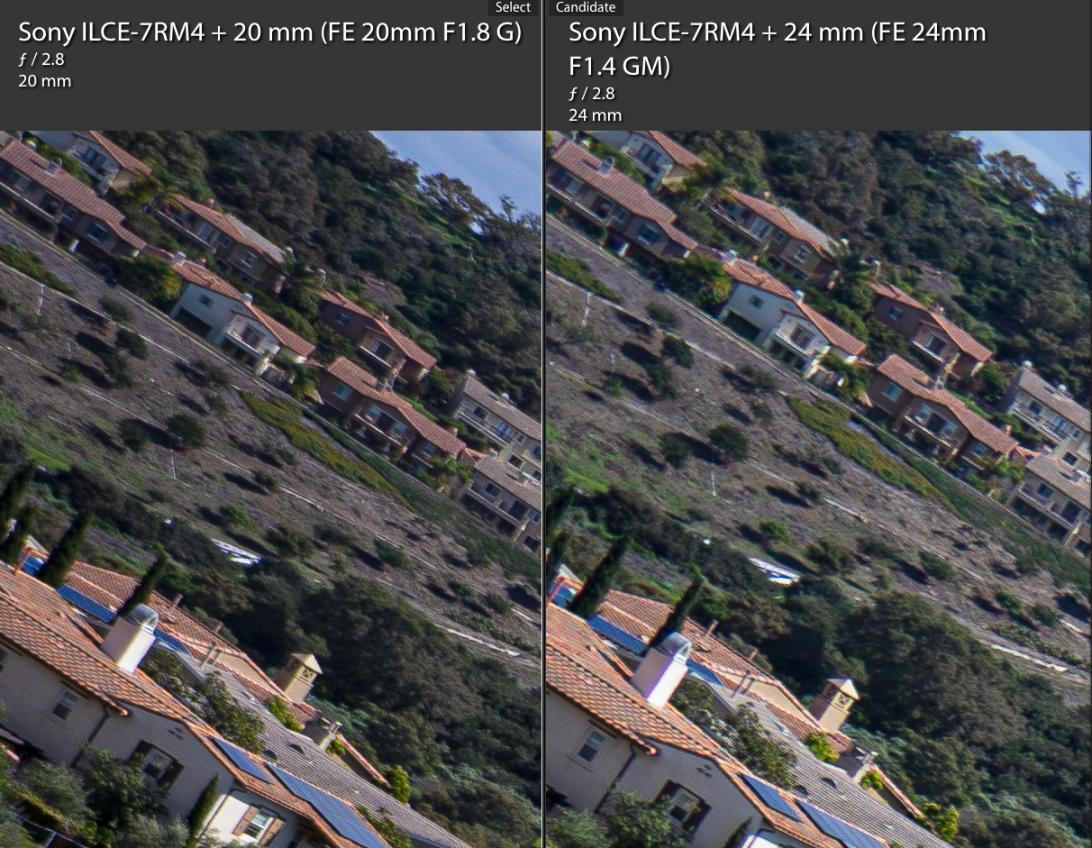

Indeed. At center and wide open, it looks to be just as sharp as the Voigtlander 21/1.4 @f/1.8 and sharper than the FE 24/1.4 GM @f/1.8. I consider this performance outstanding. The mid-zone and corners look great at f/2.8 and outstanding after f/4. (Loxia 21 level)
I will post more comparisons tomorrow.
Mar 15, 2020 at 10:50 PM

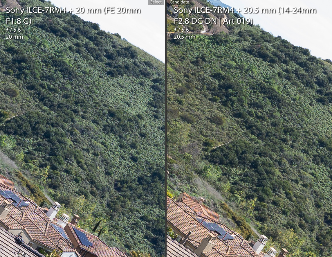

Admin

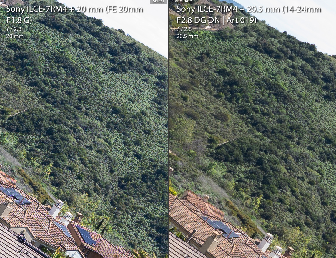

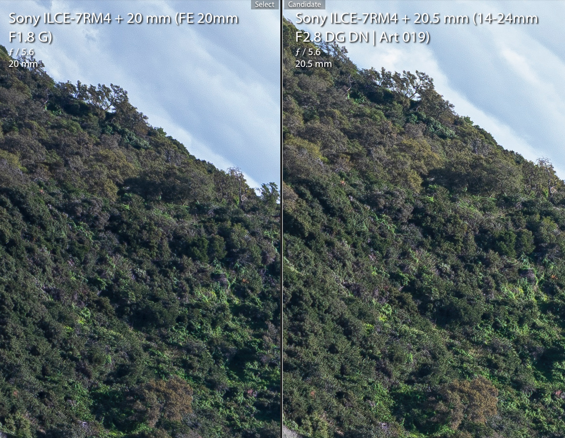

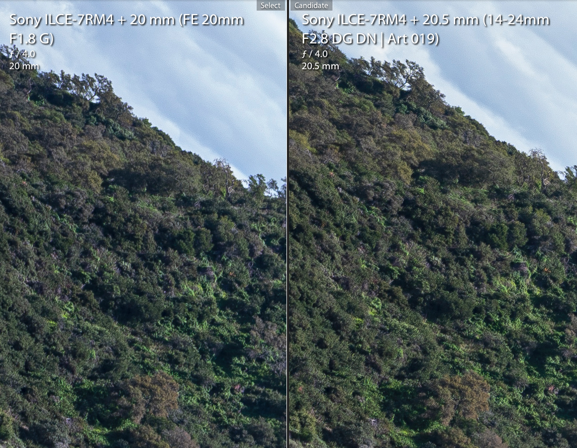

p.1 #17 · Sony FE 20mm f/1.8 G Versus Other Lenses

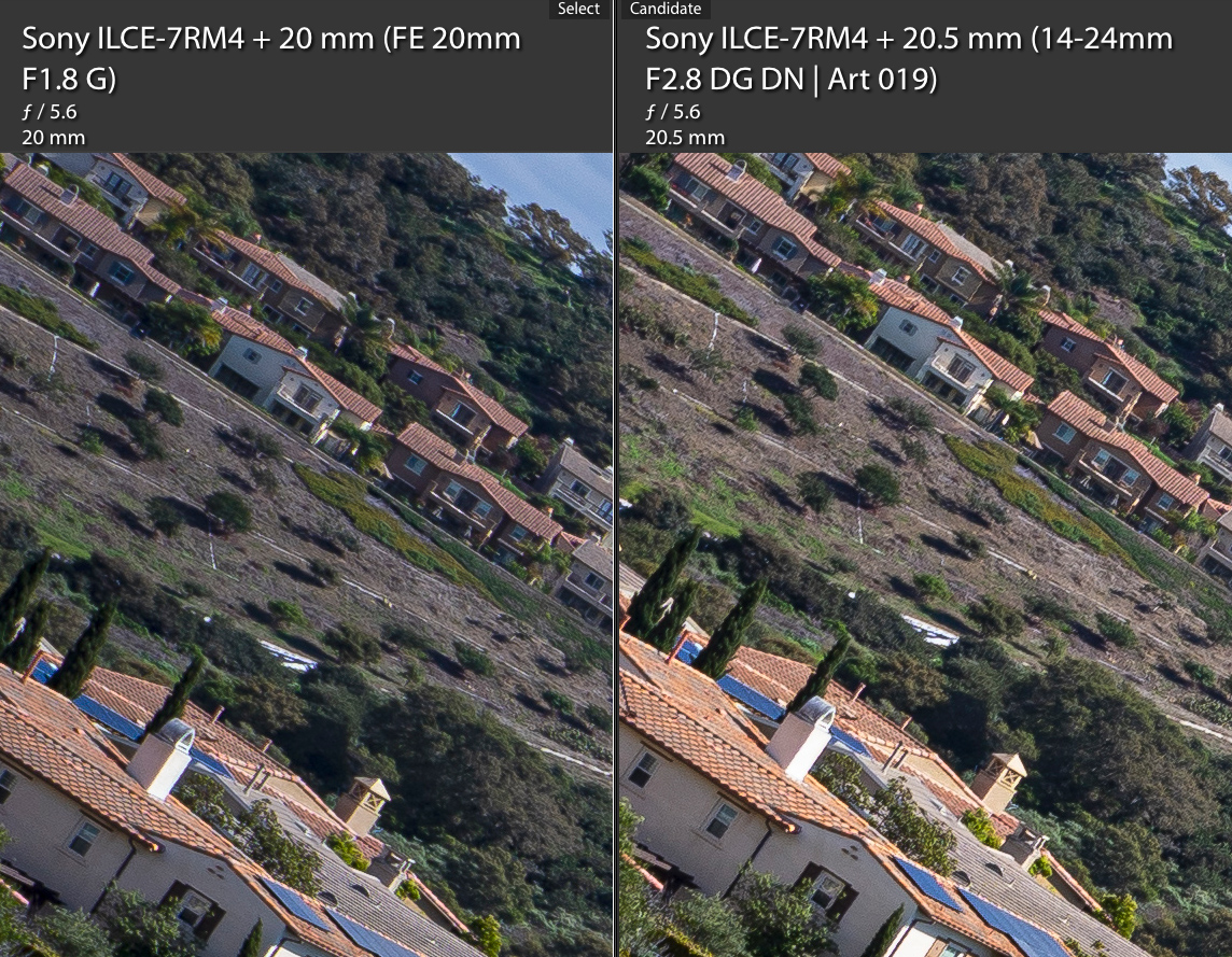

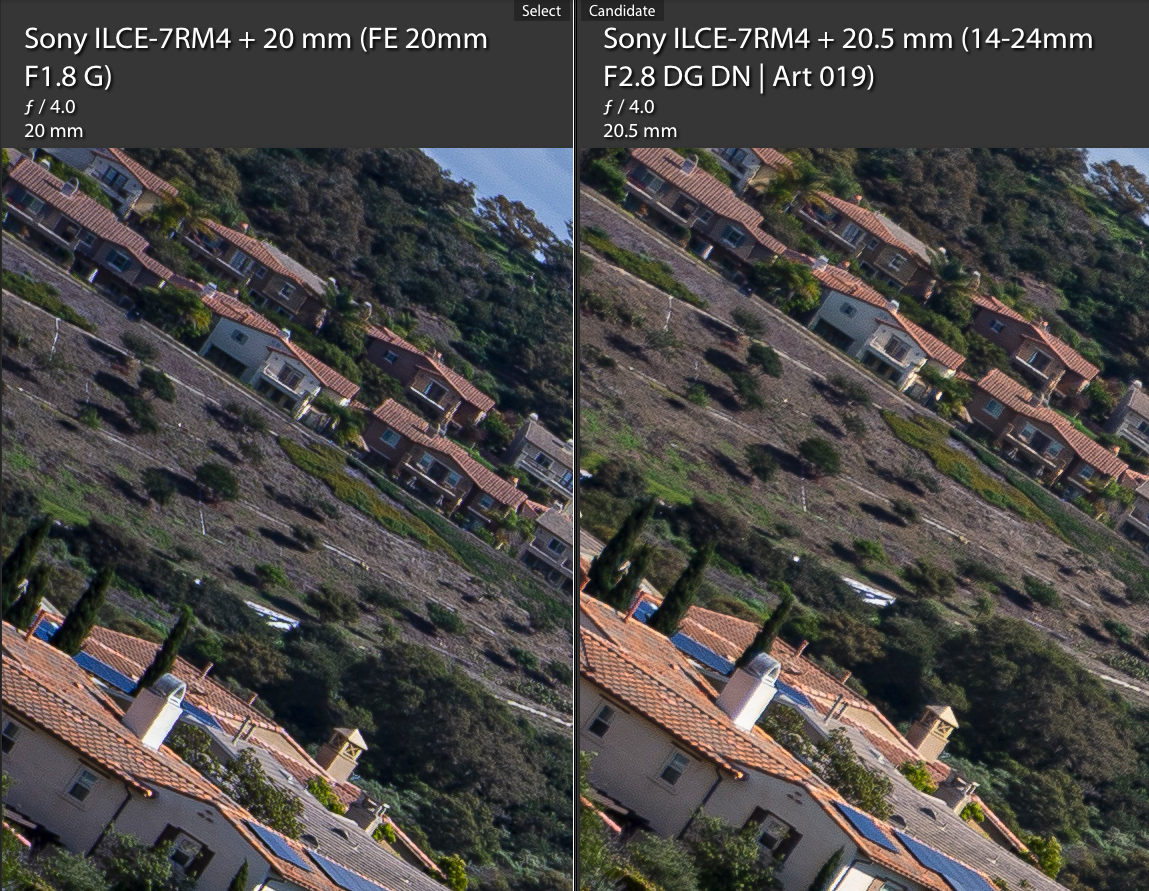

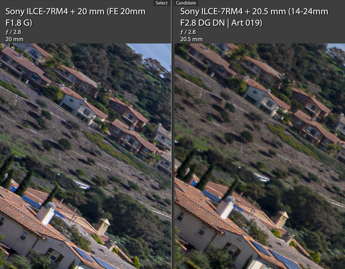

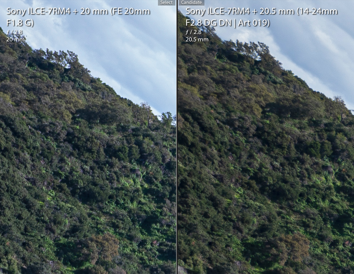

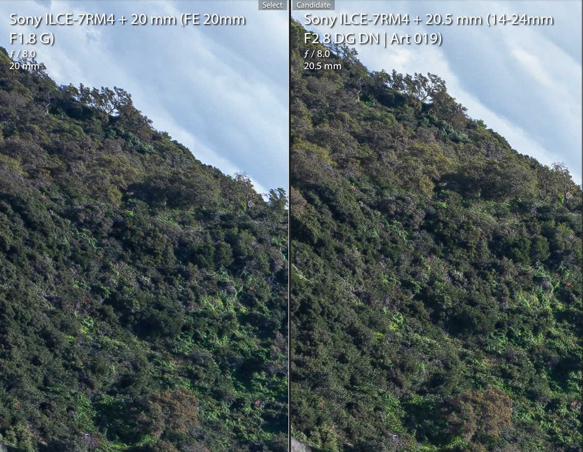

Sony FE 20/1.8 G vs. Sigma 14-24/2.8 Art @20mm
Center resolution comparison between Sony 20mm f/1.8 G vs Sigma 14-24/2.8 Art @20mm:
Center at f/2.8: The new Sony 20/1.8G is outstanding at center and f/2.8 and noticeably better than the Sigma zoom wide open
Center at f/4: The zoom improves greatly and matches the prime. There are difference in color rendition as well.
Center at f/5.6: Both lenses are equal at center
Center at f/8: Both diffract slightly
Mar 16, 2020 at 02:35 PM
Admin
p.1 #18 · Sony FE 20mm f/1.8 G Versus Other Lenses
Mid-zone resolution comparison between Sony 20mm f/1.8 G vs Sigma 14-24/2.8 Art @20mm:
Mid-zone at f/2.8: Both are very similar and the zoom is wide open
Mid-zone at f/4: The Sigma 14-24@20mm does slightly better at mid-zone and f/4 with slightly better contrast and resolution
Mid-zone at f/5.6: Zoom still ahead
Mid-zone at f/8: Not much changes from f/5.6, except for a tad less micro-contrast due to diffraction
Admin
p.1 #19 · Sony FE 20mm f/1.8 G Versus Other Lenses
Extreme corner resolution comparison between Sony 20mm f/1.8 G vs Sigma 14-24/2.8 Art @20mm:
Extreme corner at f/2.8: The Sigma zoom does slightly better wide open
Extreme corner at f/4: Both improve greatly and are pretty similar now
Extreme corner at f/5.6: The Sigma has less vignetting and higher contrast and slightly higher resolution
Extreme corner at f/8: The Sigma continues the f/5.6 trend and performs better at f/8 at the corners
Bob_S
p.1 #20 · Sony FE 20mm f/1.8 G Versus Other Lenses
So the prime loses to a zoom?
Mar 16, 2020 at 03:31 PM
