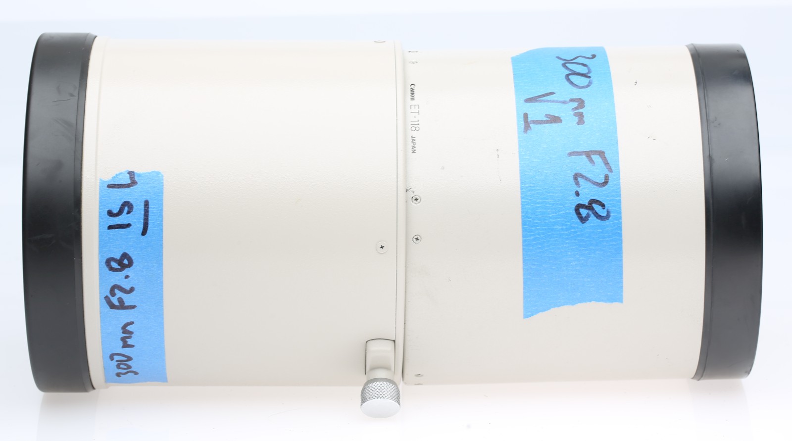

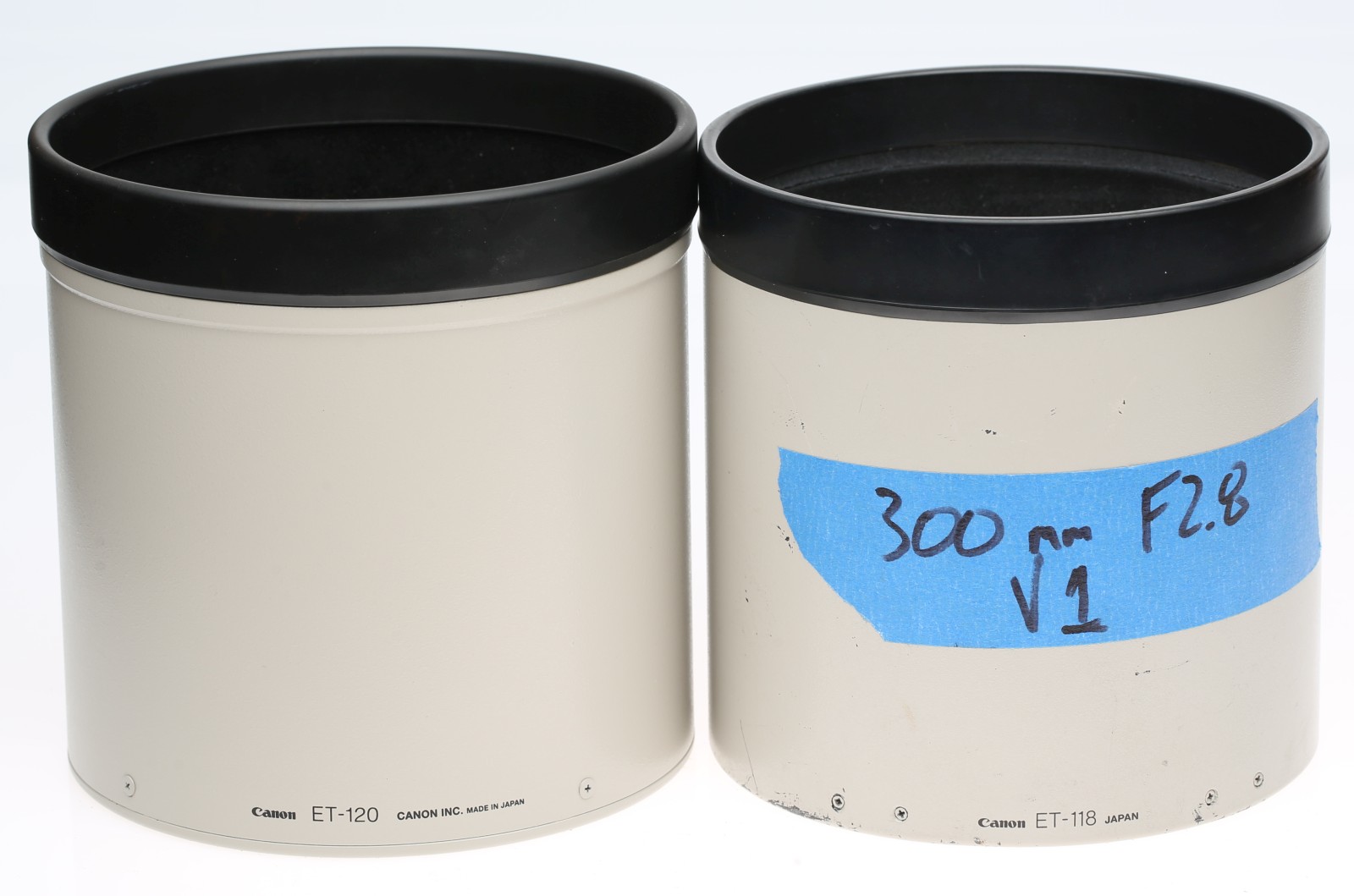

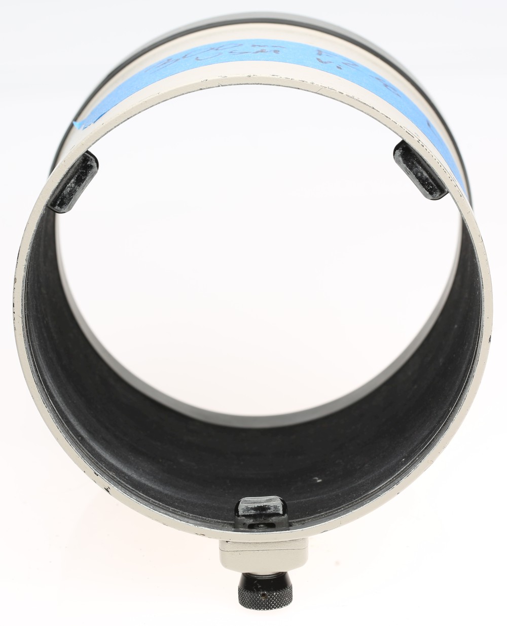

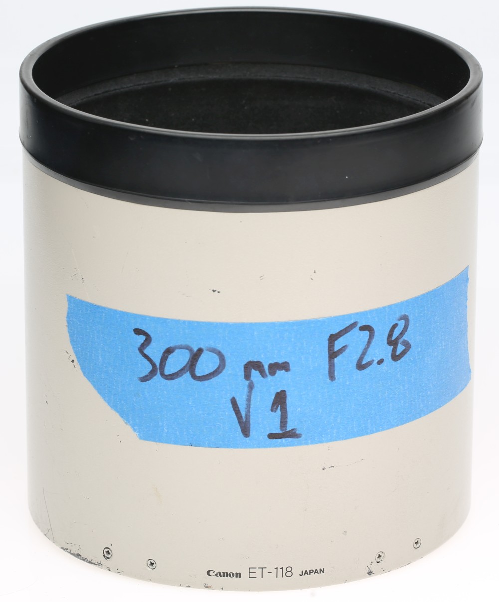

Here are some pictures and dimensions for you.

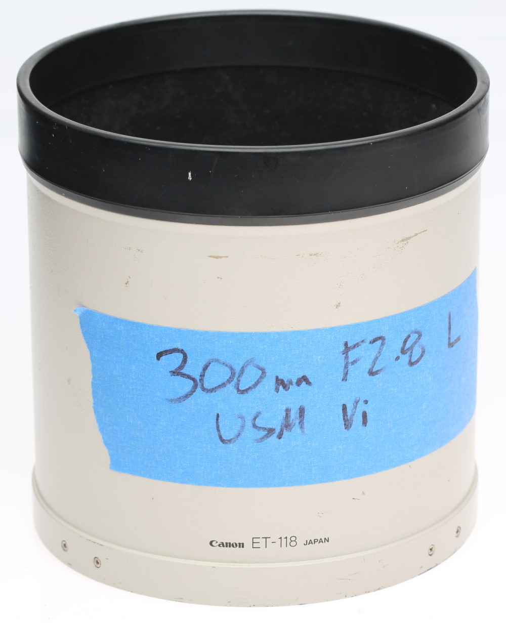

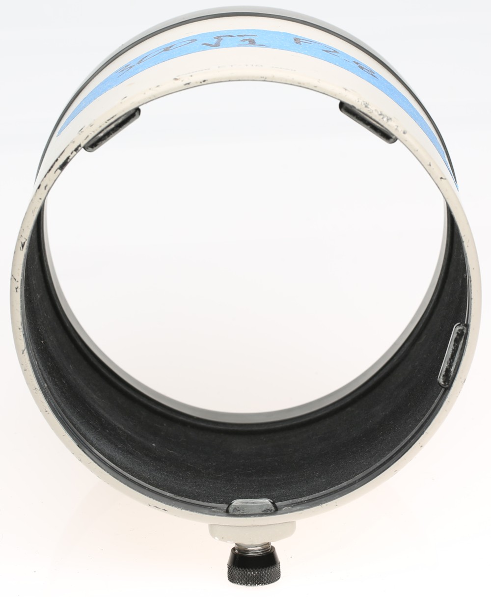

The ET-118 was for the Original 300mm F2.8 L USM Lens. I have seen two different versions of these marked ET-118, and a third type marked ET-118 II.

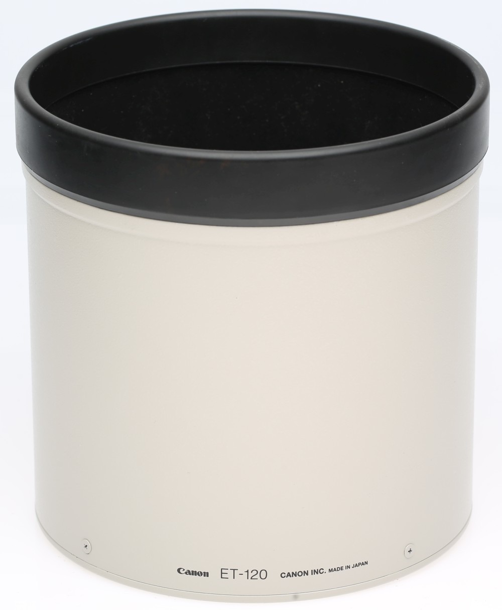

The ET-120 was for the first version of the Image Stabilized 300mm F2.8 IS L USM.

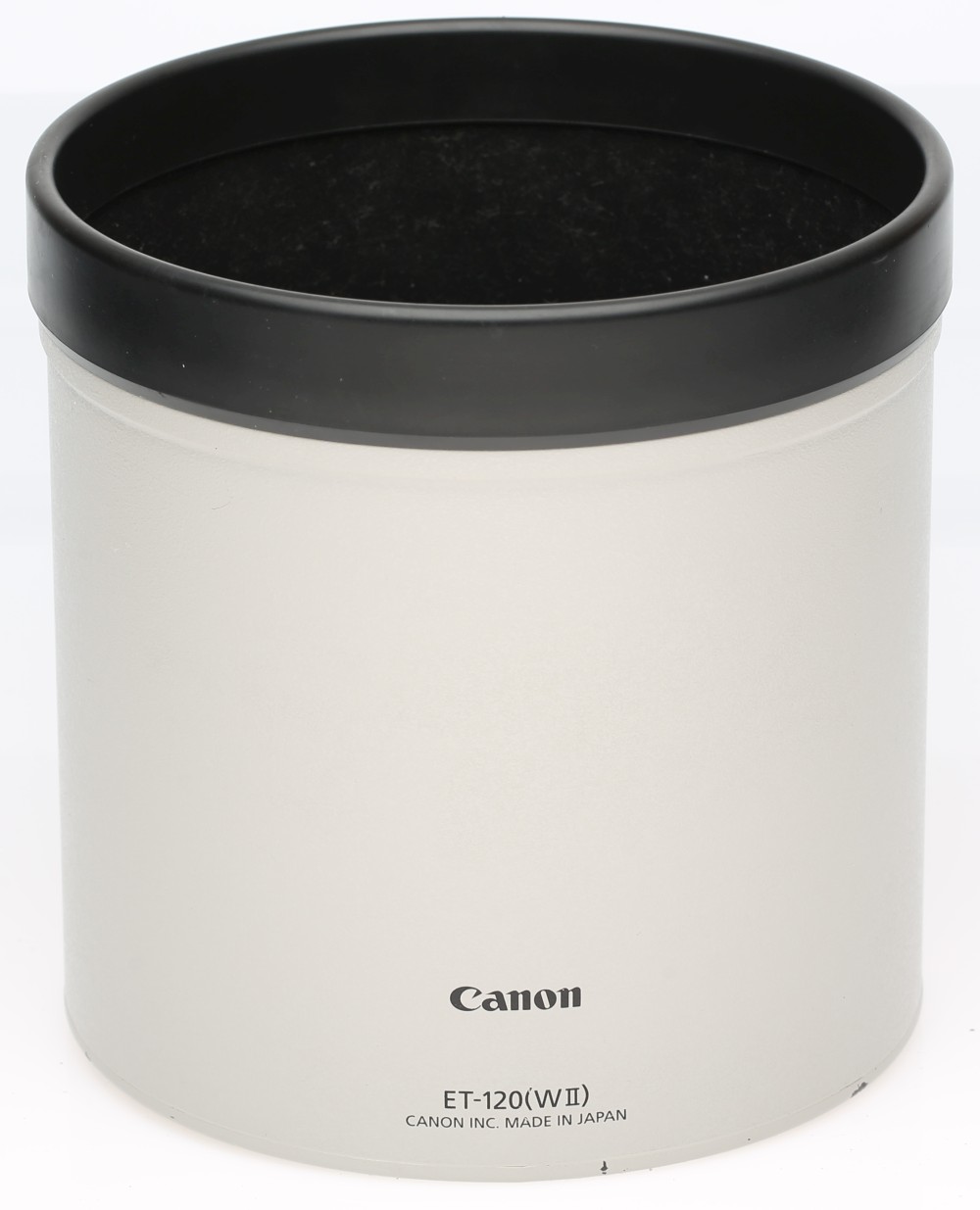

The ET-120 (WII) was for later versions of the Image Stabilized 300mm F2.8 IS L USM.
As far as I can tell the dimensions of the ET-120 and the ET-120 (WII) are the same. The mounting lip on the ET-120 is aluminum and the mounting lip on the ET-120 (WII) is plastic. The thumb screw design changed also.
The ET-120 and ET-120(WII) will fit on the older (first version no IS) of the 300mm F2.8. They will be slightly loose (They can be rotated even when the thumb screw is tightened all the way). They will stay in place.
The ET-118 is too small to fit on the newer 300mm F2.8 IS lenses.
The inside diameter of the ET-118 is about 5.08 inches at the top of the hood. The length measured from end to end is about 5.47 inches. When mounted on the lens it extends 4.57 inches from the front most lip of the lens.
The ET-120 dimensions are 5.32 inches Diameter and end to end length 5.70 inches. When mounted on a 300m F2.8 IS lens it extends 4.83 inches from the front most lip of the lens.

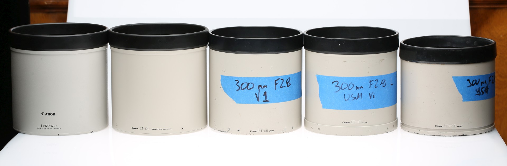

Here are some pictures.
All the hoods in one pictures.

ET-120
ET-118

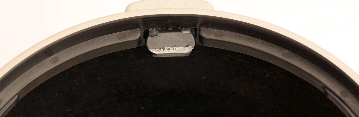

ET-118 mounting detail
ET-118 same part number, same size but different mounting
ET-120 next to ET-118

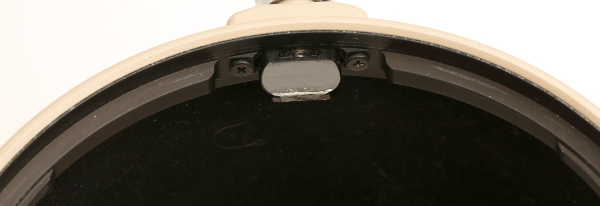

One more picture showing the different mounting detail of one of the two different ET-118 hoods.
Mounting detail of ET-118

Here's a picture of the black plastic injection molded mounting lip on the ET-120(WII). You can see the round marks from the injection mold ejector pins.
And a picture of the black anodized aluminum mounting lip on the ET-120.
ET-120 (WII) With Black Plastic Injection Molded Mounting Lip
ET-120 With Black Anodized Aluminum Mounting Lip.
