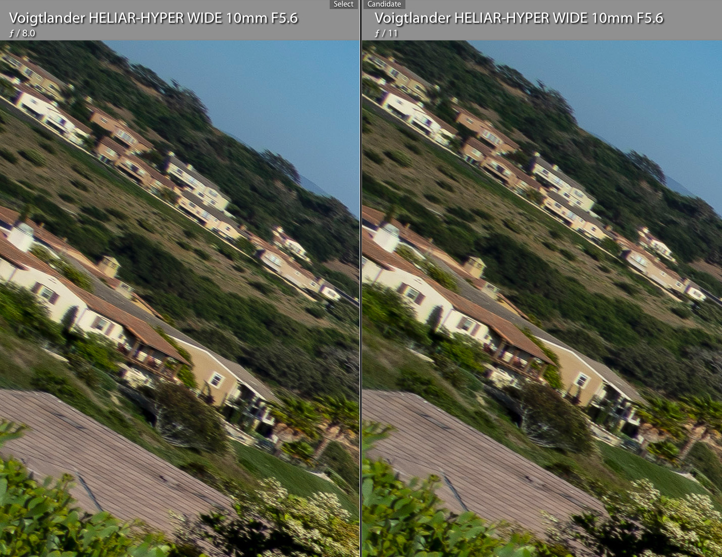

I just received a brand new CV 10/5.6 E-mount to compare to my CV 12/5.6 (which I have a great copy). It's like night and day for the extreme corners. I can't believe Voigtlander discontinued this lens!
Here are they at f/7.1:
PS: I don't remember this smear towards the extreme corners when I tested the CV 10/5.6 two years ago but improves greatly at ~ f/11.
Jul 06, 2019 at 06:16 PM
