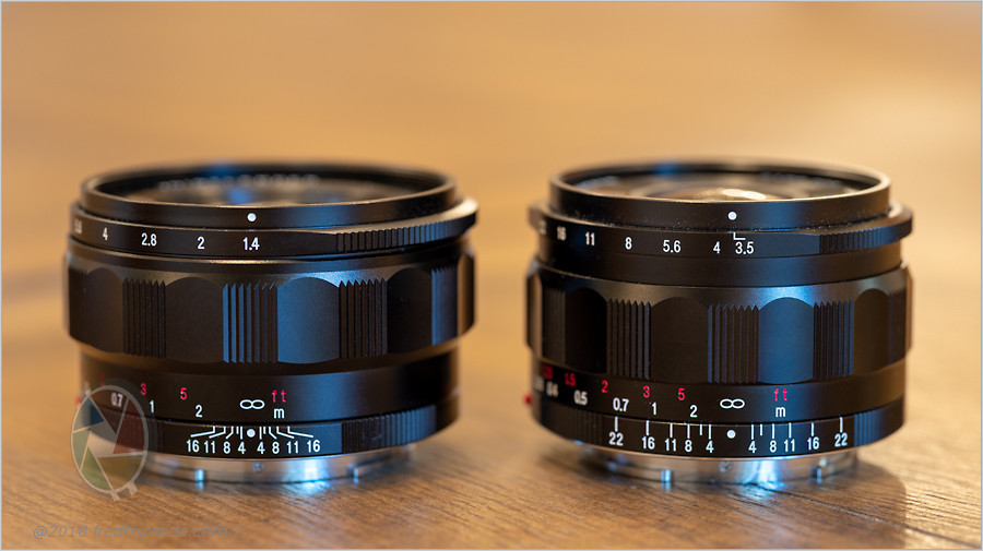

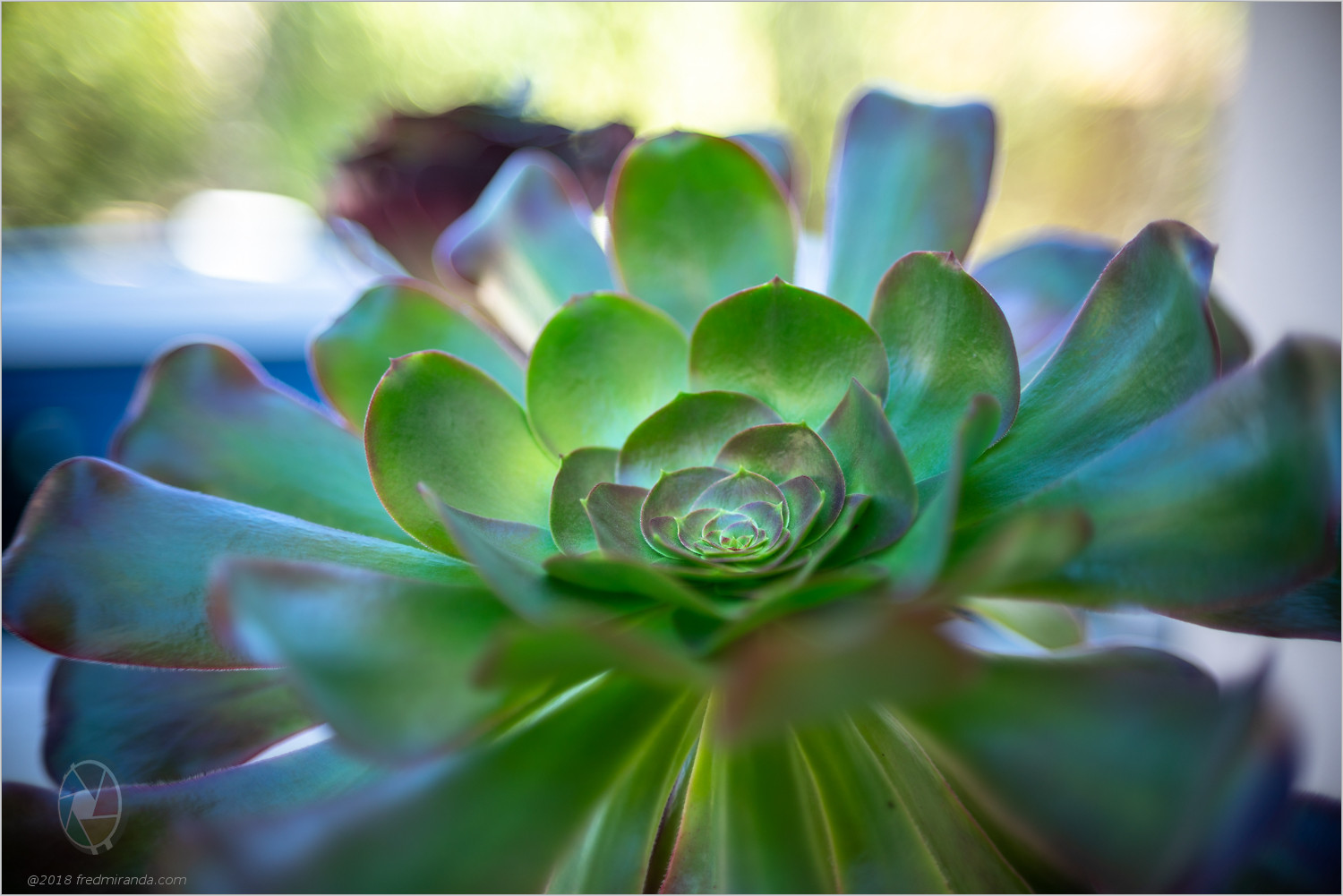

As a landscape photographer, I’m drawn to the special quality of lenses like the Loxia 35/2 and Voigtlander 40/1.2 Nokton, in respect to color rendering, sunstar definition, flare resistance and of course resolution and contrast at infinity distance.
These lenses also shine at wide apertures for environment portraits and other applications that benefit from a narrow depth of field. The Loxia is a capable lens when stopped down and the 40/1.2 follows similar characteristics although medium apertures satisfy demands for sharpness across the entire field.
How does the Voigtlander 35/1.4 Classic E-mount perform in comparison?
Reviews on this lens are scarce and it's fair to say it wasn’t very well received here - in the US market.
The out of focus rendering is a bit rough but some people might appreciate the classic rendering with strong specular highlights' outlining and structural/harsh rendition.

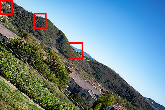

Here is the full image thumbnail showing the areas demonstrated at 1:1 magnification.
  1. Distance: Infinity
  2. Focus: Center - Best of three @ 12.4x magnification
  3. WB: Daylight for both lenses
  4. All Lenses perfectly centered using my decentering test
  5. Software: Lightroom FM Default Landscape Sharpening. All other settings set to default
    PS: Vignetting and distortion NOT corrected

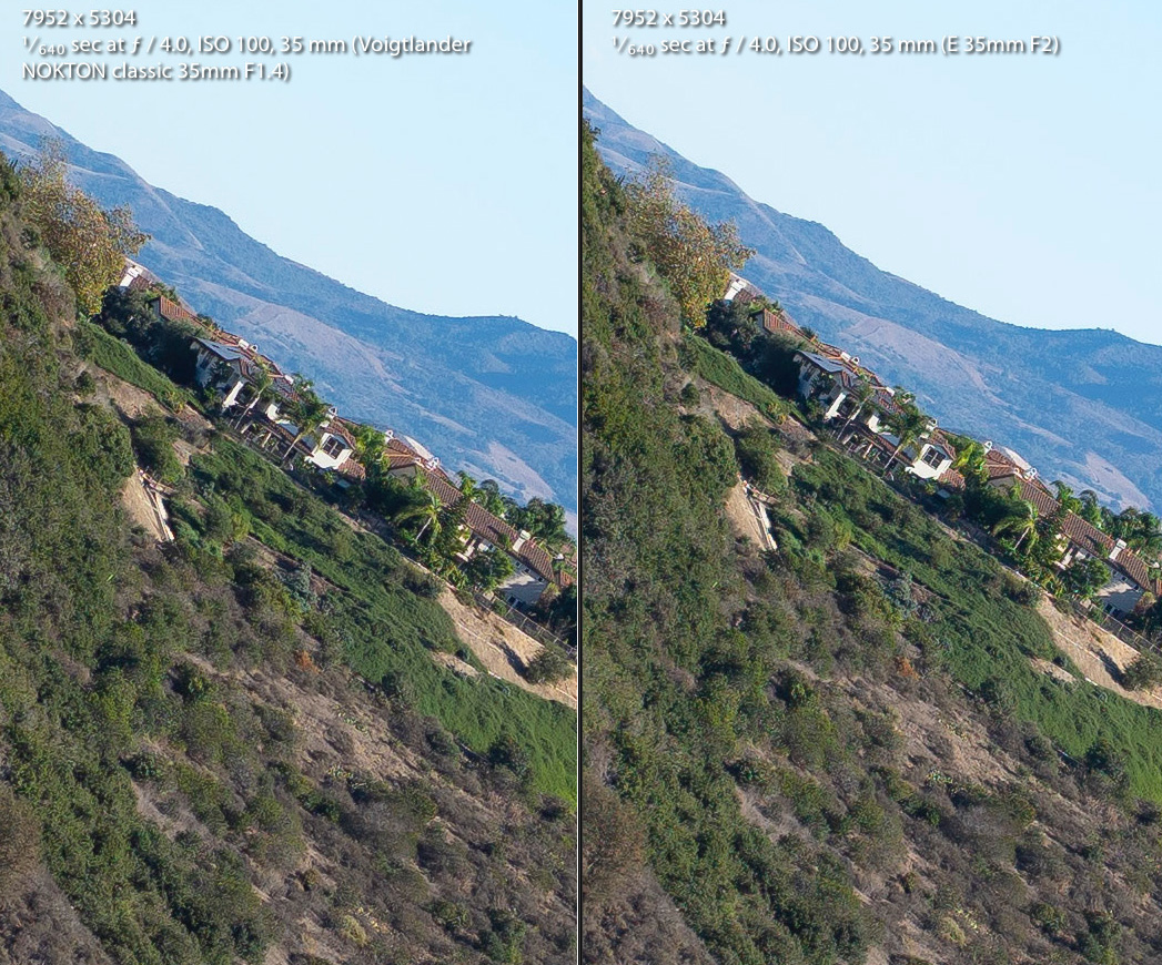

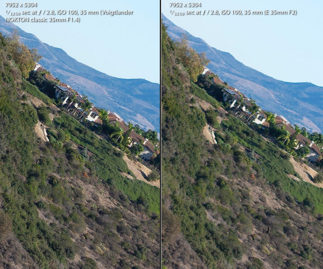

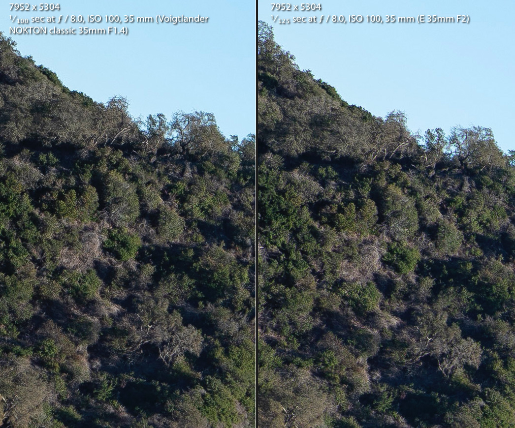

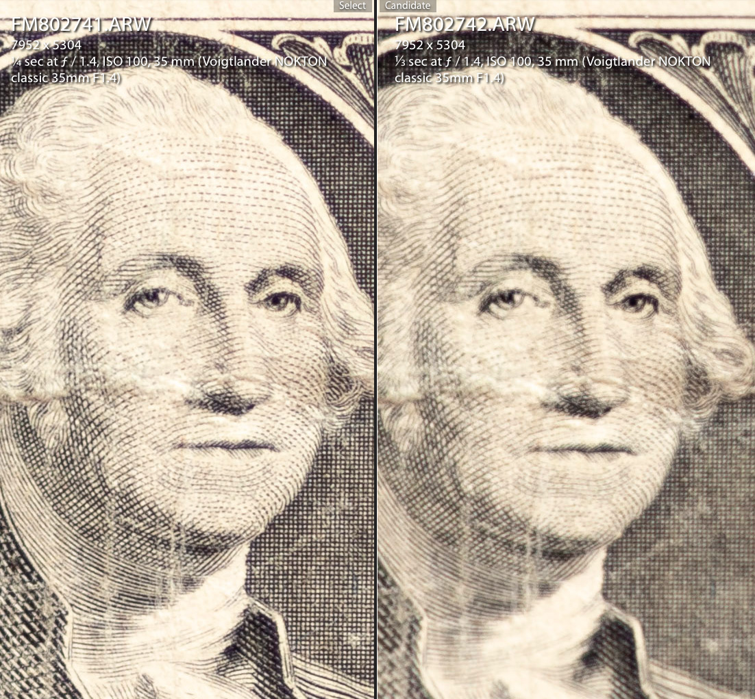

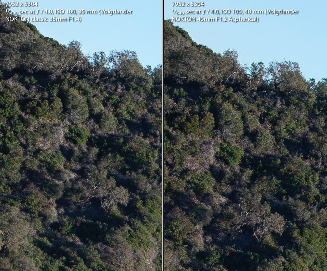

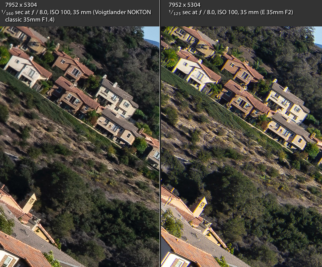

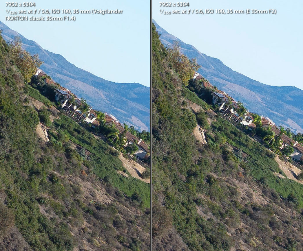

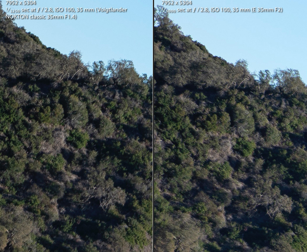

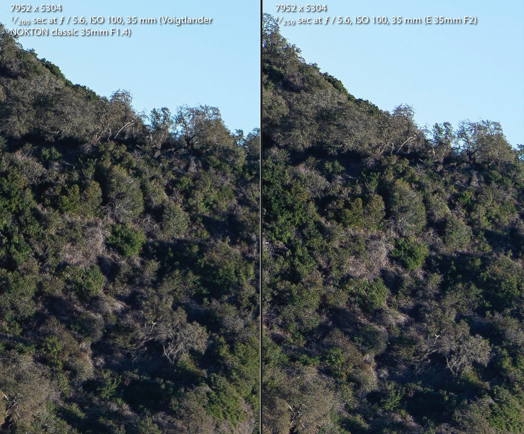

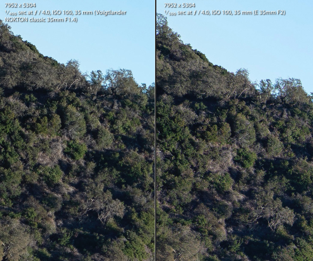

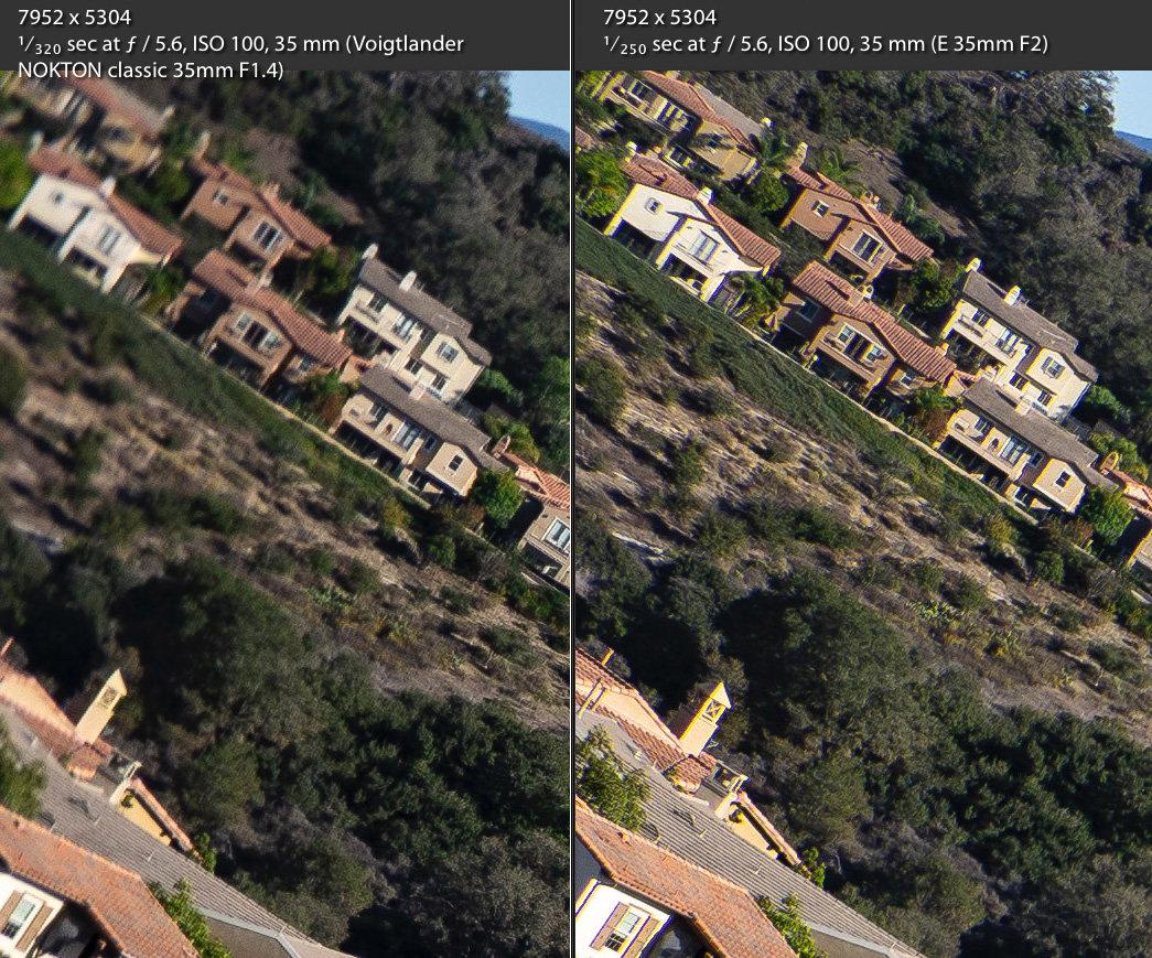

Center resolution comparison between Voigtlander 35/1.4 Classic vs Loxia 35/2:
Center @f/2.8: Voigtlander 35/1.4 Classic vs Loxia 35/2 - The Voigtlander 35/1.4 is actually ahead here!
Center @f/4: Voigtlander 35/1.4 Classic vs Loxia 35/2 - They are now very similar and the Loxia has a bit more micro-contrast
Center @f/5.6: Voigtlander 35/1.4 Classic vs Loxia 35/2 - Similar with Loxia slightly ahead
Center @f/8: Voigtlander 35/1.4 Classic vs Loxia 35/2 - Both diffract and are pretty much equal at this aperture

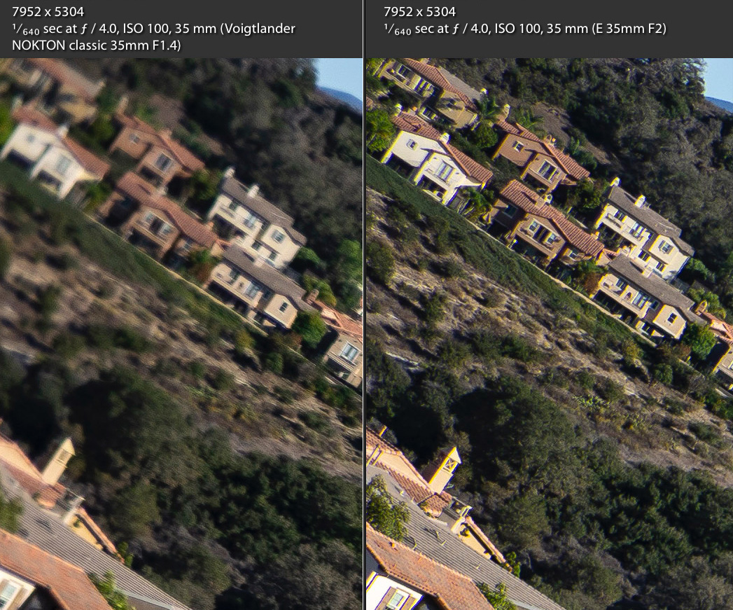

Mid-field comparison between Voigtlander 35/1.4 Classic vs Loxia 35/2:
Mid-zone @f/2.8: Voigtlander 35/1.4 Classic vs Loxia 35/2 - Both a bit weak at this aperture
Mid-zone @f/4: Voigtlander 35/1.4 Classic vs Loxia 35/2 - Both improve greatly at f/4
Mid-zone@f/5.6: Voigtlander 35/1.4 Classic vs Loxia 35/2 - Very similar
Mid-zone @f/8: Voigtlander 35/1.4 Classic vs Loxia 35/2 - Very similar

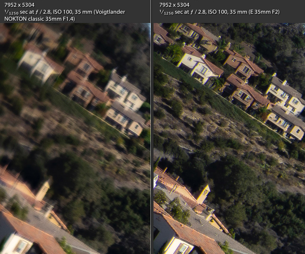

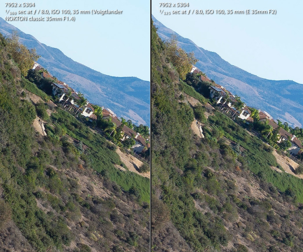

Extreme corners comparison between Voigtlander 35/1.4 Classic vs Loxia 35/2:
Extreme edge @f/2.8: Voigtlander 35/1.4 Classic vs Loxia 35/2 - At the extreme corner, the Loxia is much ahead. Notice, I have a super copy of the Loxia 35/2 as most are mushy at f/2.8 at the very edges. So keep that in mind.
Extreme edge @f/4: Voigtlander 35/1.4 Classic vs Loxia 35/2 - Loxia is still killing here
Extreme edge @f/5.6: Voigtlander 35/1.4 Classic vs Loxia 35/2 - start to get interesting as only the very edges are not good for the Voigtlander
Extreme edge @f/8: Voigtlander 35/1.4 Classic vs Loxia 35/2 - It's a miracle and the Voigtlander improves a lot and gets competitive with the Loxia 35
Oct 21, 2018 at 01:02 PM

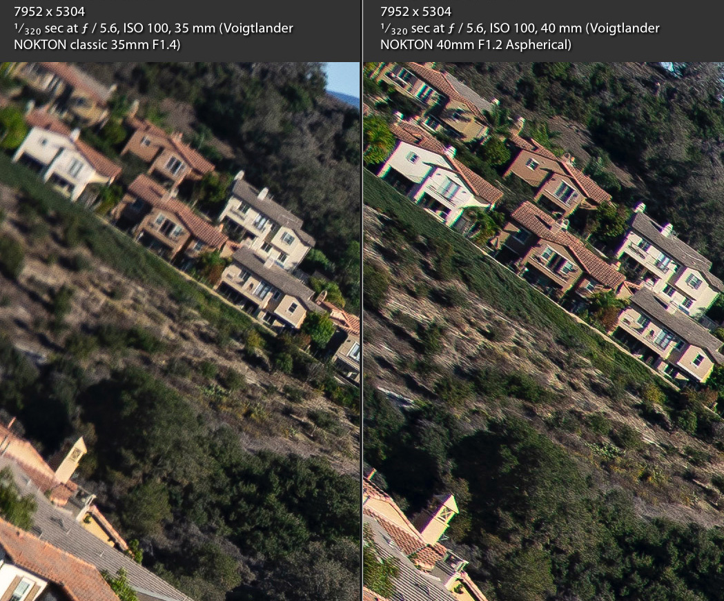

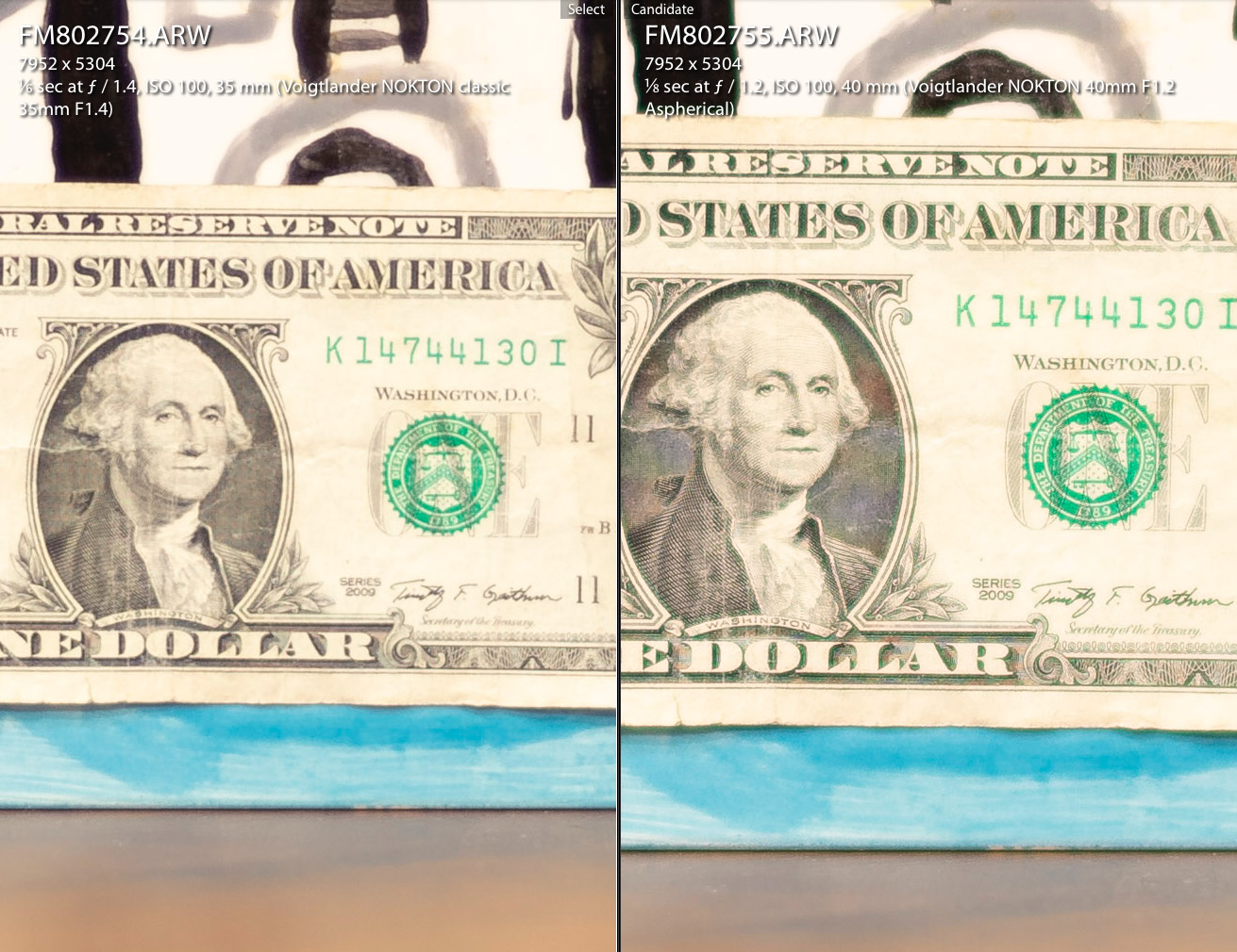

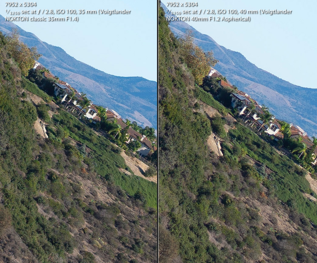

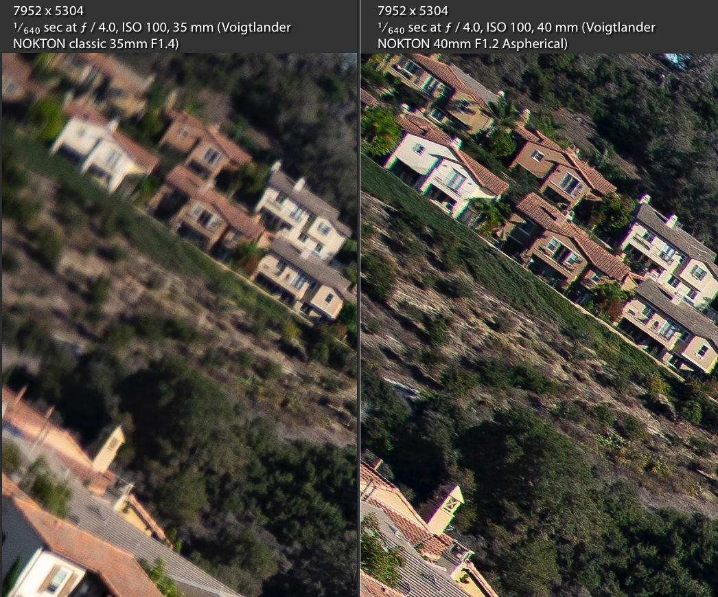

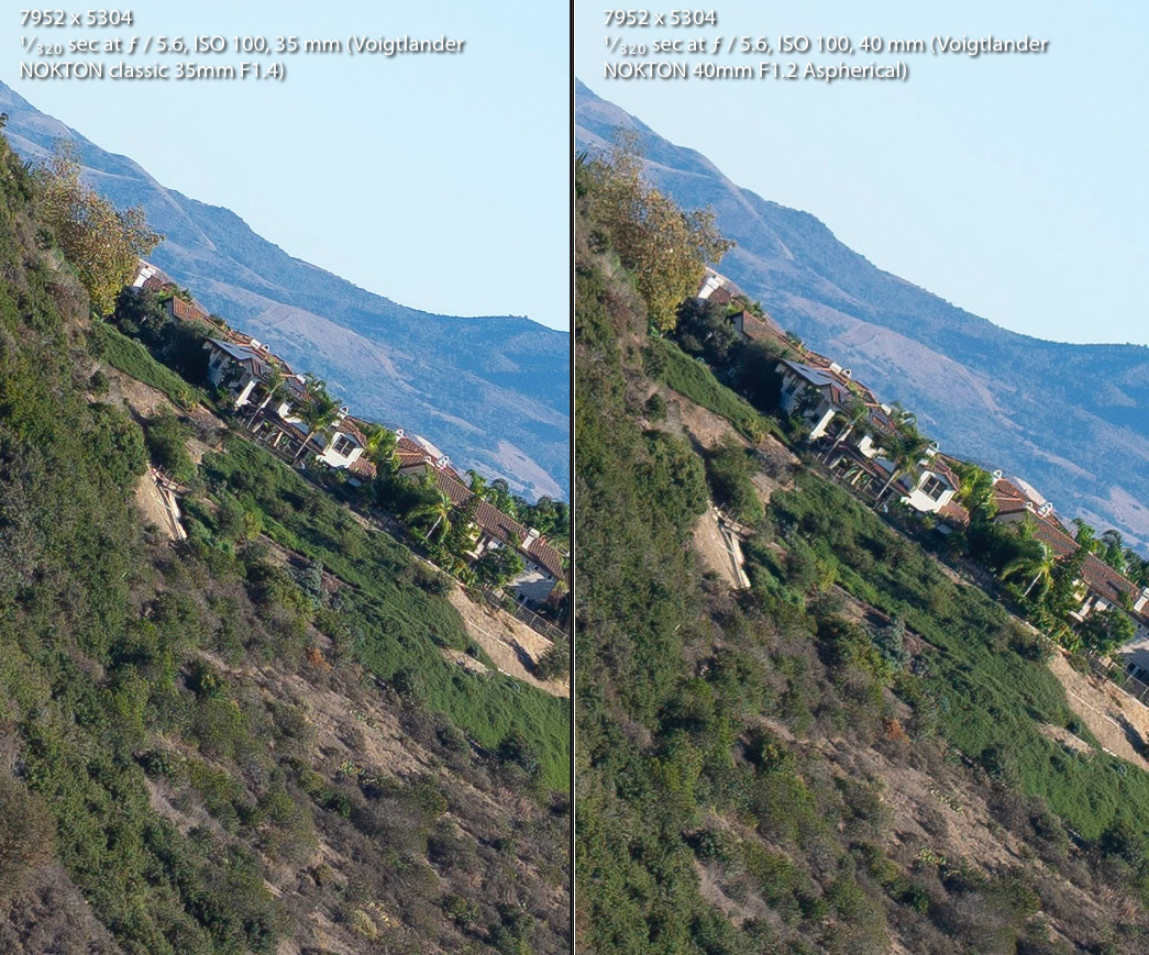

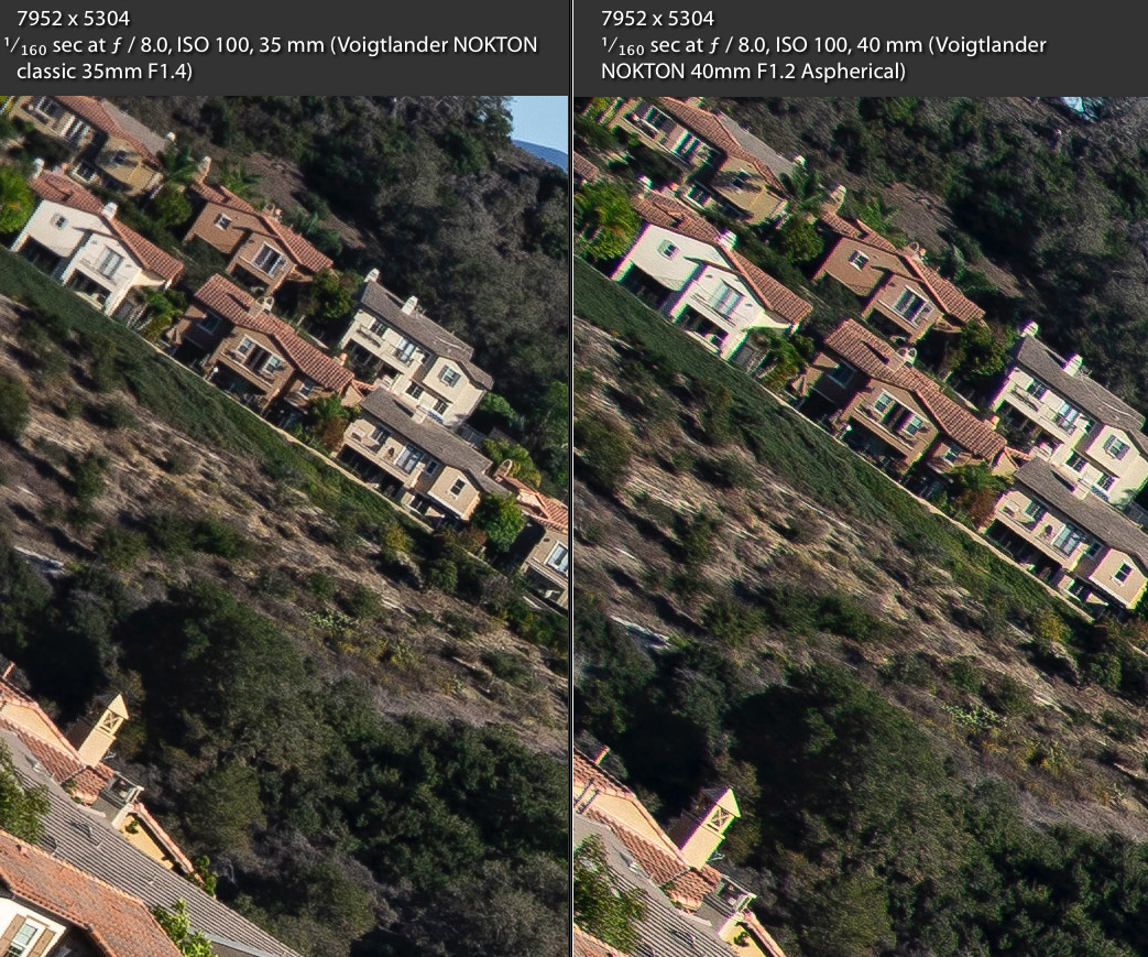

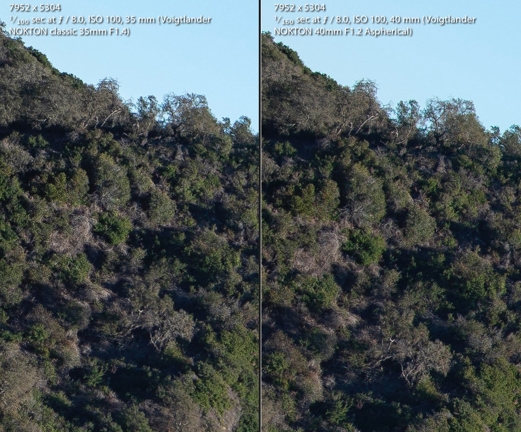

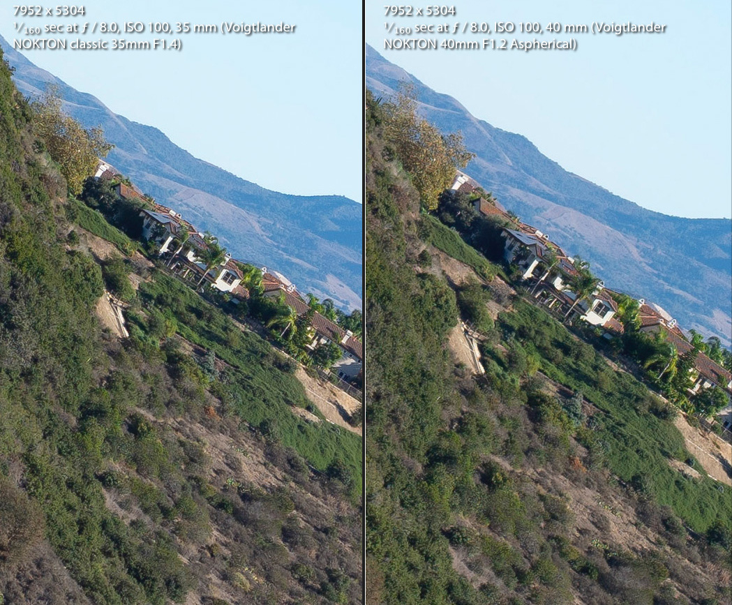

Center comparison between Voigtlander 35/1.4 Classic vs Voigtlander 40/1.2 Nokton:
Center @f/2.8: Voigtlander 35/1.4 Classic vs Voigtlander 40/1.2 Nokton - Similar performance
Center @f/4: Voigtlander 35/1.4 Classic vs Voigtlander 40/1.2 Nokton - Similar performance with perhaps the 'Classic' very slightly ahead
Center @f/5.6: Voigtlander 35/1.4 Classic vs Voigtlander 40/1.2 Nokton - Similar performance with perhaps the 'Classic' very slightly ahead
Center @f/8: Voigtlander 35/1.4 Classic vs Voigtlander 40/1.2 Nokton - Both diffract. Similar performance
Oct 21, 2018 at 01:04 PM

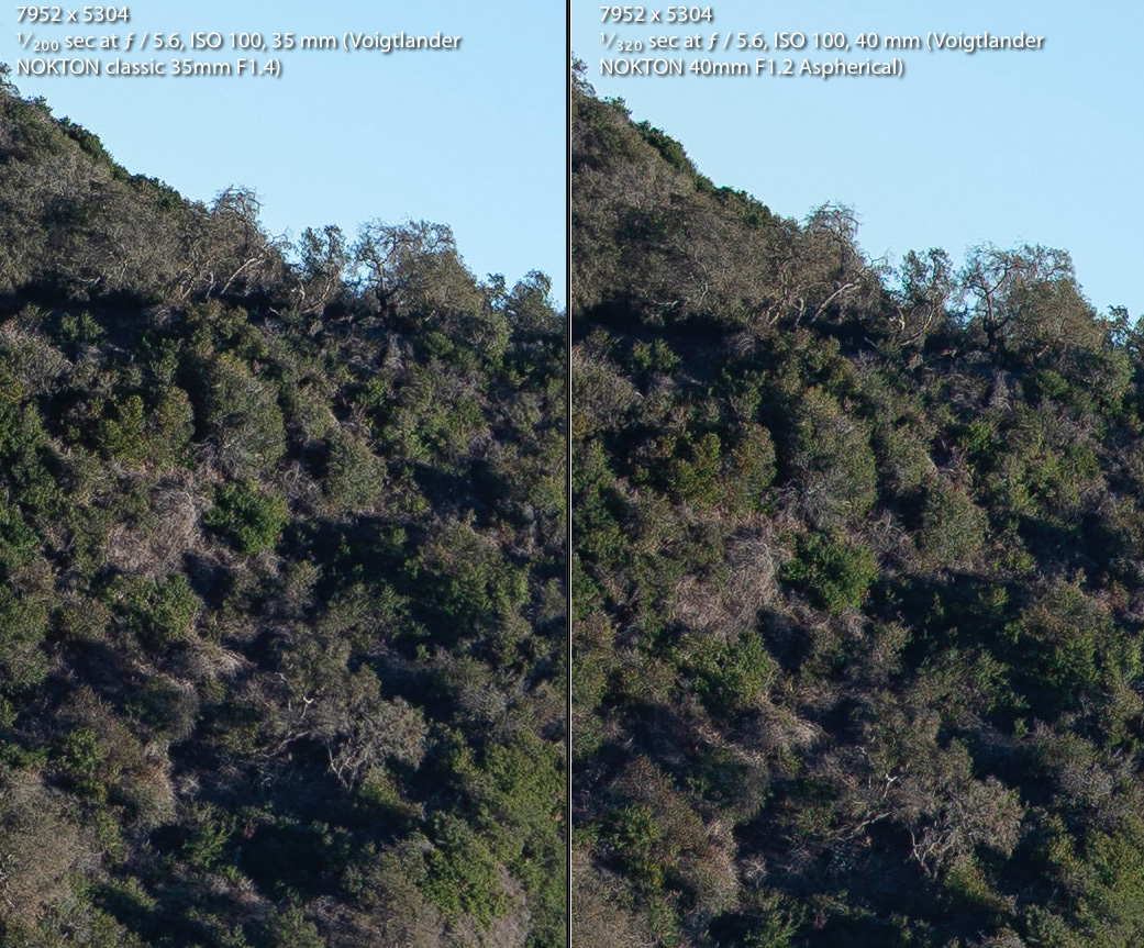

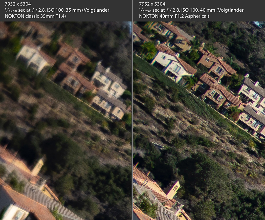

Mid-zone comparison between Voigtlander 35/1.4 Classic vs Voigtlander 40/1.2 Nokton:
Mid-zone @f/2.8: Voigtlander 35/1.4 Classic vs Voigtlander 40/1.2 Nokton - Here the 40/1.2 is clearly ahead
Mid-zone @f/4: Voigtlander 35/1.4 Classic vs Voigtlander 40/1.2 Nokton - The 35/1.4 improves greatly and they are almost equal now
Mid-zone @f/5.6: Voigtlander 35/1.4 Classic vs Voigtlander 40/1.2 Nokton - Very similar
Mid-zone @f/8: Voigtlander 35/1.4 Classic vs Voigtlander 40/1.2 Nokton - Very similar
Oct 21, 2018 at 01:05 PM

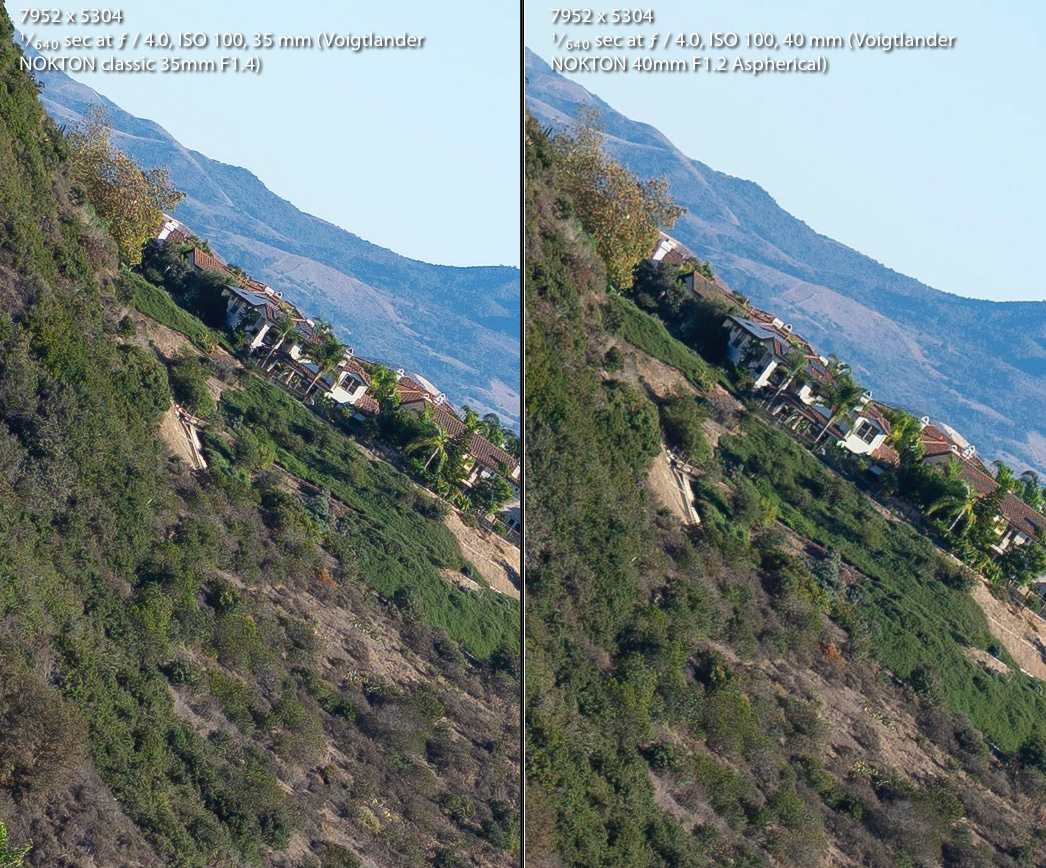

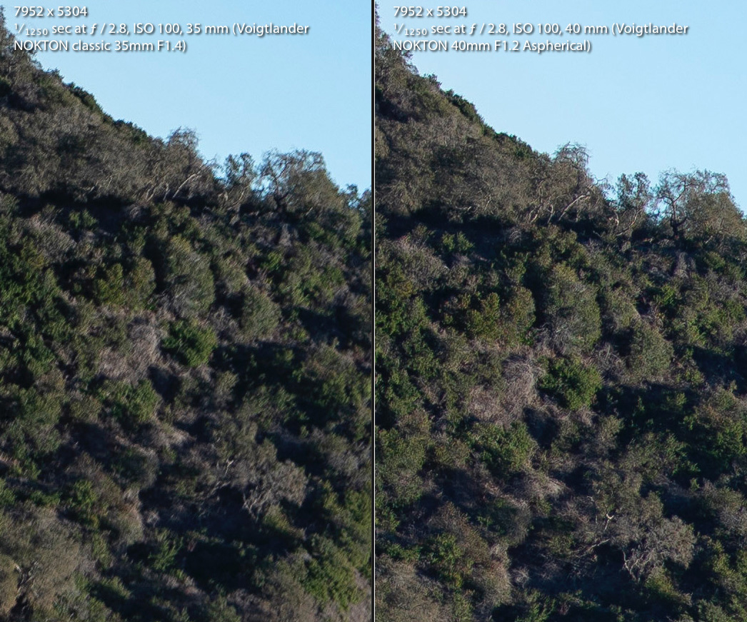

Extreme corner comparison between Voigtlander 35/1.4 Classic vs Voigtlander 40/1.2 Nokton:
Extreme edge @f/2.8: Voigtlander 35/1.4 Classic vs Voigtlander 40/1.2 Nokton - Here the 40/1.2 is killing
Extreme edge @f/4: Voigtlander 35/1.4 Classic vs Voigtlander 40/1.2 Nokton - 40/1.2 is still killing
Extreme edge @f/5.6: Voigtlander 35/1.4 Classic vs Voigtlander 40/1.2 Nokton - The 35/1.4 Classic shows some signs of live. Corners are great but extreme corners not so much
Extreme edge @f/8: Voigtlander 35/1.4 Classic vs Voigtlander 40/1.2 Nokton - The Classic improves consideratly and it's now a contender
Oct 21, 2018 at 01:06 PM

In my view, all three lenses are great choices for landscape photography when shooting at f/8 or smaller apertures. Before trying the Voigtlander 35/1.4 Classic, I wasn't even considering it but now believe it's also a great choice when packing light.
They all have great resolution, contrast, well-defined nice sunstar, great color rendering and flare resistance.
Keep in mind there seem to be some variation with all these lenses but I'm confident the ones presented here are great copies. (Tried numerous copies of the CV 40/1.2 and Loxia 35 and perhaps got lucky with the Classic at first try)

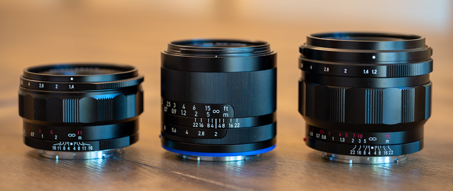

The CV 35/1.4 Classic is the smallest and lightest of the bunch weighing only 259g. In comparison, the Loxia is 332g and the CV 40/1.2 is 410g.
After reviewing these infinity crops, what's your conclusion?

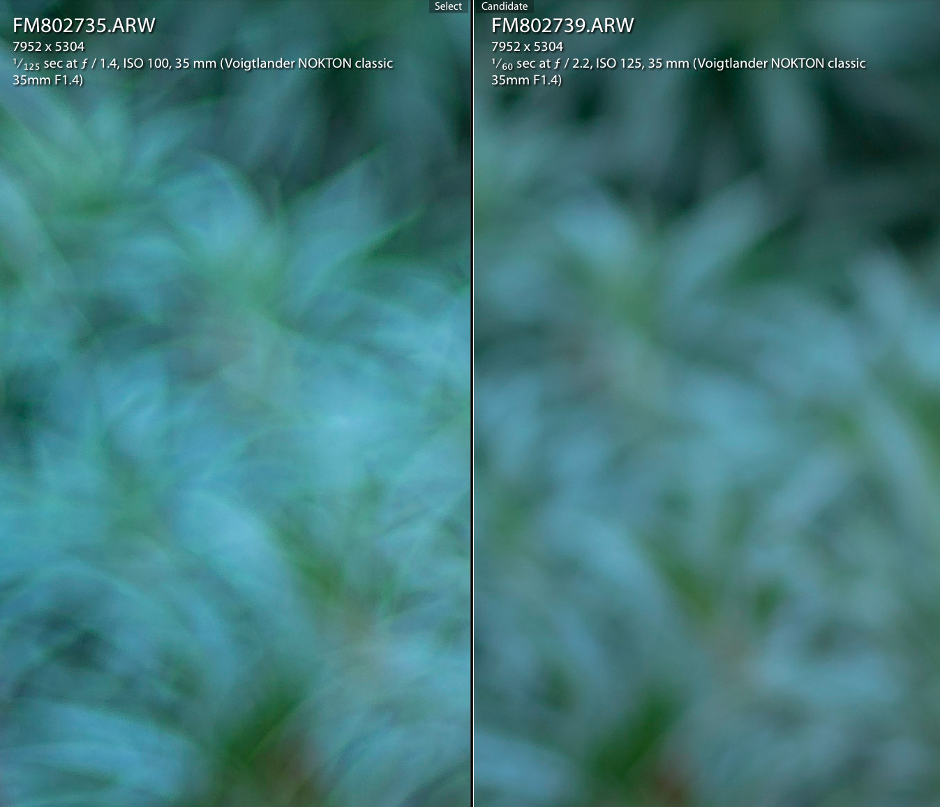

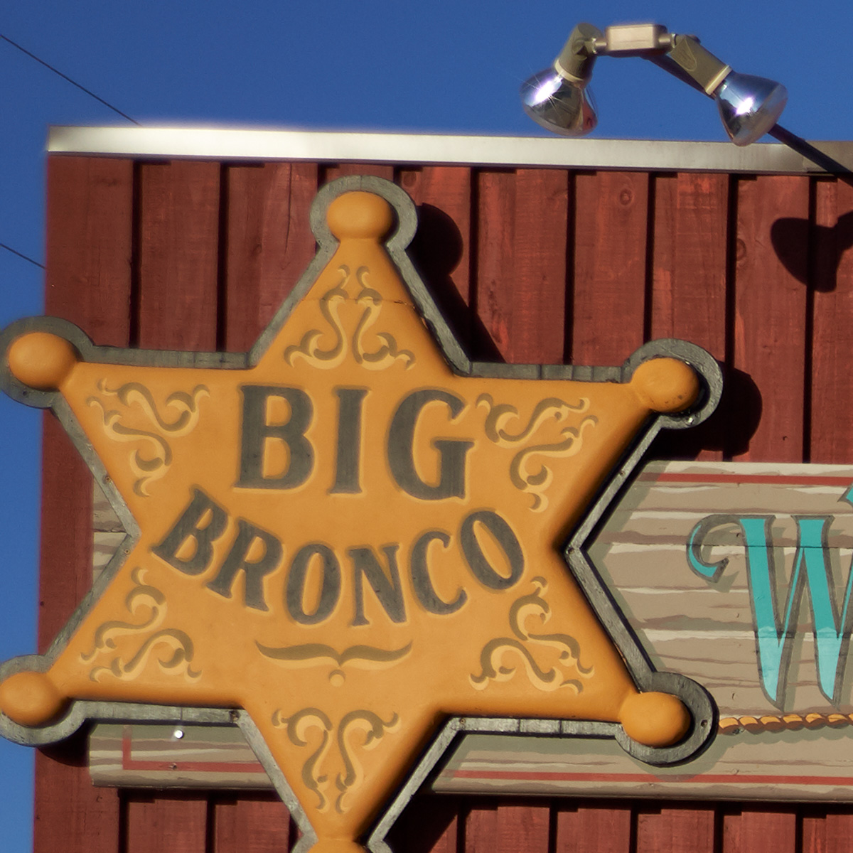

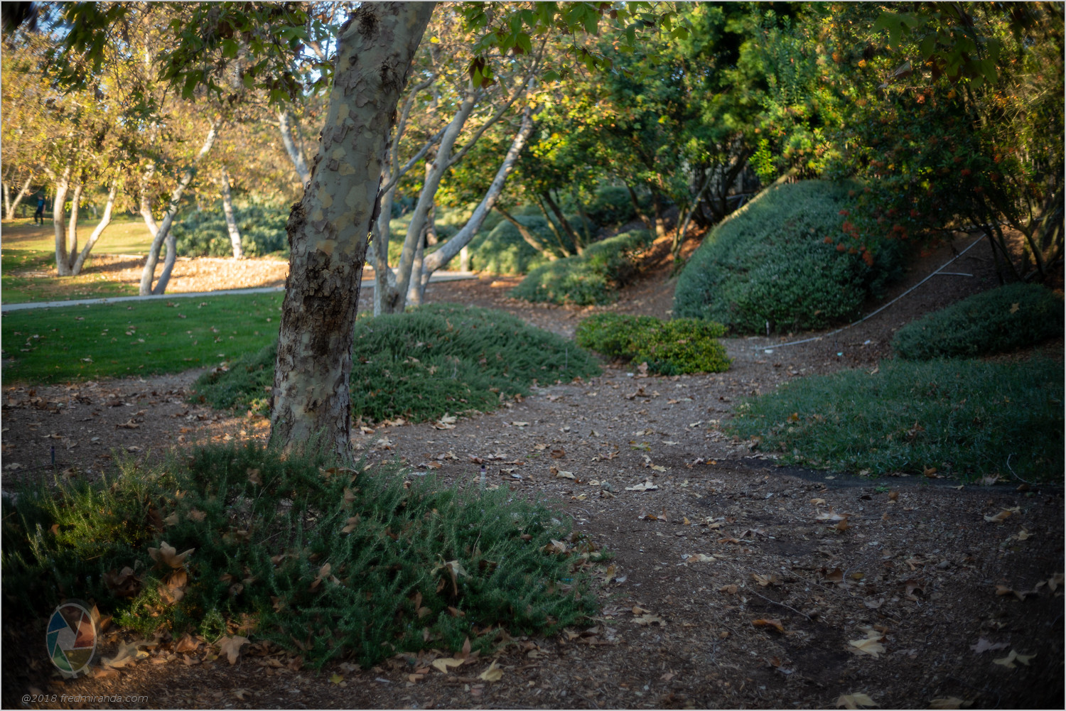

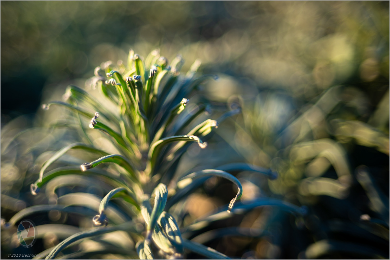

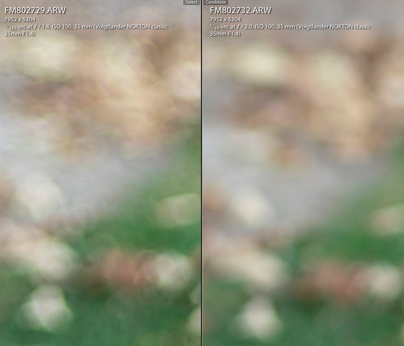

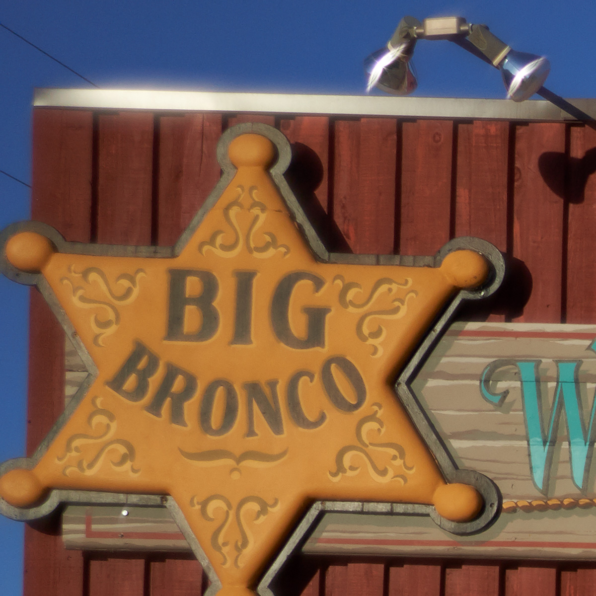

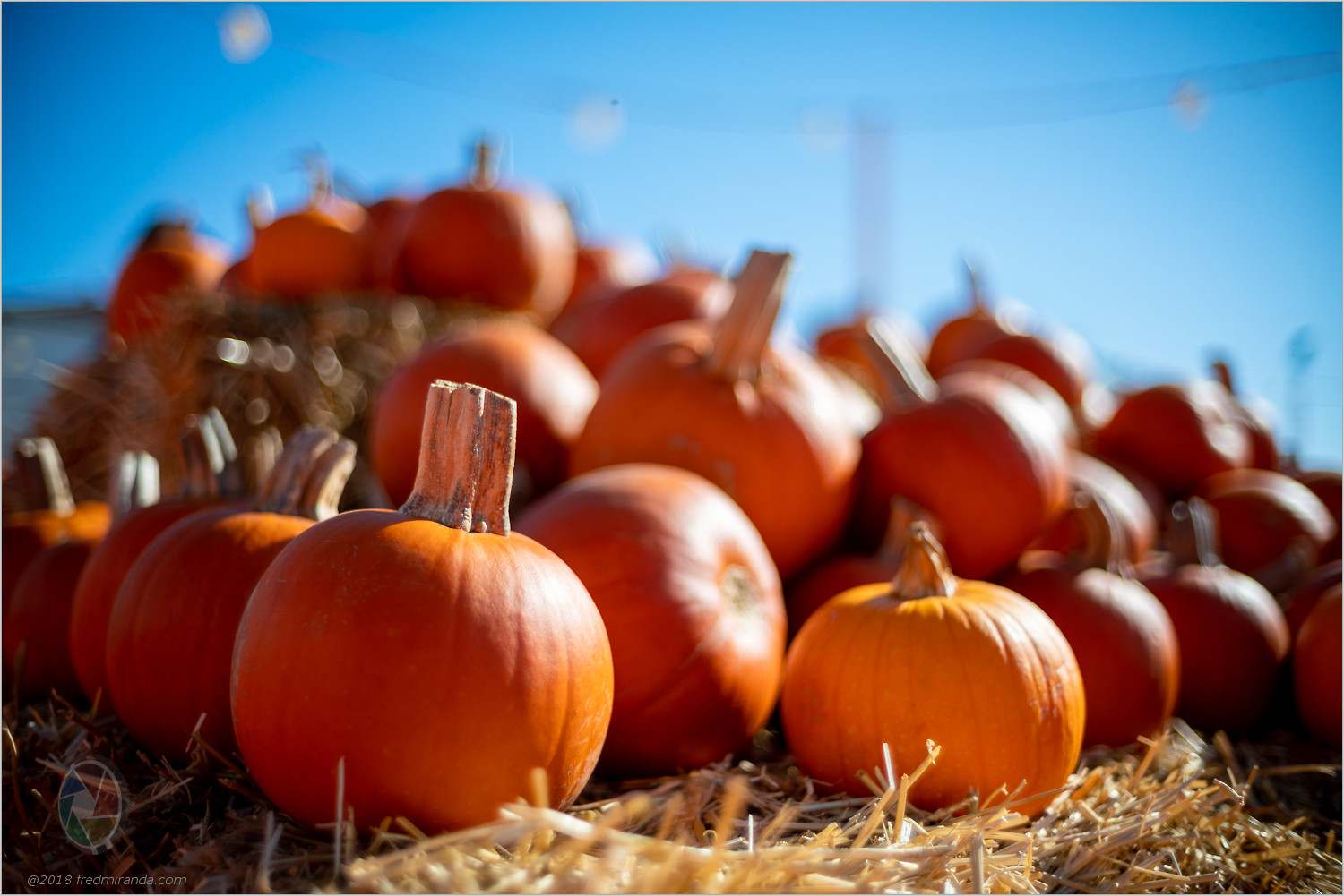

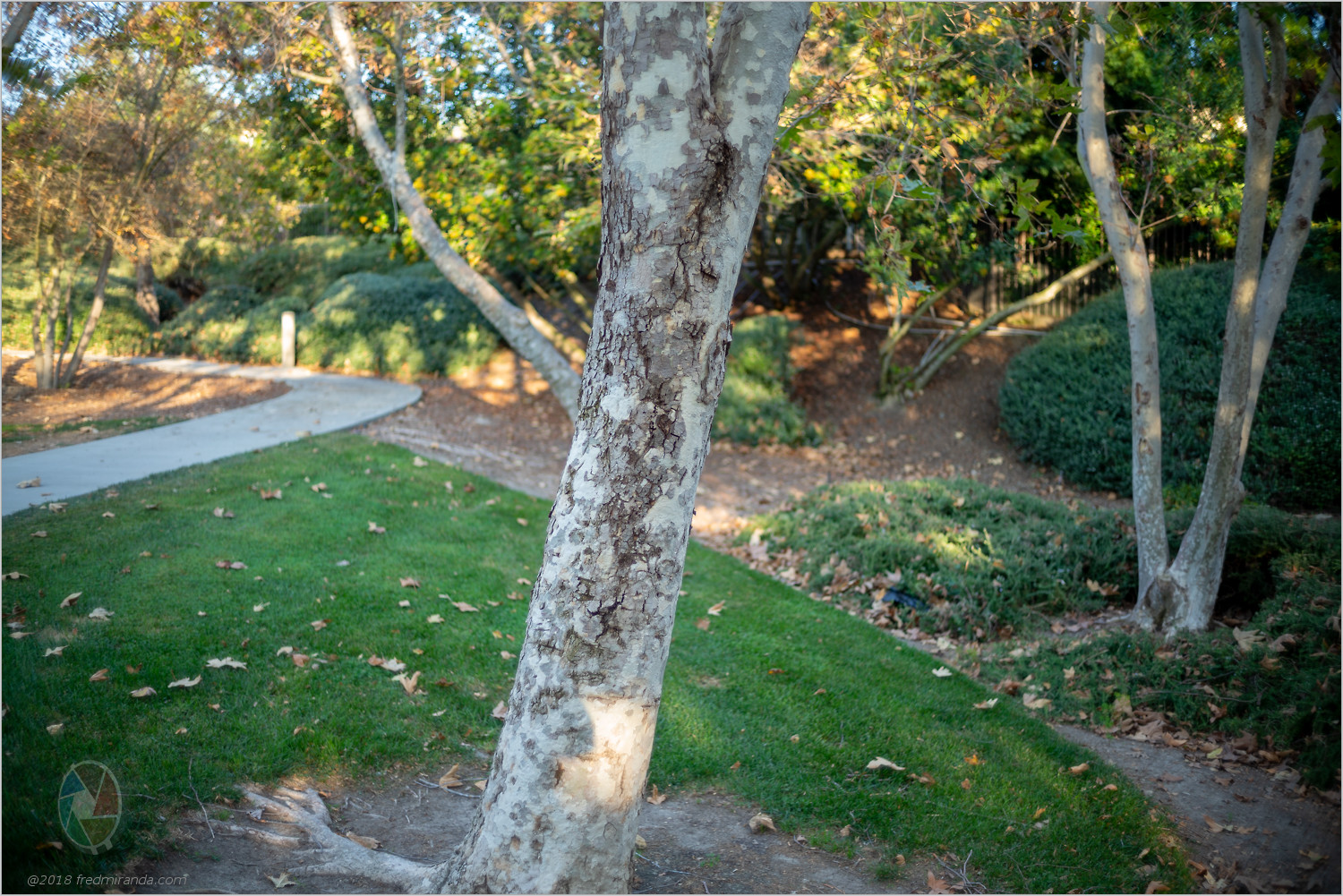

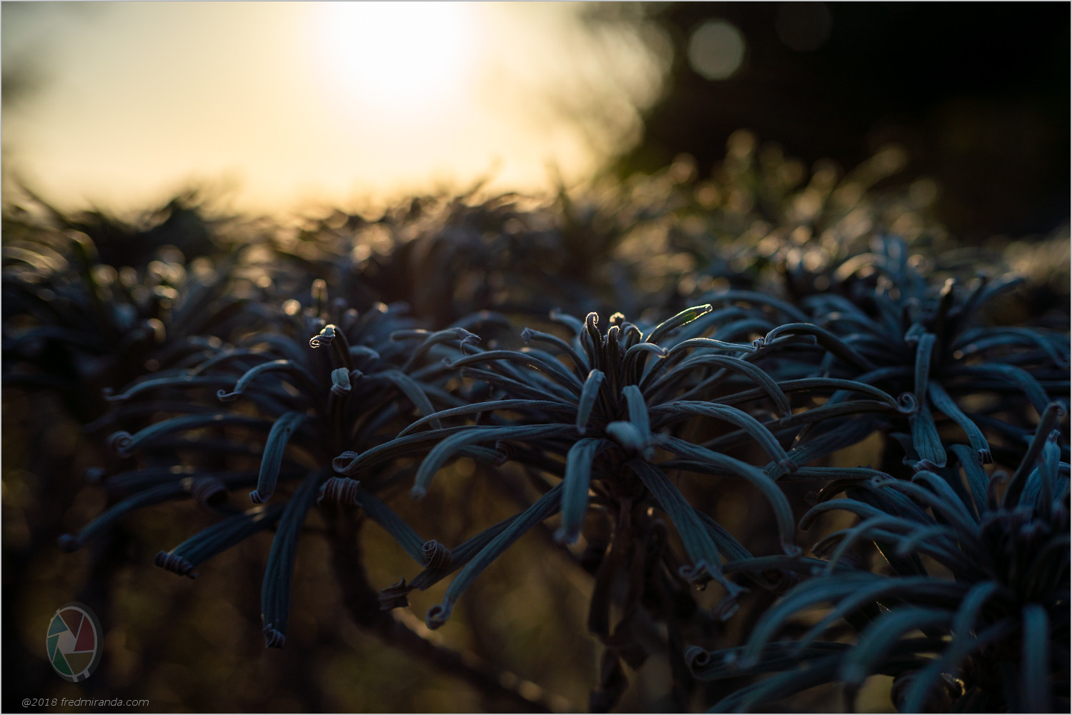

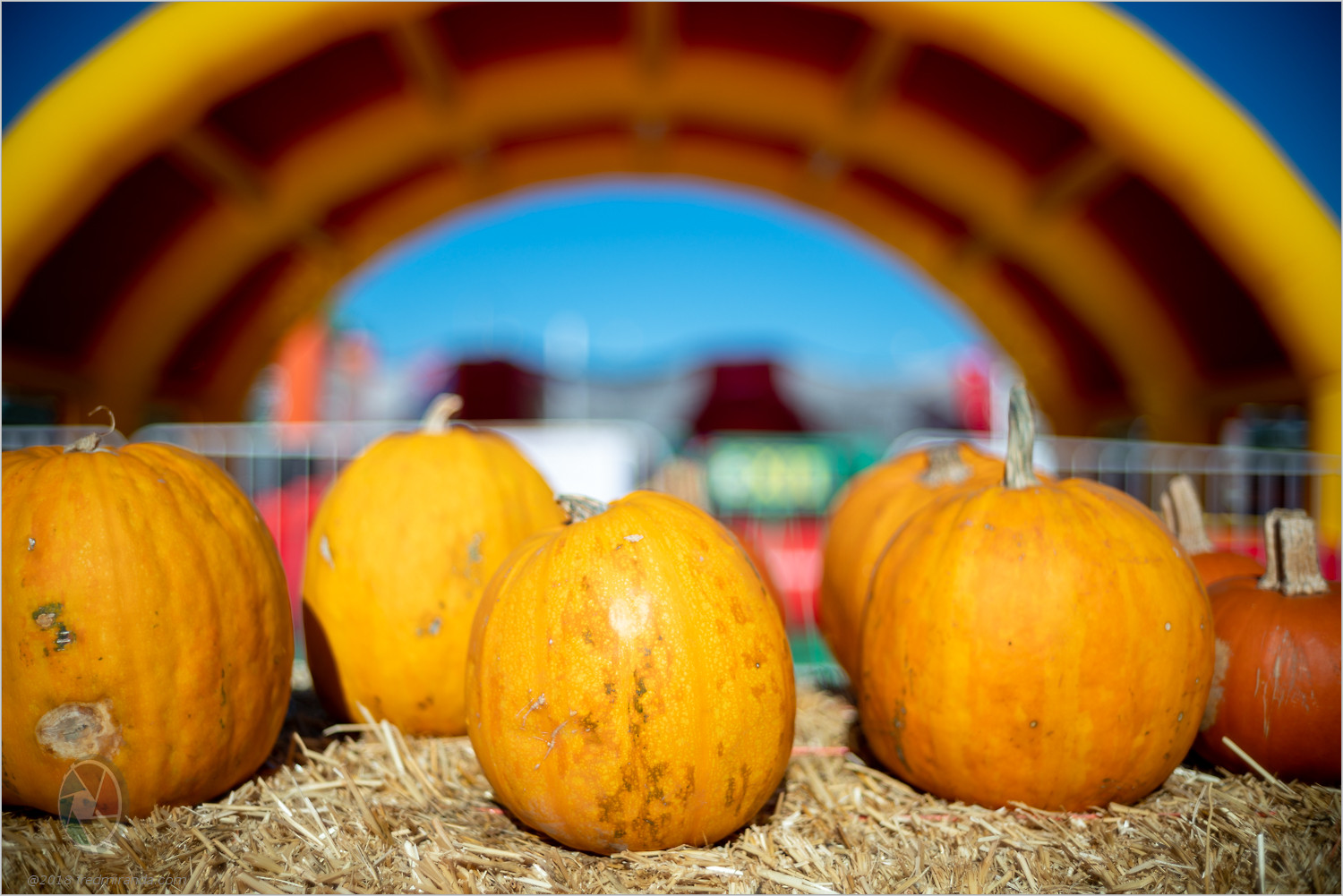

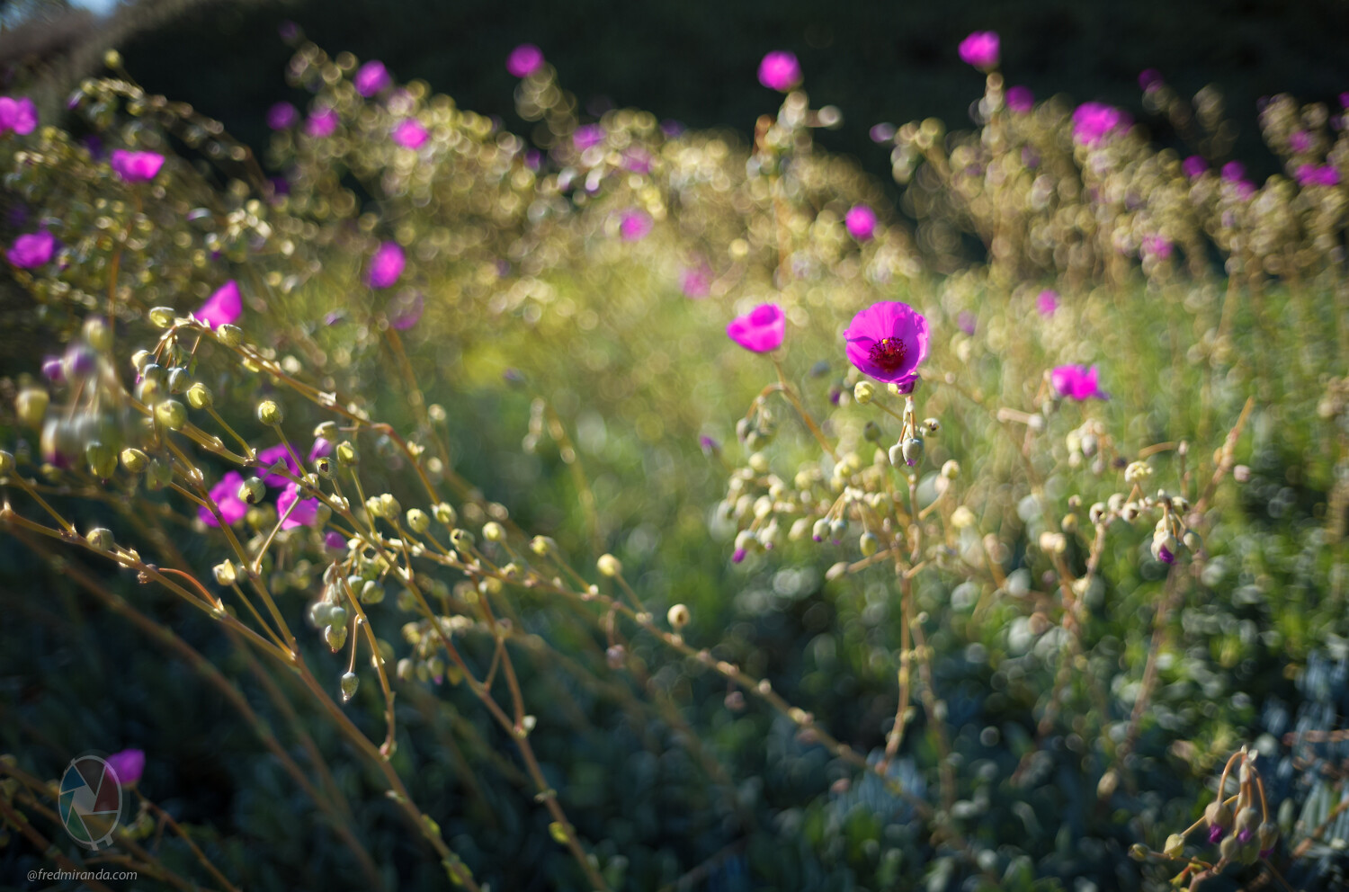

The 35/1.4 Classic can definitely be used for environment portraits but keep in mind that OOF rendering is technically atrocious.
Think about everything that most people love about bokeh rendering and this lens goes the opposite direction. It's harsh, structural, double-liney and distracting...
...Having said that, artistically, I think it has its place and love its uniqueness. It's one of the reasons I will be keeping this lens.
My iPhone can never copy that!
Here are sample samples.
Warning: If you are a bokeh purist, leave the room right now!
Oct 21, 2018 at 06:50 PM
Admin
p.1 #20 · Comparison: Voigtlander 35/1.4, Loxia 35/2 & Voigtlander 40/1.2
Few more...
