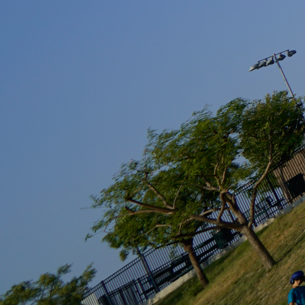

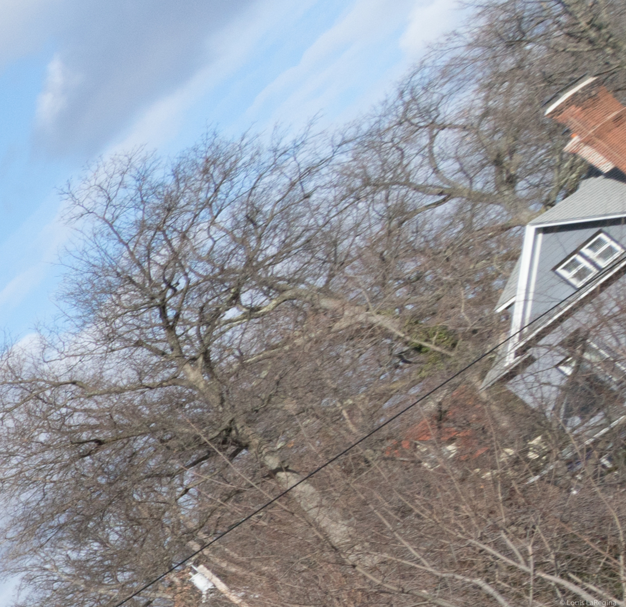

mcbroomf wroteThis is the test image I made with thew 15mm CV III M mount when I 1st got it. The link is to a 50% sized image if I recall correctly. Like Guy's, this copy seems to have very sharp corners. Taken at ~F9 on an A7R, a good distance away but not infinity. It was processed in LR with Auto CA on

Yep, still has the petals. I don't often use filters.
I forgot that there's a 2nd 50% sized image here
http://www.pbase.com/mike_broomfield/image/159611803/original

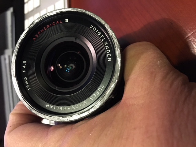

Choppy has been shipped overnight to Fred. Lol
Precious cargo
Mike
http://www.pbase.com/mike_broomfield/image/159609836/original
http://m6.i.pbase.com/g9/63/551663/2/159609836.gWcj4KEb.jpg
Thanks for posting this Mike. This is another great example of how the VC15/4.5 performs great even at the edges. The branches follow the sagittal line but still great performance.

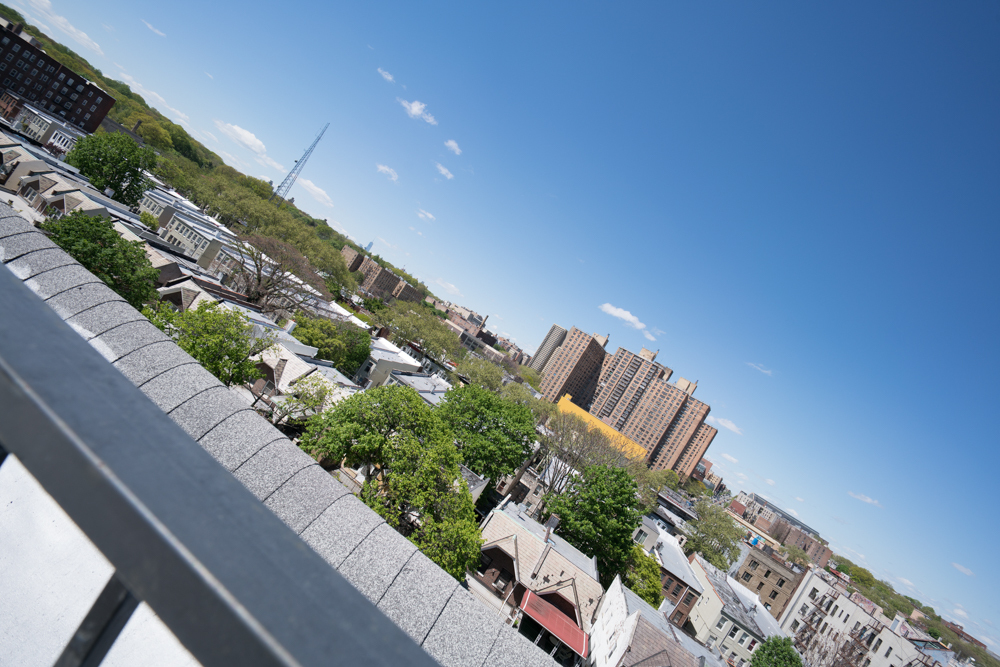

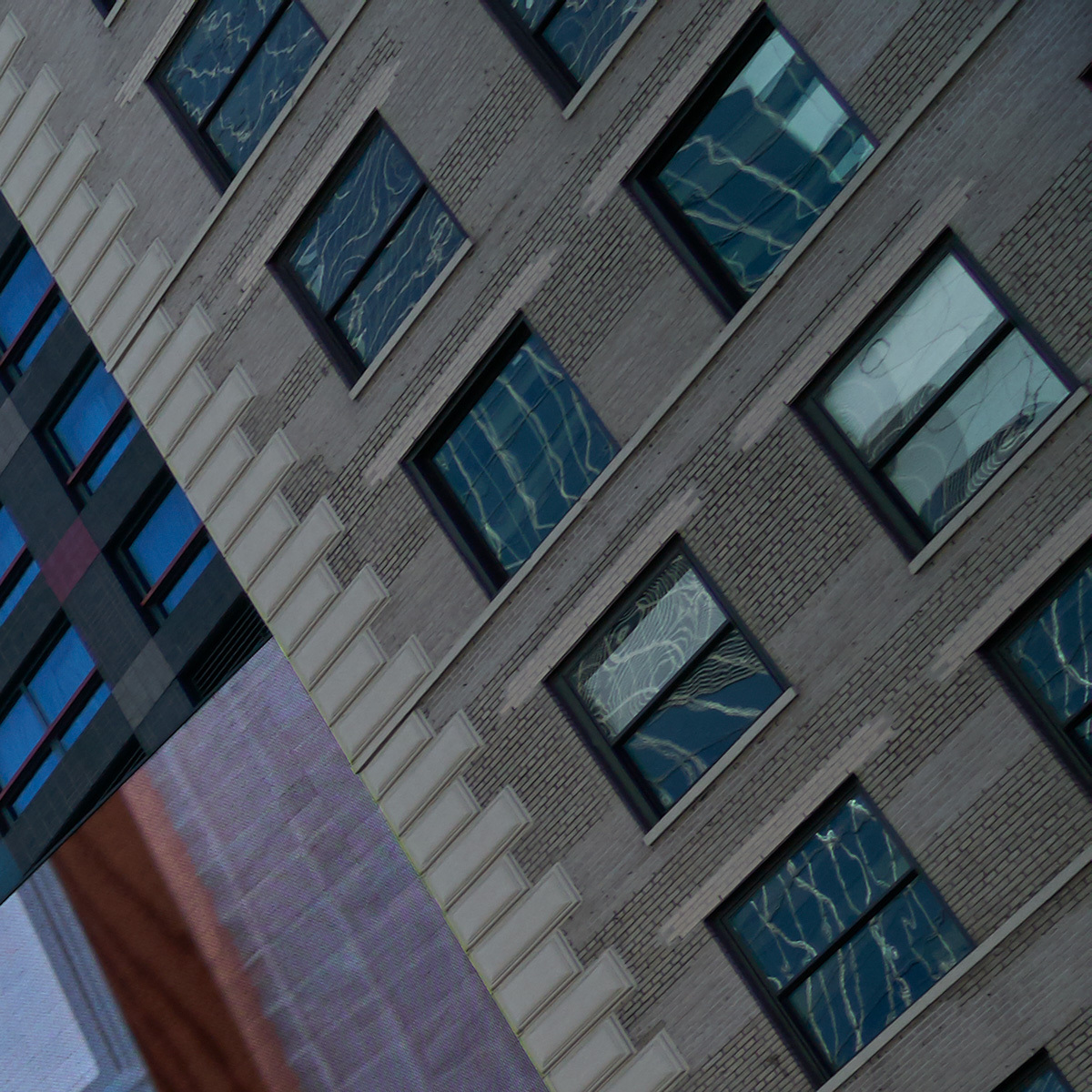

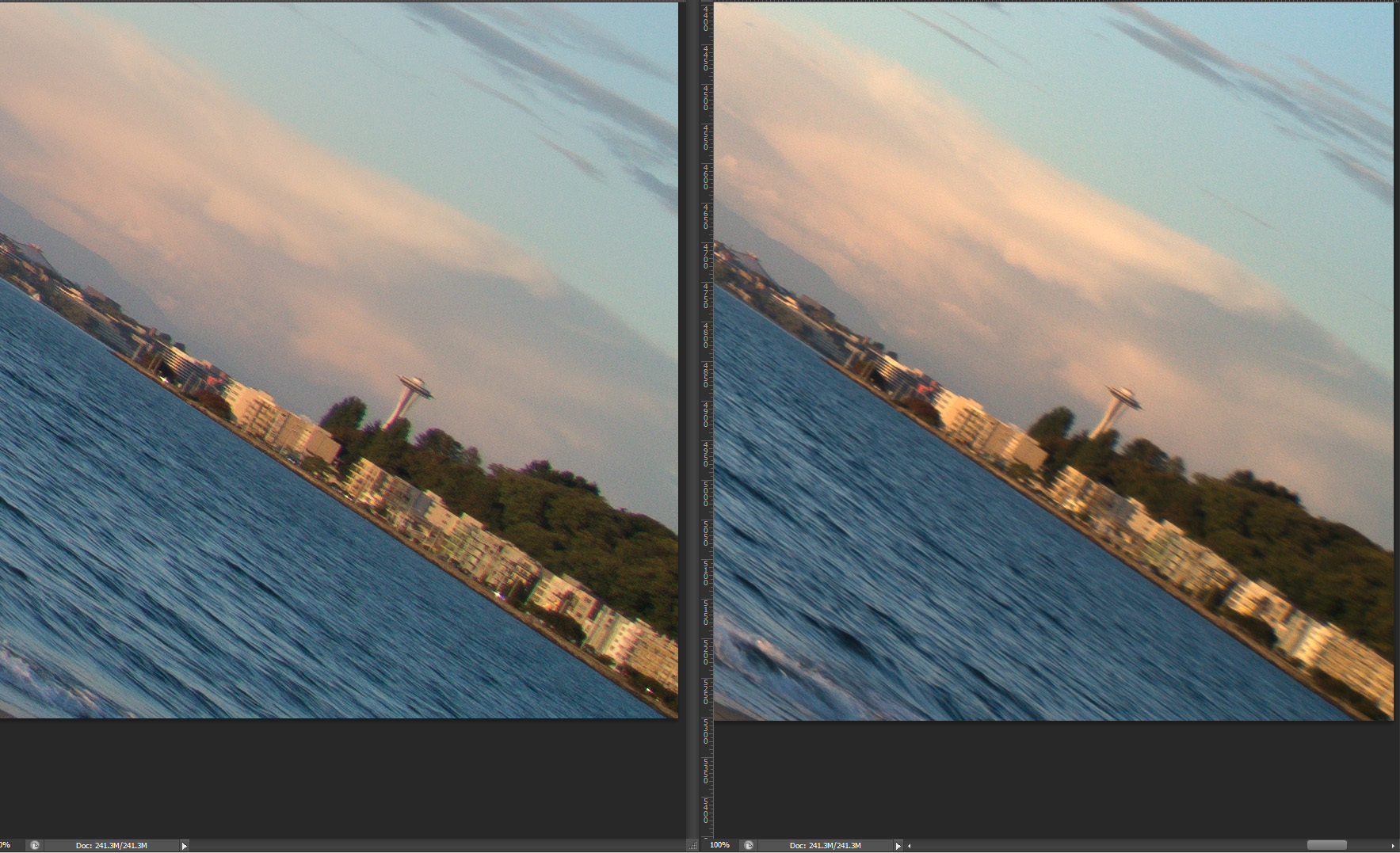

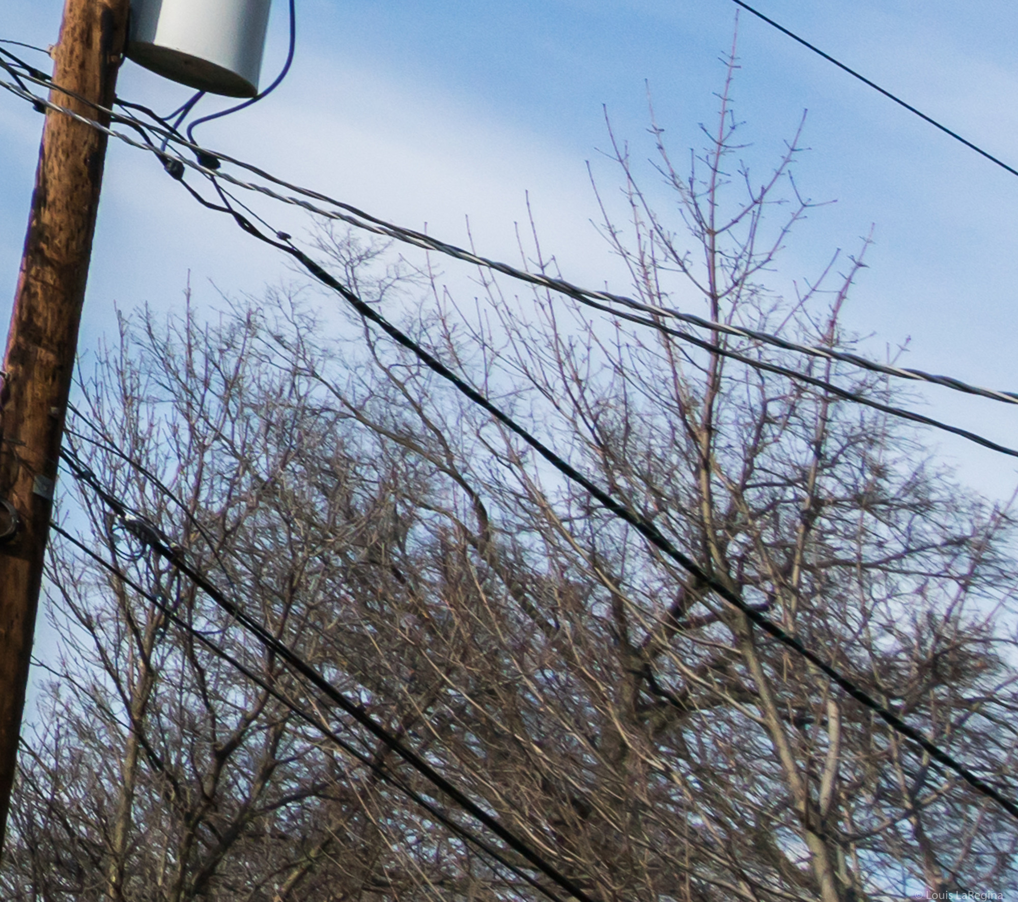

Well I found some really good Choppy images. This one just seems to put all issues out on the left wing as it looks just about what you would expect. Im in NY here , Times square and obviously not infinity but i consider a lens like this infinity after about 100 feet but thats me but check this out. Im impressed with the extreme corner. I lifted the shadows upper right corner
Apr 25, 2016 at 11:24 AM
GMPhotography
Details
p.6 #7Official: Voigtlander 15mm f/4.5 III E-mount
My guess most likely f5.6 it was fairly much in the shadows. So my point being here this is not looking like anything we are seeing out of Freds three copies he is testing. There is NO smearing i can see

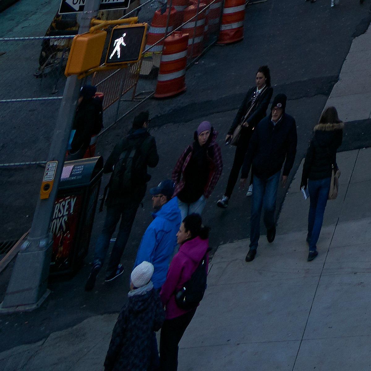

p.6 #8Official: Voigtlander 15mm f/4.5 III E-mount
If you look very carefully , I put myself in the shot.

p.6 #9Official: Voigtlander 15mm f/4.5 III E-mount

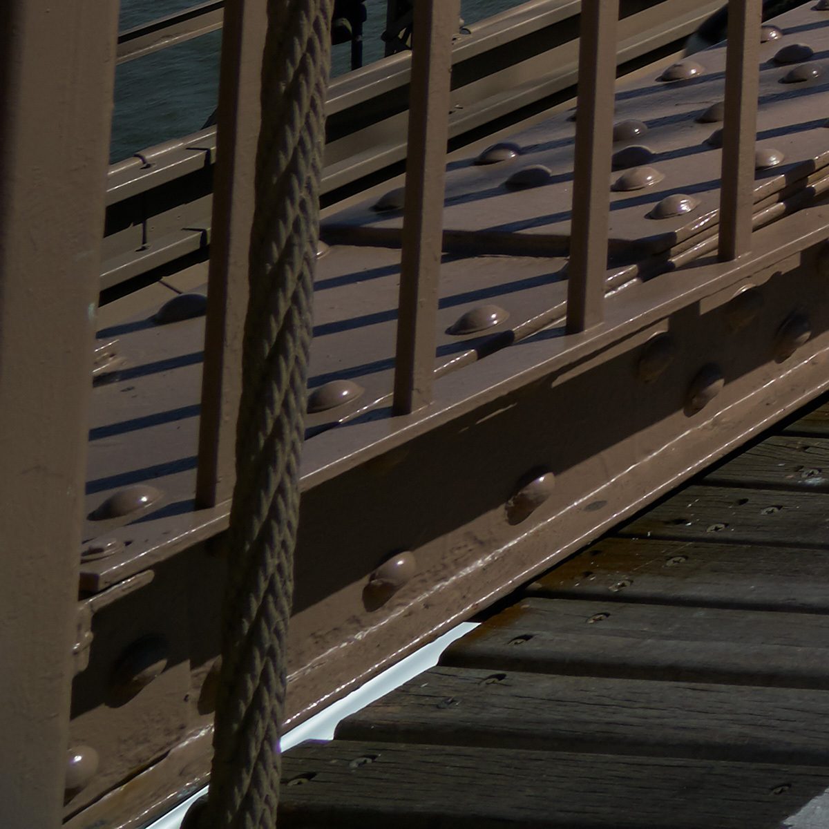

Brooklyn Bridge. Bottom left. My guess F8

p.6 #10Official: Voigtlander 15mm f/4.5 III E-mount
More. Lower right

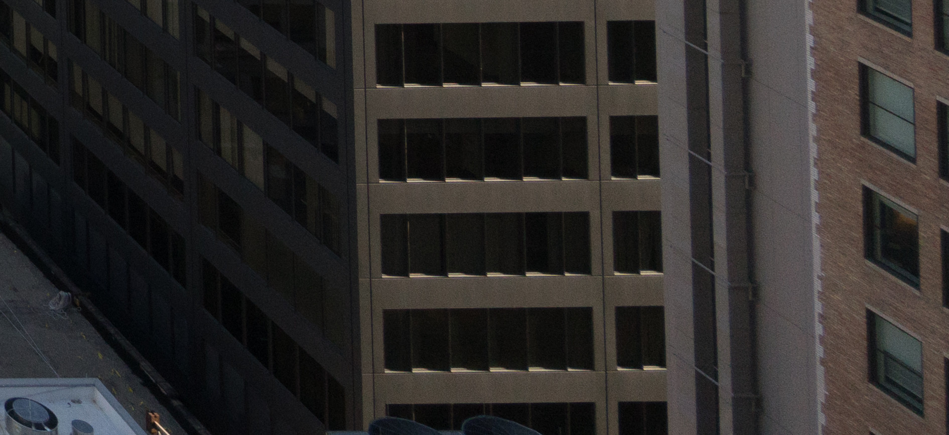

p.6 #12Official: Voigtlander 15mm f/4.5 III E-mount

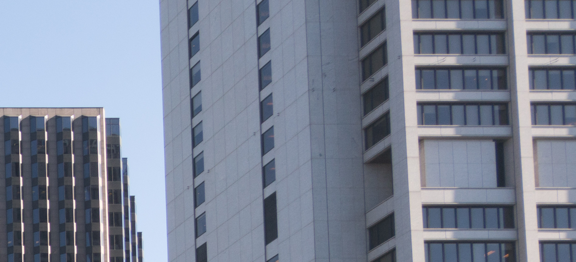

Another sample. Okay this is maybe a 50 story building. Thats Infinity.
Upper left than lower left and i really lifted the shadows. Thats pretty darn good
Apr 25, 2016 at 11:58 AM

p.6 #13Official: Voigtlander 15mm f/4.5 III E-mount
Well don't want to bore anyone anymore but as you can see it can do extreme corners. Im hoping Fred can see where the issue is on his testing with this versus the copies he has. Im baffled myself. FYI mine is less than a year old and bought it new from Cameraquest

p.6 #19Official: Voigtlander 15mm f/4.5 III E-mount
The last crop on bottom left with the street corner is a dead giveaway there is no smearing going on. I can see the cracks in the sidewalk. so there is no blurring at all.
Apr 25, 2016 at 12:46 PM
Phillip Reeve
Details
p.6 #20Official: Voigtlander 15mm f/4.5 III E-mount
There is clearly quite a bit of astigmatism in the upper left corner and the lower left one isn't a very good target to judge it because the structures are mostly saggital
Apr 25, 2016 at 12:52 PM
