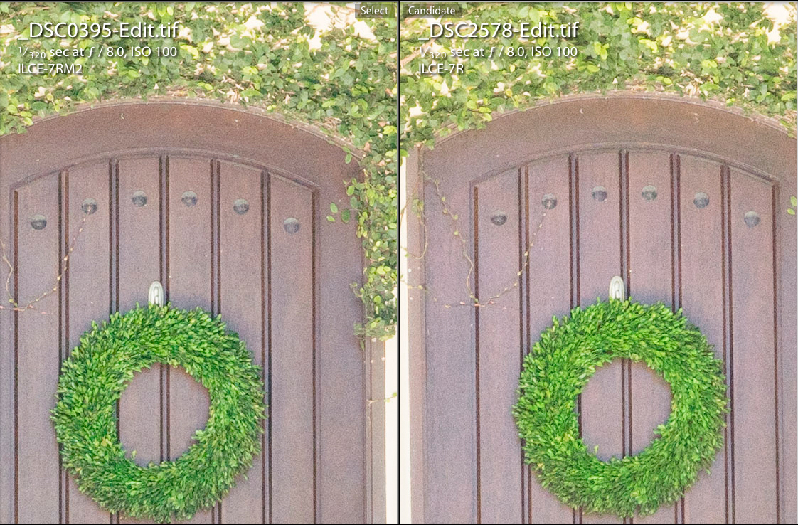

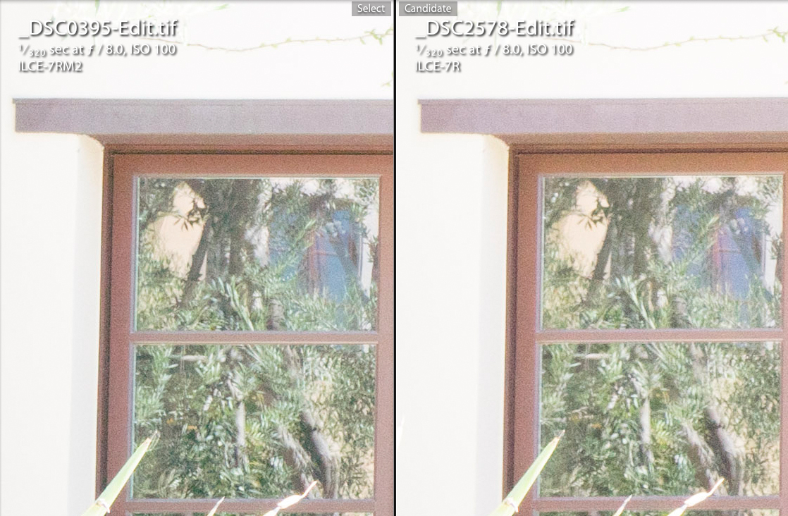

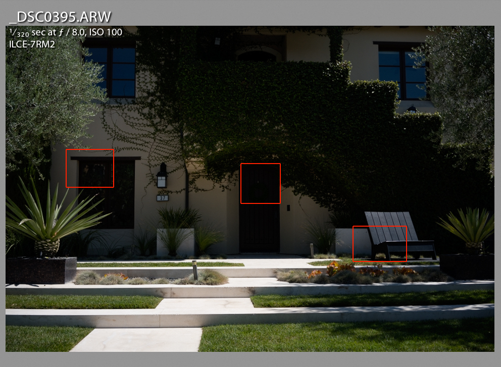

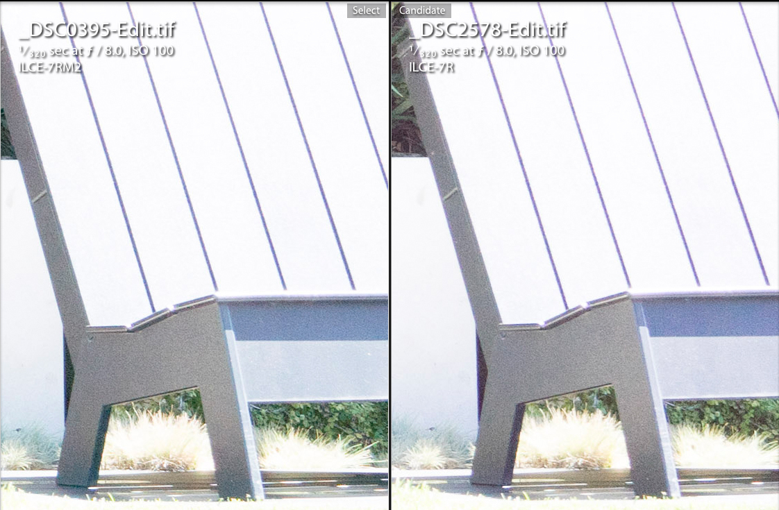

Today I started testing the new Sony A7RII against the A7R and have not seeing much difference in DR (shadow recovery) between them at base ISO.
Update: Also check A7RII vs A7R HIGH ISO test here.
Here is a sample from an image that was exposed to the highlights (underexposed about 1 1/2 stops) and then pushed 5EV in Lightroom. The A7RII image was downsample to 36MP using bicubic.
All exposure settings and histogram were identical
Lens compensation set to OFF
Steadyshot set to OFF for the A7RII
White balance set to Daylight
Exposure: 1/320 f/8 ISO 100
Lightroom Default settings
Lens used: FE 35 f/2.8
See the crops below and let me know what you think.

A7r looks very close on my screen the colours look slightly different

The A7RII seems to have a bit more contrast. Fred, I think the advantage is in the high ISO region, especially past ISO 800, where the A7RII switches to a different signal converter to gain more DR/SNR. Base ISO 100, I suspect the A7RII would be same as the A7R and D810.

Look very close to me Fred. A7RII has a better colors it seems but DR looks similar. Thanks for the test!

I see less purple fringing and slightly more cyan fringing on 7r2 ...

A tad more detail and a tad more contrast to the A7rII

They look pretty close on my display (iMac 2012 & macbook 12"). I thinkk the A7RII shows a little bit more details in last picture.

This was a shadow recovery noise test though. It's likely the A7RII would show even more detail if I would upsample the A7R 36MP image to 42MP and compare both.

I did not check to see which is which, but they do look close. I feel like the examples in the left column may show ever so slightly more noise, but it is hard to tell.
