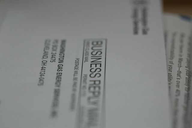

RE: focus adjustment: Bottom line first -- it works. I adjusted focus of my 80mm. See results below. Again, this is nothing scientific. I didn't mount the camera onto a tripod, and the purpose is just to provide proof of concept to show it can be done, and I'm happy to say that it generated good results. The process to micro adjust the focus, as described in the Chinese website, may sound overwhelming at first. But after doing it a couple of times, it is quick to get the hang of it, and it is really not compliated at all. It's a time-consuming trial and error. Sometimes I was not sure whether or not a new number I entered would actually overwrite the previous number setting. A good practice that I found, in my limited time of testing, is to always erase the previous number setting before entering a new one. Also, power off camera and un-mount adapter with lens each time an old setting is erased, and a new setting is entered. This "reboot" really eliminates uncertainties in this tedious exercise, and I found it very helpful.
80mm before adjustment. Focus was on E in BUSINESS.
80mm after adjustment. Focus was on E in BUSINESS.
Example of wrong lens name. This is rare and can be prevented.
120mm focus is right on. Focus was on E in BUSINESS.
Edited on Apr 21, 2014 at 08:26 AM · View previous versions

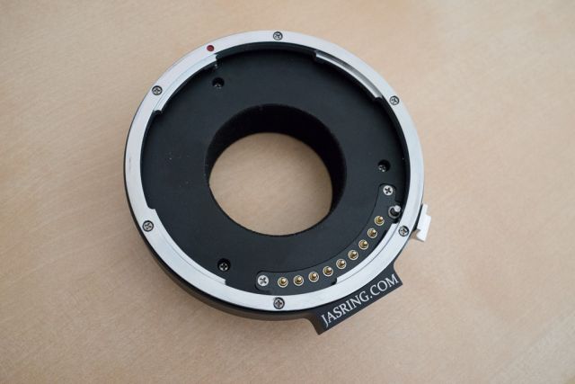

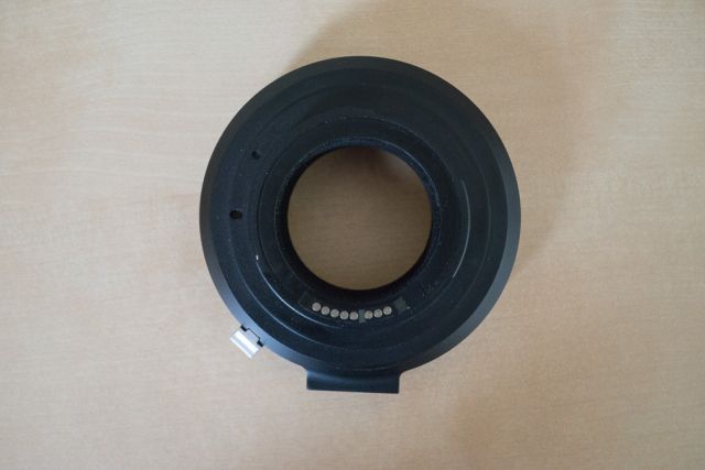

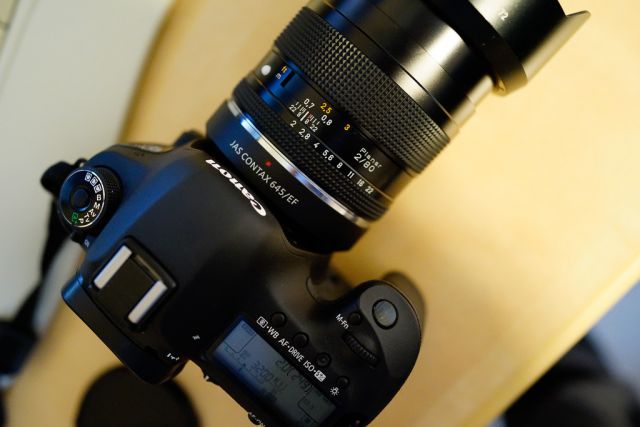

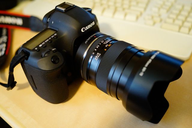

Images of the adapter itself and on my Canon 5D3. It looks very good.

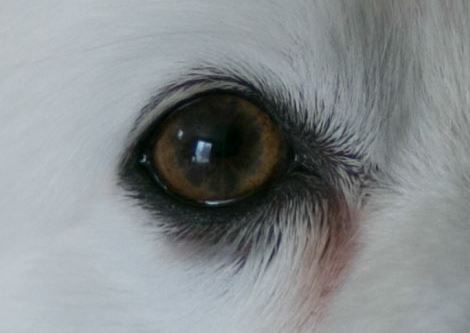

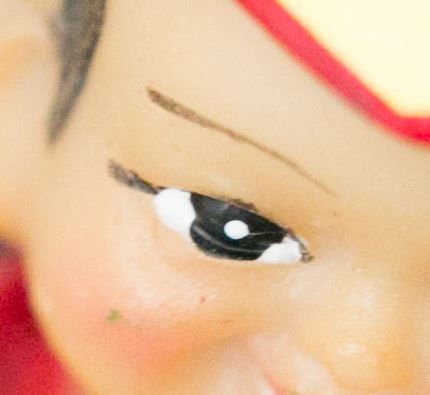

A couple of shots to show focus accuracy using the adapter. 140mm was auto focus, and 120 was manual focus. These are unedited RAW images.
After edition in LR5, images will look much sharper, more than acceptable to my eyes.
140mm unedited RAW. Focus was on the right eye of the dog.
140mm unedited RAW. Full size of the focus point.
120mm unedited RAW. Focus was on the right eye of the monk.
120mm unedited RAW. Full size of the focus point.

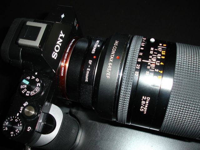

Exciting update:
The vendor released v.2 of this adapter, adding compatibility with Metabones adapter that you can mount on Sony A7/r. I sent my apdater back to the vendor for a free firmware update, and it came back half an hour ago.
Now I can use Contax 645 lenses on Sony A7/r.
Focusing is slow, similar to other Canon EF lenses on A7/r, but fairly accurate.
My set up is: Contax 645 lens -- JAS Contax 645/EF adapter v2 --Metabones v3 EF-E Mount adapter -- Sony A7r. I will do more testing with this combo later and post an update with pictures.
Also exciting: The vendor came up with a Contax 645 to Nikon adapter. For the 5 minutes I played with it, it's just like using a native Nikon lens. Focus is very fast and accurate on my D800E. I will start a separate post later when I test it more.
