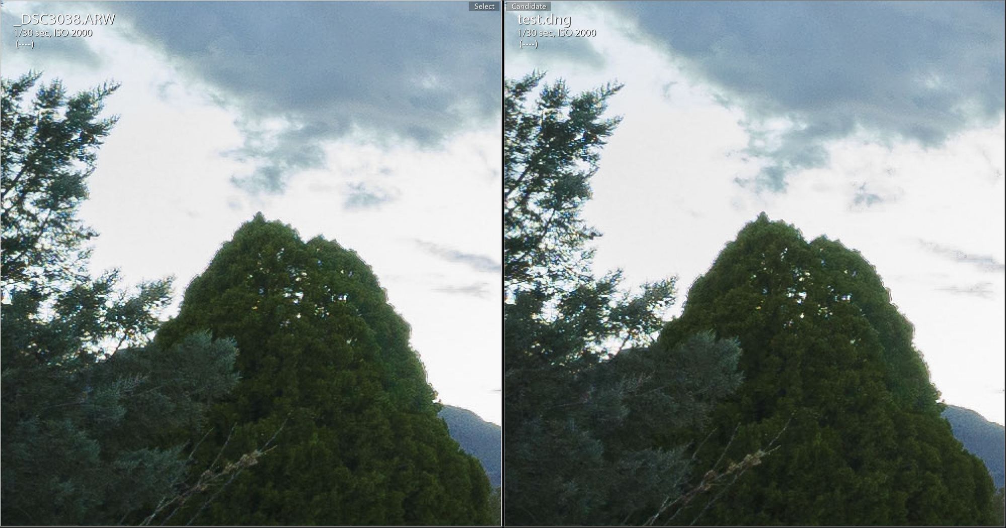

Thank you Hank. Welcome to FM. I tried KARWY, but the artifact is still there. I left all of the sliders at 0 so that might be the reason. But if you can chime in that would be great.
Sep 26, 2015 at 10:34 PM
hankd
p.6 #20 · Lossless RAW files from the Sony A7/A7R?
If the artifact you're talking about is the double line around the tree, that's not in the raw data -- neither the ARW2 nor the repaired version. Looks like a bad implementation of some algorithm in whatever tool you used for the final processing....
From the server, I can show you the real artifacting in this image. It isn't much, but there are the usual "Blondie artifacts": horizontal parallel line artifacts in various places in the ARW2, and gone from the KARWY version even with 0,0,0 smoothing:
http://aggregate.org/DIT/KARWY/karwytreeoops.jpg
Note that KARWY has also enhanced the texture of the trees slightly -- that's a natural side-effect of the texture synthesis, which is applied throughout the entire image in proportion to the size of the pixel value uncertainty.
Sep 26, 2015 at 11:26 PM
