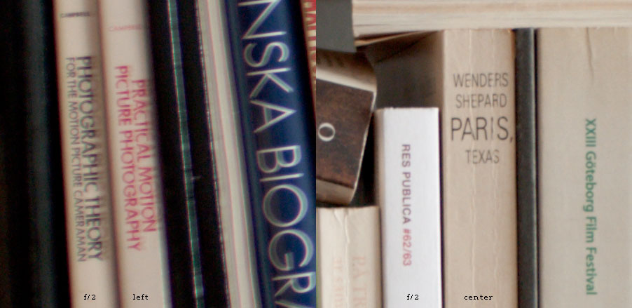

Most (if not all) 4/3 sensors have filter assemblys on top of the sensor that are quite a bit higher than the pixel wells are wide - they don't take to well to fast glass and WA's that project light onto the sensor with an angle. They prefer to be "struck" from a 90º angle. There's a very solid reason why the 4/3 consortium recommends a maximum ray angle of 10º on to the sensor. That's roughly the angles that a F/1.8-lens gives you... :-/
Angles higher than this gives high pixel crosstalk, and as a result from this - low colour accuracy and low pixel-to-pixel contrast.

Yes, that's the problem we have seen with many WA rangefinder lenses on the G1.
Here is a CV28/2 Ultron sample, first the scene:
and then a combined crop, left and center:
(Imageevent seem to be slow today)
Now that is wide open and you may not care about anything but the center wide open. The problem doesn't go away until stopped down to f/5.6 and then there still was some CA there.
