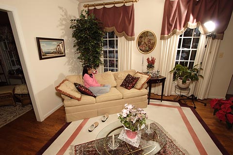

In the shot above the slave flash was on the stage out of frame to the left and I had opened the top flap of the diffuser on the bracket and was bouncing most of the fill off the high 30' ceiling. No problems with signaling. It's just a matter of understanding how the equipment is designed to work and finding ways to work within those design parameters.
