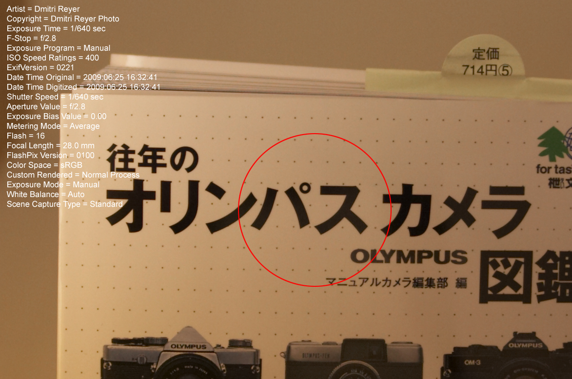

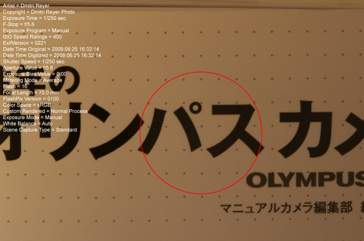

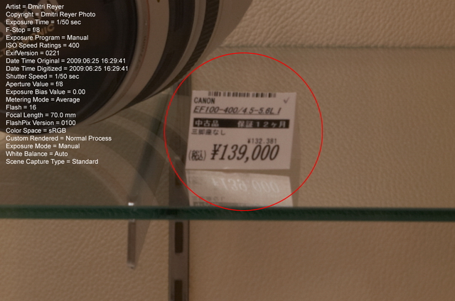

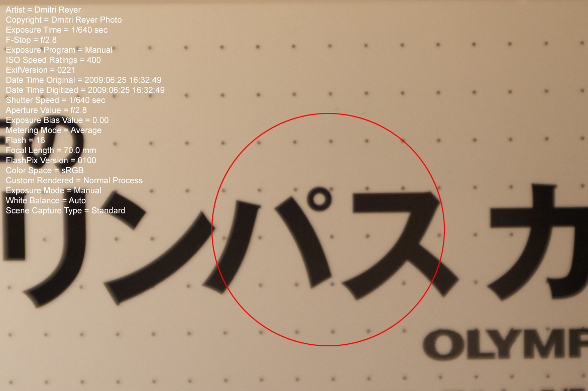

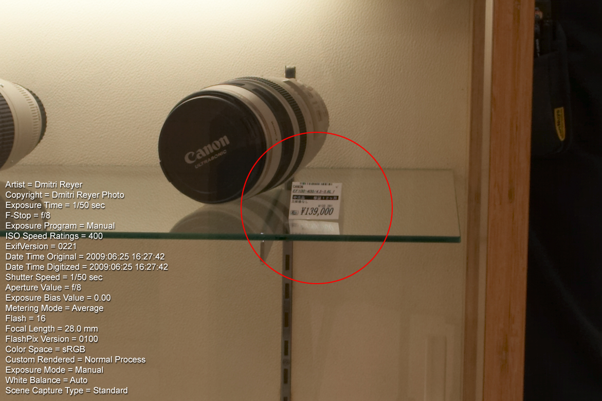

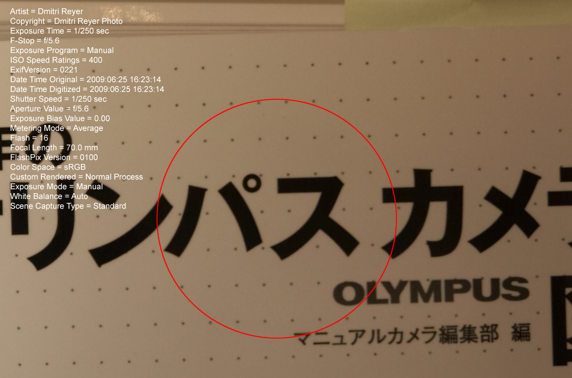

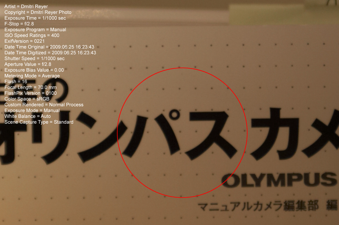

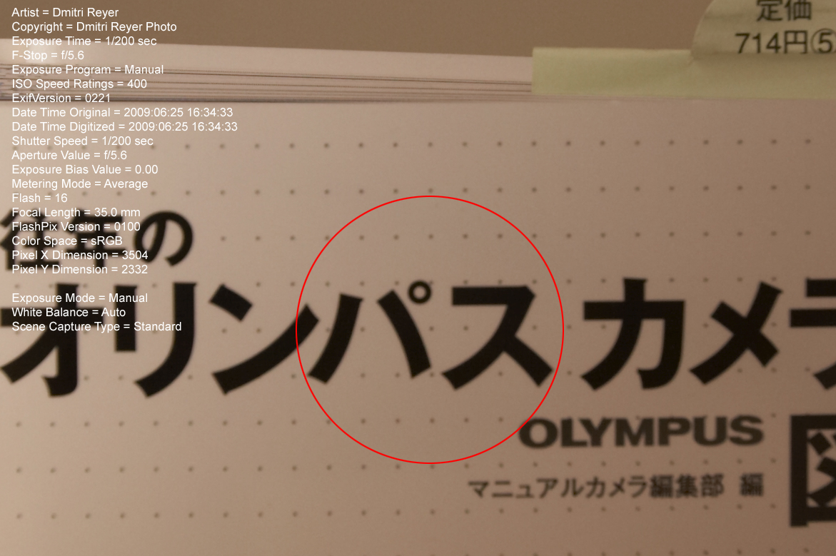

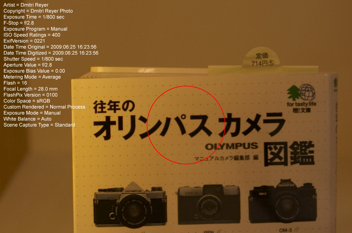

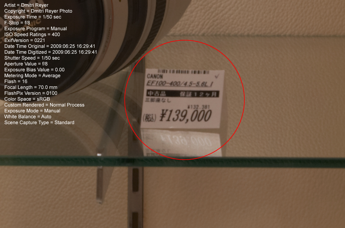

I have previously posted a topic where I asked 24-70mm F2.8L owners to post some reference images.
I have also been reading some reviews and it seems that 28-70mm F2.8L is a great lense.
And so I ventured to a local 2nd hand camera store to have a look.
All shots are tested at opposite focal ends, ie 28mm and 70mm at F2.8, F5.6 and F8.
Tests done on 2 different lense copies. EXIF is in the images. Focus area is indicated by the red circle.
F8 shots are taken at a rather low shutter speed, however store attendant kindly provided a tripod for the test. Other shots are handheld while resting elbows on a table. Shutter speed was adequate enough to minimise the motion blur.
I tried to take the shots as consistently as I could.
The images in the post are 640x480 resizes of the centre 3x3 with the link to 1:1 under each image.
No post processing except CaptureOne default noise reduction setting.
First up, 28-70mm F2.8L Copy Nr.1
F2.8 @ 70mm
100% 1:1
F2.8 @ 28mm
100% 1:1

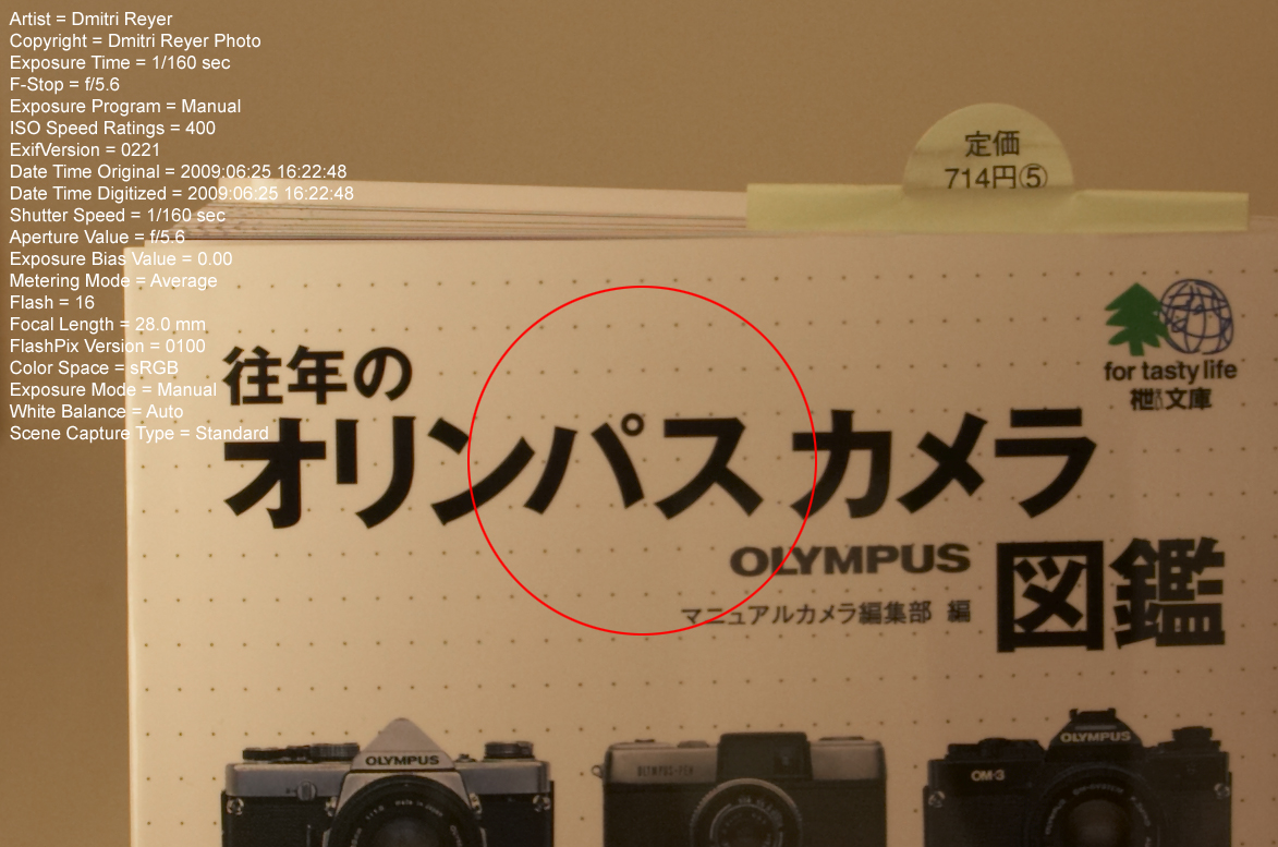

F5.6 @ 70mm
100% 1:1
F5.6 @ 28mm
100% 1:1

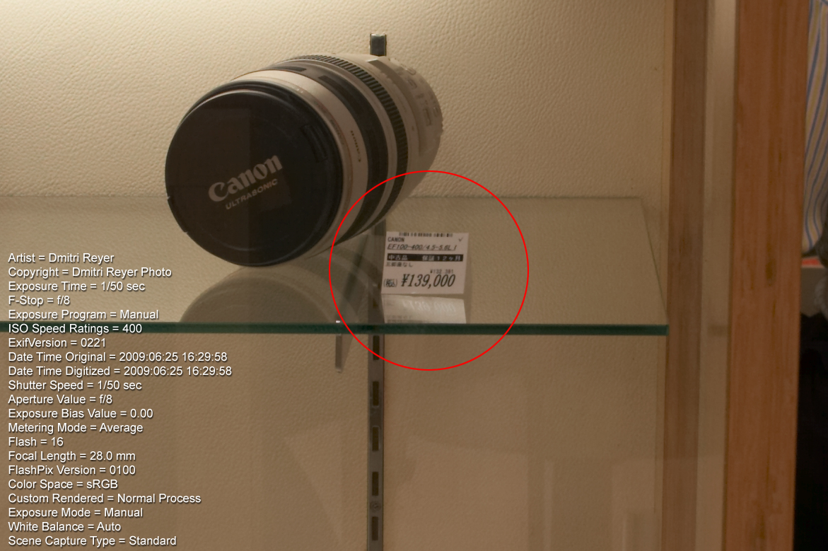

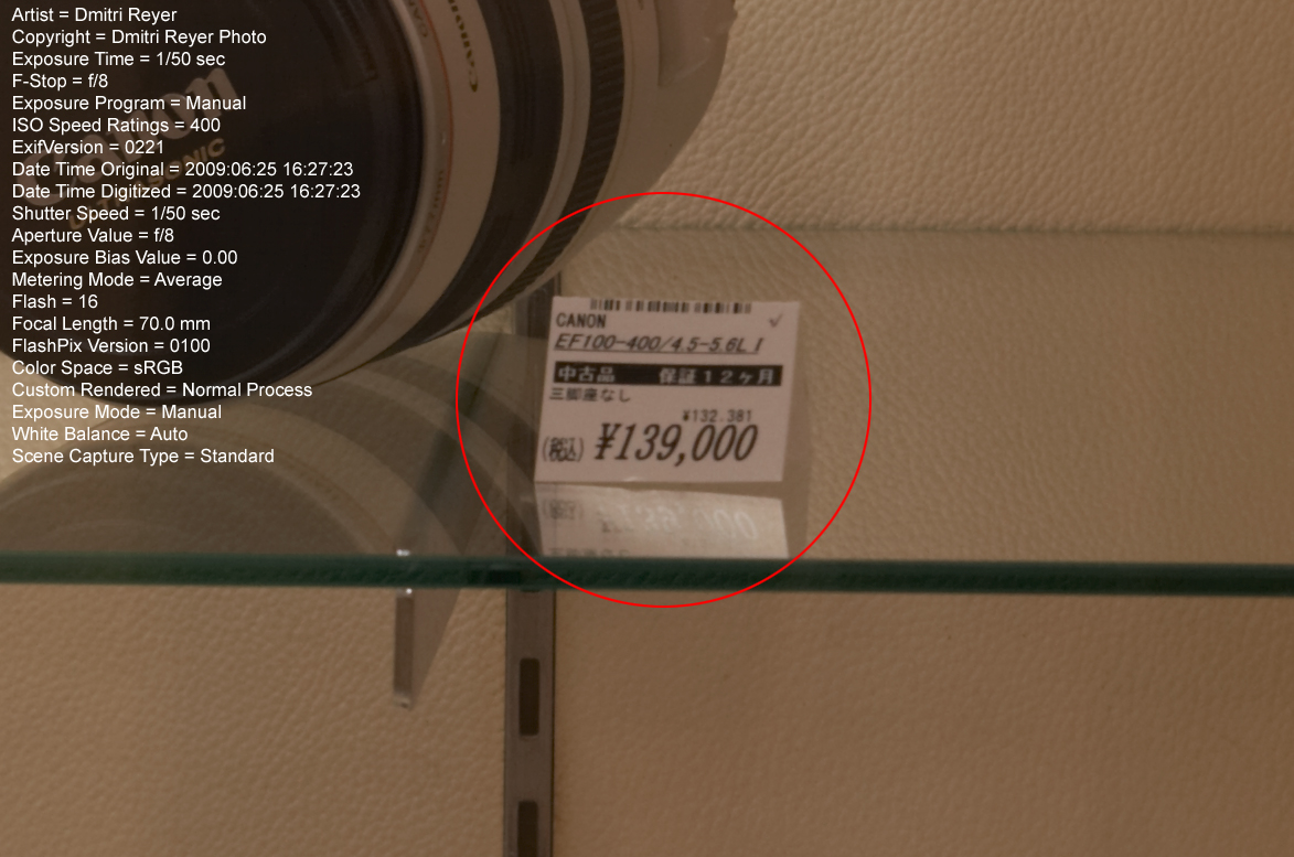

F8 @ 70mm
100% 1:1
F8 @ 28mm
100% 1:1

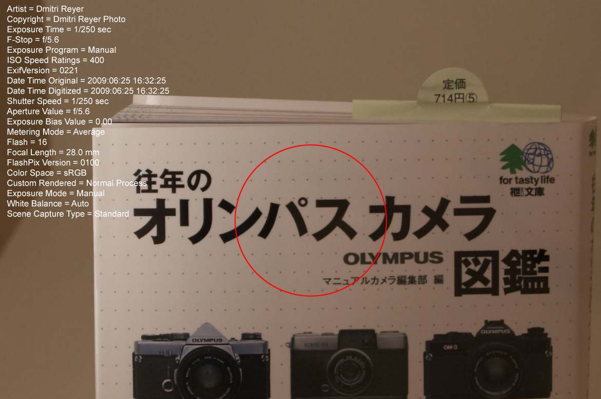

Next, 28-70mm F2.8L Copy Nr.2
F2.8 @ 70mm
100% 1:1
F2.8 @ 28mm
100% 1:1
F5.6 @ 70mm
100% 1:1
F5.6 @ 28mm
100% 1:1
F8 @ 70mm
100% 1:1
F8 @ 28mm
100% 1:1

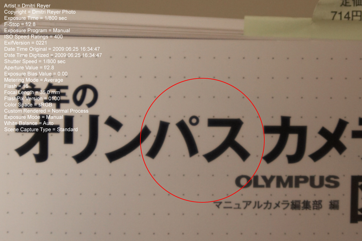

Last, just for reference, my own 16-35mm F2.8L
35mm @ F2.8
100% 1:1
35mm @ F5.6
100% 1:1
Personally, I can't see much difference at all.
Do I need to test another 10 copies in order to find a decent sharpness, or is this as sharp as a sharpest Canon zoom lense will get?

Krosavcheg
Registered: Apr 10, 2006
Total Posts: 1920
Country: Japan
Thank you for your replies guys.
Forgot to mention that the camera used was 20D.
Andre: Indeed, I was gutted when I just got the 16-35mm. I went to Canon recently, but they wanted about £80 to calibrate, so I skipped for now. Shooting was "One Shot". I also noticed the AI servo gives soft results. Funny enough, it seems as if 16-35mm is sharper at 2.8 than 5.6..
evan9: I was thinking the same thing about testing conditions. F8 and 1/50s shutter is not ideal setting, but the camera was steady on the tripod. As you can see at F5.6 and 2.8 the shutters varied from 1/160 to 1/640, which should be good enough handheld considering the focal length. My hands were resting on the table and movement was minimal.
Correct me if I am wrong here:
Imho the lense should perform adequately in most conditions. If the lense requires ISO100 and shutters in excess of 1/1000 in order to produce good results, it renders the lense quite useless.
I just don't have a clue as wtf is wrong. Most likely it seems to be my lack of skill.
Prior to 20D I was shooting 350D and in case of 16-35mm the results were exactly the same. Only about 30% of my shots are keepers.
Other than these I got SMC Tak 135mm, 50mm F1.4 and Sigma 150mm f2.8 macro. Can be hard to compare those to a zoom.
Besides, recently I really struggle to get a sharp shot with any of the lenses...
