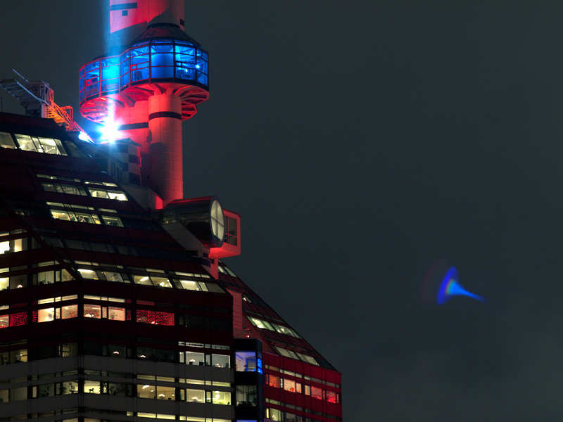

Here is a sample of what the Elmarit-R 90 can do:
The above is image 8 out of 16 making a vertical 2-row pano of this building and is taken at f/5.6.
Do you think the Zeiss would be better? Or am I simply hoping for too much?

I think the Zeiss might do a little better, but it pretty hard to predict these things. Do you have the first or the second version of the 90 Elmarit? The second should be better as presumably they have improved the coatings over time. To get no flare with such a strong light source may be asking a lot, but I would hope for less veiling around the light source. I hope this helps.

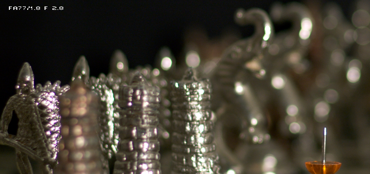

Thank you for the suggestion mawz, but no thanks... I have owned the FA77 (2 copies). I know the Pentax guys like the lens (one of the best lenses ever and all that) but I found it a bit more flary than the Elmarit. It also make a lot of CA and when going from the 6MP Pentax DS to the 10MP K10D I just sold it off:
The LoCA doesn't disappear until stopped down to f/5.6 or even f/8.

My Elmarit-R 90/2.8 is the second (and last) version. I don't have the schematics available but I think it may be a four element lens only...
It was not a fair question. How the heck could anyone know if another lens would do better - unless it was an überlens of course.
For the moment I guess I'll work with what I have. The spotlight on the top of the building is quite a tough bulb, perhaps something between 1.600 and 2.500 W Xenon (just guessing here). I can clone out the flare.
