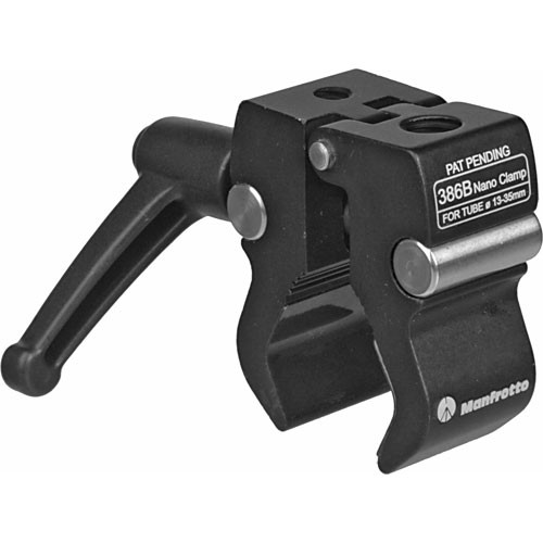

Bogen Nano Clamp size?
/forum/topic/709089/0
MichaelKirk
Registered: Dec 19, 2005
Total Posts: 1759
Country: United States
Anyone have a Bogen Nano Clamp (or the Avenger Nano Clamp).
Where does the stud mount? I assume in the two little holes in the image below.
Also, how wide is the clamp?
Thanks,
Michael
Roland W
Registered: Apr 23, 2004
Total Posts: 1446
Country: United States
The holes are threaded, one a 1/4" and the other a 3/8". Check the B&H web site under the specifications tab for further information.
And thanks for pointing these out to me. I did not know they existed, and will want to get a couple.
henryp
Registered: Jun 03, 2003
Total Posts: 1517
Country: United States
Roland W wrote: Check the B&H web site under the specifications tab for further information.
That'd be here
Henry Posner
B&H Photo-Video
MichaelKirk
Registered: Dec 19, 2005
Total Posts: 1759
Country: United States
henryp wrote:
Roland W wrote: Check the B&H web site under the specifications tab for further information.
That'd be here
Henry Posner
B&H Photo-Video
Henry,
Thanks for posting - always great to see BH show up here!
There is no info or measurements that I can find to say how wide this clamp is. Any chance you can take a measurement of this clamp? From the clamp handle side to the opposite side. 2",3",4"
Reason is, I thought the Super Clamp would work fine, but that clamp is too wide for my needs.
jarchambault
Registered: Jun 03, 2008
Total Posts: 67
Country: United States
All the way open it's about 3 1/4" and all the way closed (jaws touching) it's about 2 3/4"...all measured using the very scientific "hold a tape measure up next to it and eyeball it" method.
Roy Pertchik
Registered: Dec 05, 2004
Total Posts: 3343
Country: United States
I prefer these.... on one, I have a RRS small ball head and small lever clamp for a killer impromptu camera mount. I have 3 more w/ small Hama ball heads w/ cold shoe mounts for grab anywhere speed light placement.
http://www.filmtools.com/minorskinmin.html
henryp
Registered: Jun 03, 2003
Total Posts: 1517
Country: United States
MichaelKirk wrote:
There is no info or measurements that I can find to say how wide this clamp is. Any chance you can take a measurement of this clamp? From the clamp handle side to the opposite side. 2",3",4"
The dimension your image indicates is 2.5 inches. Other specs from the Bogen product insert:
clamp round barrels with diam from 13-35 mm
clamp surfaces from 3-21 mm
max load on the vert axis = 5.5 kg (12 lbs)
Henry Posner
B&H Photo-Video
