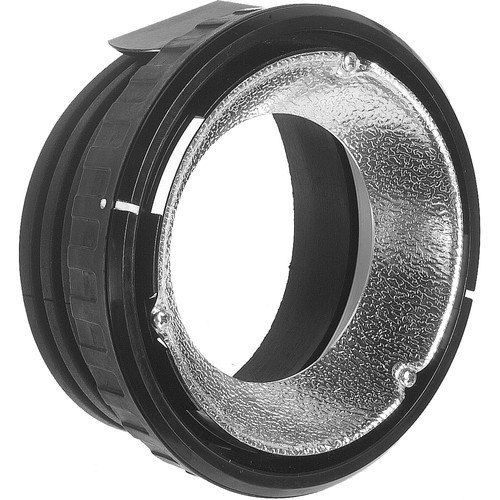

Register · Search · Software · Join Upload & Sell · Hosting
FM Forums | Lighting & Studio Techniques | Join Upload & Sell
Search Used
Archive 2009 · Acute Head + Eli Deflector
Conner999
Dedicated FM
p.1 #1 · Acute Head + Eli Deflector
Anyone ever tried a Profoto AcuteB head with one of the Elinchrom silver/translucent deflectors?
Am contemplating shifting to an AcuteB 600R kit from Elinchrom and sometimes like the ability to use my softboxes with the silver deflector and no diffuser. I am assuming since both Eli and Profoto heads have central app. 7mm umbrella mounts it would be possible...
Nov 09, 2009 at 01:45 AM
warrens
p.1 #2 · Acute Head + Eli Deflector
They both have 7mm umbrella mounts but if you use the Elincrhom Profoto speedring adapter...
...the umbrella mounting hole is blocked and not accessible. You may be able to drill a hole through the speedring or remove the metal plate cover to access the mounting hole but I haven't tried it.
Nov 12, 2009 at 06:28 PM
Conner999
Dedicated FM
p.1 #3 · Acute Head + Eli Deflector
Excellent info, thanks. Looks like some DIY work might be necessary
Nov 12, 2009 at 09:00 PM
FM Forums | Lighting & Studio Techniques | Join Upload & Sell
Lost your password?
