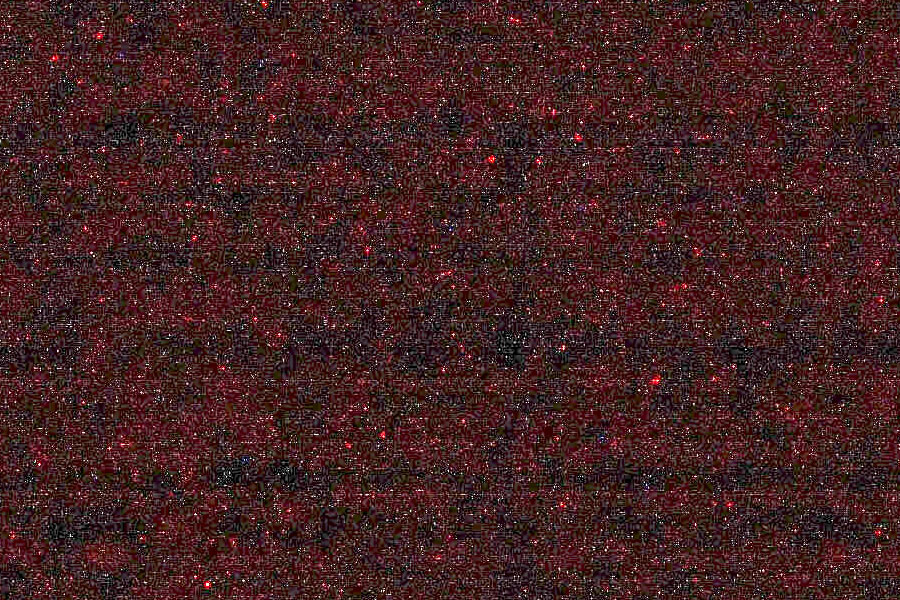

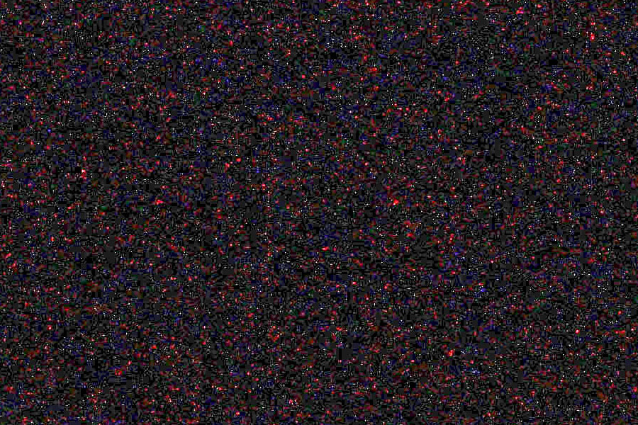

Just in case there are any gearheads that nutty/obsessive as I am, I shot a bunch of Black Frames with my 7D and 50D in JPEG (both no and max NR), RAW-ACR, and RAW-DPP at ISO's 100-12800. I boosted six stops in Photoshop and provide full-size crops and actual pixel images in a format that should allow you easily compare not only the different processing methods, but how the 7D compares to the 50D.
I'm still thinking/analyzing this a bit (I appreciate feedback) ... but for those folks who dislike "horizontal banding", you are going to like the 7D - as others have said, the noise is much more random and grainy/film-like - below are full-size's crops at ISO6400 using DPP - guess which one is the 7D and which is the 50D! ;-)
Click here to see the Canon 7D versus 50D (and 5DM2) Dark Frame Shootout
Edited on Oct 06, 2009 at 08:04 PM · View previous versions
Oct 01, 2009 at 10:03 PM
mttran
p.1 #2 · 7D vs. 50D vs. 5DM2 Shootout - all ISO's - JPEG, ACR, DPP Black Frames
RED means 5D2 or 50D so first one is 7D
