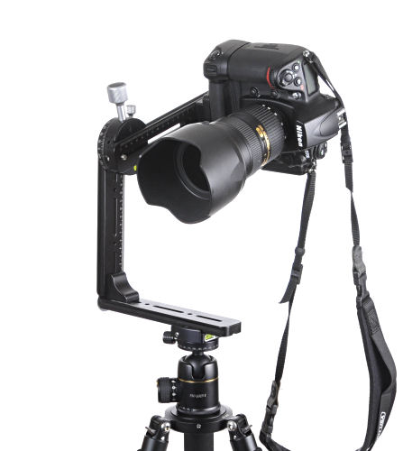

hejnarphoto
p.5 #3 · Hejnar Photo lens plates (ebay) any good?
http://www.hejnarphoto.com/ebay/products/g101a.html
this is new 90degree connector with anti twist future
http://www.hejnarphoto.com/ebay/pictures/G101A/thumbs/0001_G101A.jpg
Sep 18, 2010 at 04:18 PM

1)Thank you for measurements.
2)M3 holes are only on some RRS Products( multi purpose rails ) and position is limited to mounting holes
I did try this before. Limited position location did not work for me. Also max lenght of RRS rails is 6.0 inch....i need around 8
This is why
http://www.hejnarphoto.com/temp/bphead2.jpg
