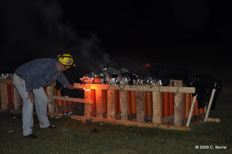

Lighting the first rack of 5 inch shells. Wanted the flash to capture the racks for at least a few shots. OK, but to me doesn't embody being there.
http://lh3.ggpht.com/_MBItFLjdUrA/SlEkb8b24PI/AAAAAAAACnY/O0MAWH9hC9g/s800/_DSC0122.JPG
Jul 4, 2009
1024×680 pixels – 93KB
Filename: _DSC0122.JPG
Camera: NIKON CORPORATION
Model: NIKON D90
ISO: 800
Exposure: 1/60 sec
Aperture: 4.0
Focal Length: 55mm
Flash Used: Yes
Latitude: 39.717233° N
Longitude: 84.015621° W

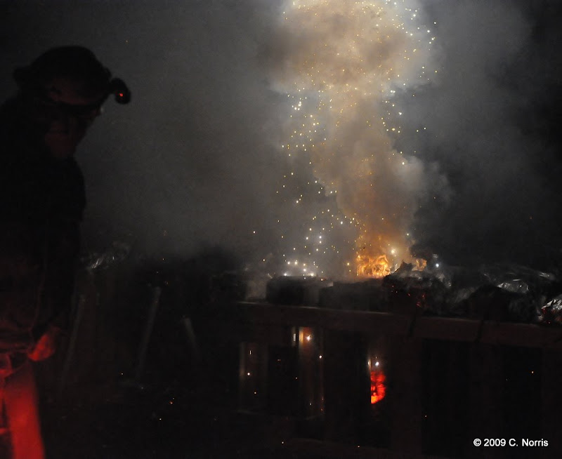

Here's one I like. Wish I could ave caught more of the shooter in it somehow. It's a plsit second after a "comet" shell launched. Those are the shells with the trailing "tail" of sparks as they go up. Until I saw this shot I never really noticed how early those effects start.
http://lh4.ggpht.com/_MBItFLjdUrA/SlEkhAt28PI/AAAAAAAACoM/m6Sm7E6EHL0/s800/_DSC0150.JPG
ul 4, 2009
1024×837 pixels – 78KB
Filename: _DSC0150.JPG
Model: NIKON D90
ISO: n/a
Exposure: 1/800 sec
Aperture: 4.0
Focal Length: 55mm
Flash Used: No

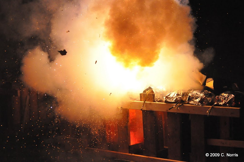

A Big Boom. 2 racks of 6-inch shells going off together. This could be felt. I thought my camera and eyebrows might melt. Is there any way to lessen the harshness of the ball of fire? It is really that intense, but looks overexposed at the some time.
http://lh5.ggpht.com/_MBItFLjdUrA/SlEkuyMoGjI/AAAAAAAACqg/C0D4KZq76cM/s800/_DSC0221.JPG
Jul 4, 2009
1024×744 pixels – 129KB
Filename: _DSC0221.JPG
Model: NIKON D90
ISO: n/a
Exposure: 1/200 sec
Aperture: 4.2
Focal Length: 55mm
Flash Used: Yes
