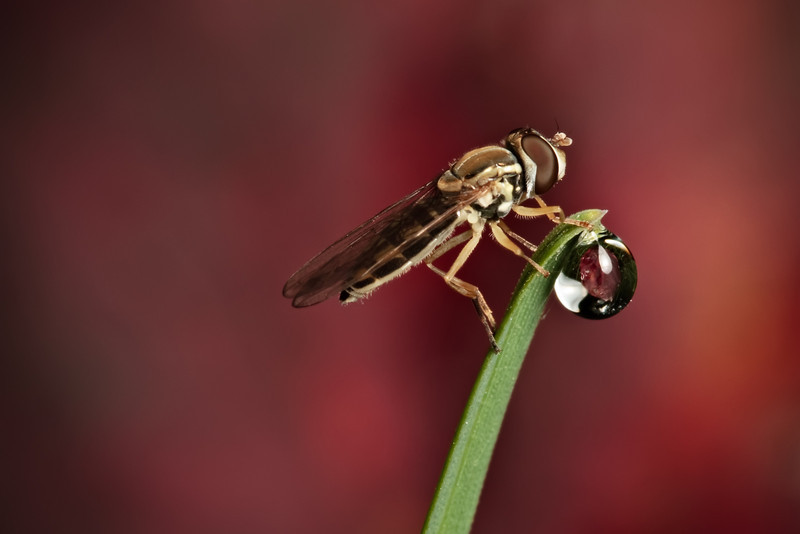

I have used a 1.4x + kenko tubes + canon 100mm and have never noticed any negative effect on the image quality. So, I doubt there would be a problem with the 150. Theoretically though, the addition of the 1.4x does impact the image, as you are adding more glass. However, as I said, I have not noticed anything so significant that I would not use it.
Here is fairly recent example:
