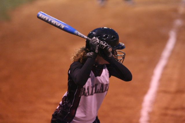

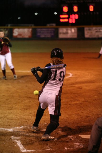

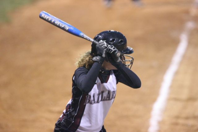

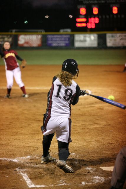

Had a problem with Capture One 4, forgot I had DPP on the MBP. Images have been resized, but that is it.

Image #1
Normal Lighting on Field

Image #2
Color shift in Lighting on Field

Image #3
Normal Lighting with 5D

Image #4............ EXIF is intact with all 4 Images
Color Shift in Lighting with 5D

It's not a camera problem. It's because of a crappy lighting system at the field. If they had used all three phases of the electricity supply instead of just one to supply the lights and if they mixed them up at each lighting stand then you'd have more consistent lighting with less flicker and less colour variation. The lighting is working at 50Hz or 60Hz (60 in the US) and your shutter speeds are way faster than that in order to freeze the sports action and so it's practically impossible to overcome the problem except by going to another field
- Alan
Mar 30, 2008 at 09:49 PM
JDSA
Image Upload: Off
Added Images for MKIIN Questions
Alan321 is correct, the examples above are due to lighting cycles. The local college where I sometimes shoot has very low, cycling lights whose fields don't overlap much. It's not uncommon for two consecutive 1D2N shots to show red hair/yellow wall and yellow hair/red wall on high speed.
When I shoot under the also cycling lights at venues such as the University of Phoenix Stadium (Phoenix Cardinals) or the Jobing.com Arena (Phoenix Coyotes) the lights are so high up that there is virtually no WB shift due to cycling at high shutter speeds.
At the softball field shown in the above posts there is no white balance. Nor is there a single desirable shutter speed. Each image has to be finished separately for WB and exposure. Been there done that

Agreed, this is a WB balance issue because of the lights...typical. Best to shoot RAW and change in post before conversion.

In the shots of #19, it is easy to tell that this is a lighting issue. Notice that while the field has dramaticaly changed color, the scoreboard has not.
It does seem odd that the scoreboard is much darker in the red shot. I expected the metering to be different, but it is the same.

This is exactly what I said above. I shot a track meet at the University of Iowa and because it was indoors and the lighting was even closer, I had bad shift in color just like yours. I get this at most of the high school basketball courts around here too.
Just something you have to plan on in PP.

I am very thankful for the responses. I read the link from Canon 10D. Very informative regarding catching the lighting cycles. I have never encountered those type of lighting issues before, so it threw me.
