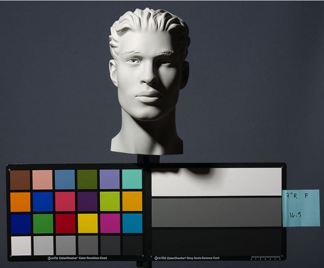

I was intrigued by comments about the SoftLiter II from Photek, so I ordered two.
One broke when I was spreading the umbrella portion for the first time. The umbrellas are "delicate" but the diffuser that fits around the strobe and covers the umbrella is nice. Wish they would sell just that portion.
Anyway, while I was at it I did a comparison of all the modifiers I have for my AB800s.
I will add replies to the thread to include each example for comparison.
The first is the 7 inch reflector straight. The numbers on the post its are my Minolta flash meter reading taken at the nose of the subject. (It was nice to find a subject that doesn't complain about having to sit still and not move for a test like this.)

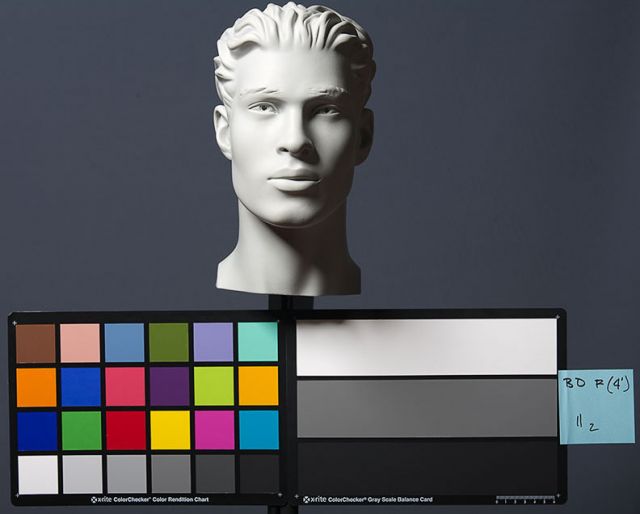

AB beauty dish 4 feet from the subject

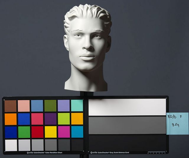

AB Beauty Dish with diffusion cover:

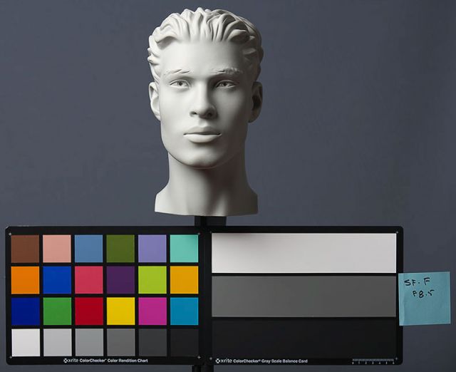

AB 24X36 inch Soft Box:
This is a very nice unit. It has an internal structure that permits spreading it like an umbrella, tightening the set screw and then snapping the diffuser in place and then valcroing the SB panel.
It actually takes less time to set up then the Softliter.

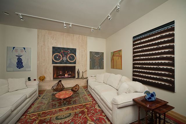

And to complete things, here is a lighting test using two Softliters, one on each side of the camera.
The one on camera left was aimed toward the wall on the right, and feathers a bit to bring up the exposure on the left edge of the frame. The light on camera right was aimed toward the wall on the left with a bit of feather to light the right edge of the frame.
My recollection is that the exposure was F8 at ISO 200 on my 5D. The metering ranged within about 2/3 stop across the room. The top of the Softliters were place about 3 feet below the celling.
This is with Sigma 12-24MM at 12MM.

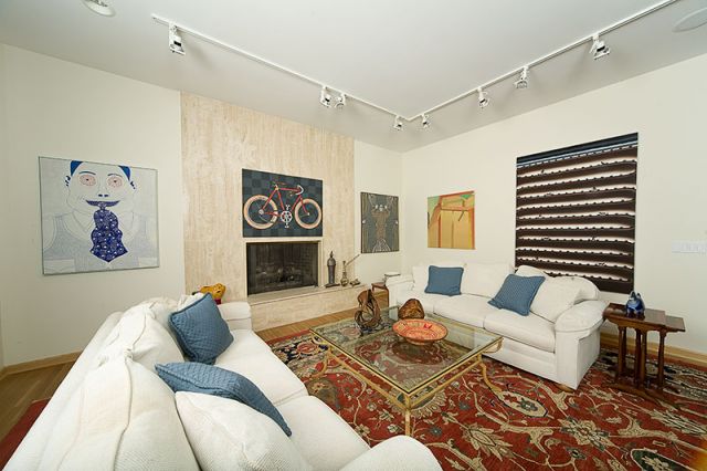

Here is another example of the Soft Liter. Again one on each side of camera, tilted down about 30 degrees with the top edge of the unit against the ceiling. (BTW the ceiling is 10 feet in this room.)
Did a second exposure using just the modeling lights to get the flames then masked the layer and painted the flames into the Soft Liter exposure.
The light unit reflections are "hidden" in the painting over the fireplace. Also feathered the lights to give a bit of vignette to the edges. (And remembered not to do the lens vignette corrections in Camera Raw.
I think these Soft Liter units are keepers, even with the "delicate" umbrellas.
Now just have to get the broken one replaced. (I hope the warranty is longer than 24 hours. )

Great test. It's nice to see this type of comparison. They were all shot at the same power setting, right?
Mar 09, 2008 at 01:39 AM
dmward
p.1 #10 · Strobe Modifier Comparison
Yes,
all at full power.
I think I mentioned that the figures on the post its are the meter readings. I found that the whites might clip on the Color Checker at the nearest 1/3 stop. stopping down another 1/3 stop gave me a histogram without clipping or buried shadows.
