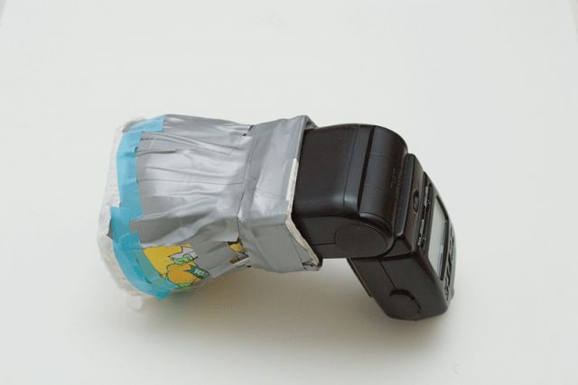

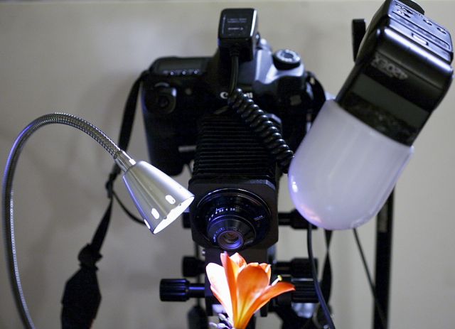

I am looking for a way to light my macros best possible. Now I am using the internal flash with a light tunnel or a diffuser that I put on my lense to diffuser the internal flash. The diffuser can be used with my external flash, the Sunpak 383 on the camera too, but I have not tried it so much yet. I also have a stofen omnibounce to put on my Sunpak.
It would be great if you folks could post pictures of your macro lighting setups, so I could get inspiration to how I should light my macro the best.
My home made light tunnel:
My diffuser with internal flash:
My diffuser and external flash setup:
The macro solutions I have tried this lighting with, is:
-Stacking lenses (reverse one lense at anothter for example: Nikon 50mm f1.8 at Nikon 28-80mm, Nikon E 28mm f2.8 at Nikon 105mm f2.5 AIS)
- Close up lense 500D (on Sigma 70-300 APO, Nikon E 75-150)
- Macro Teleconverter, Vivitar Macro focusing teleconverter(With 50mm f1.8 for 100mm f3.6 and 1:1, with a borrowed Sigma 50mm f2.8 macro for 2:1 and together with PK-13)
- Extension Tube, PK-13 (Together with the Vivitar Macro Focusing Teleconverter and Nikon 135mm f2.8 AIS and togehter with a Sigma 50mm f2.8 and the VMFTC)
Also have a reverse adapter on my way, try to reverse a 50mm and a 28mm direct to my camera.

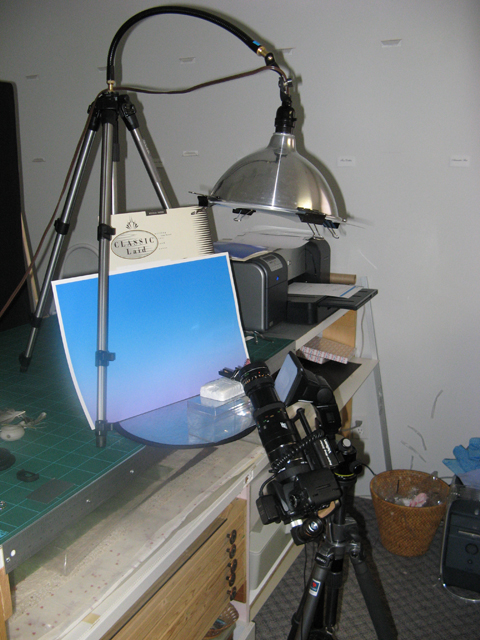

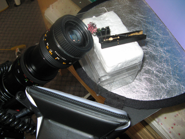

Pic of my macro setups below - lots more info here http://www.flickr.com/groups/topic/66514/

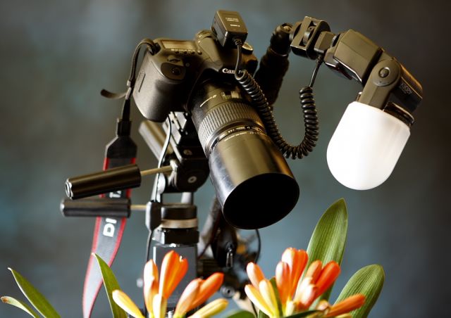

Hmm...LordV,you just gave me an idea to try to make a kind of flash bracket of the equipment I have. This is what I have:
*Hama flash bracket
*Nikon AS-15 Flash adapter
* Sunpak 383 Super flash
* Sunpak small wire to connect from sync adapter to flash
* Flashgun adapter
The flashgun adapter can tilt the so it goes more beside the lense. Only need some way to fasten it to the bracket without destroying it. Should have found a cold shoe thing with a stud in the other end, but I guess that is hard to fin

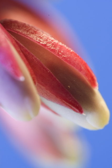

Some pictures taken with the internal flash and the diffuser:
(I think I maybe used the external flash with a stofen Omnibounce on a slave together with the internal flash on these)
A drop on a tulip:
Inside a tulip, some stamens:
Also a drop, but inside a tulip:
Some rose stamens:
A picture taken with the light tunnel:
Edited on Mar 02, 2008 at 05:47 AM

The lighitng in your shots is beautiful, Sissel. My favorites are the drop on a tulip and rose stamens. Lovely.

I found a solution to how to fasten the flashgun adapter to the hama flash bracket. Found some kind of screw wich fitted into the stud in the flashgun adapter, and persuaded my husband to drill a hole in the hama flash bracket, so I could fasten the bracket and flashgun adapter together.
Also tried to made a diffuser thing like LordV uses, with coke cans. Used paper towel and food paper (do not now the right word for this in english.)
Below is two pictures of the new setup:
Not quite sure how the flash should be positioned for the best light yet, trying out a bit, but getting most confused.
Do you position your flash higher than the lense and downwards or at the same height as the flash and from the side?
