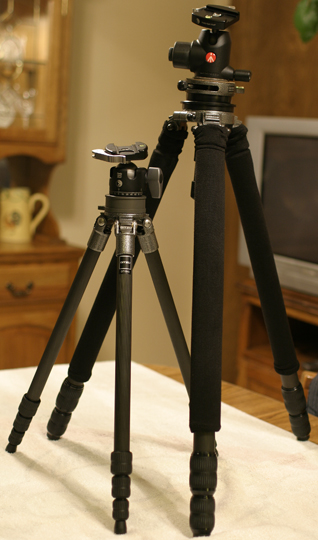

BeeMan458
Image Upload: On
p.1 #6 · Gitzo 1530 sturdy enough for my gear?
Measure your luggage and see.
The 1540 is surprisingly rigid but doesn't do well with heavy torsional forces such as is the case of blustery conditions like on a coastal cliff.
Everything is a trade off as in real terms, it's a two tripod world. The 2540 hits the middle ground squarely but because it's designed as a middle ground solution, it too is blessed with it's foibles.
A 1540, with a Kirk FP-100 tripod mount plate (column removed) and a BH-25Pro ballhead is a scant 1221g compared to the weight of a 2540 (column) w/BH-40LR II attached.
The point of the above, even at this price level of performance, there's still consideration of compromise.
I've settled on the 1540 w/BH-25Pro and a BH-40LR II combination and an obsolete 1325 with Bogen/Manfrotto 468MG w/RRS lever clamp attached. I owned the 1325 before the 35XX series came out and there's not enough of a benefit, at this time and point, to merit the cost of an upgrade.
Sample pic embedded below; 1540 w/BH-40LR II and 1325 with 468MG w/RRS lever clamp.
