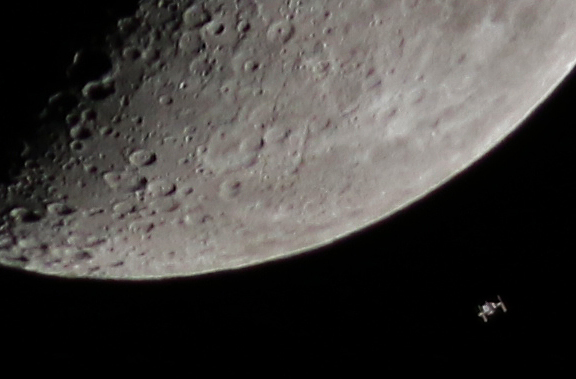

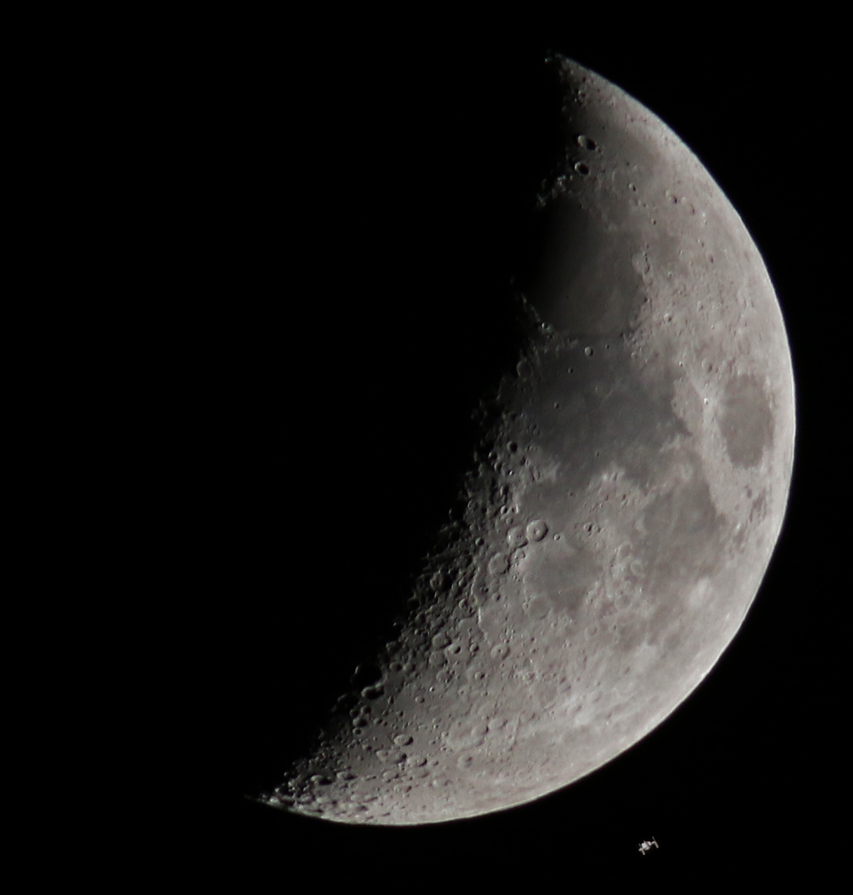

I don't know if these are my best images from tonight, but here goes. Taken with the same lens and body for perspective:
Image #1 Montage of Moon and ISS (cropped).
Image #2 Montage of Moon and ISS (cropped further).
Image #3 Enlarged version of ISS.
Canon 7D2, Canon 400mm F5.6L, Canon 1.4x TC II.
EDIT: EXIF metadata incorrect for the ISS image. Corrected: ISO 1600, f/8, 1/2000th.
For a sense of perspective, the ISS is about 240 miles away and the moon about 240,000 miles away.
