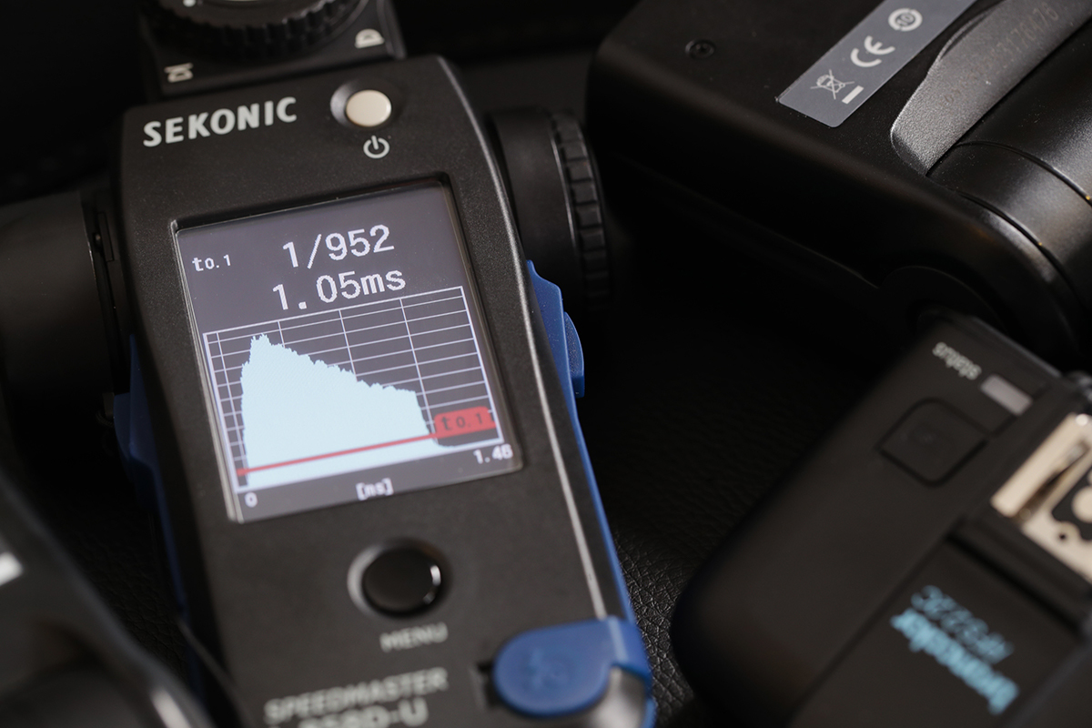

Since most manufacturers quote t0.5 times as it's more impressive for marketing, I decided I'd make use of the new Sekonic meter that allows for not only HSS metering, but measures flash duration as well (configurable for t0.5, t0.1 or anything inbetween) — to test all of my lighting for flash duration.
If I can get my hands on other lights to test, I'll add them, or maybe make an interactive chart/graph for all of my flash duration tests.

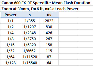

p.1 #10Flash Duration Analysis with my new Sekonic L858D-U
Canon 600EX-RT FDA
Apr 28, 2017 at 01:40 PM

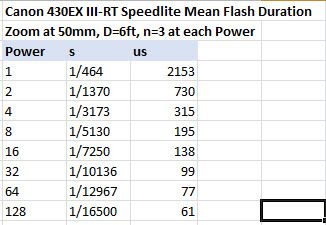

p.1 #11Flash Duration Analysis with my new Sekonic L858D-U
Canon 430EX III-RT FDA
May 03, 2017 at 12:18 PM

p.1 #12Flash Duration Analysis with my new Sekonic L858D-U
Thank you so much!
