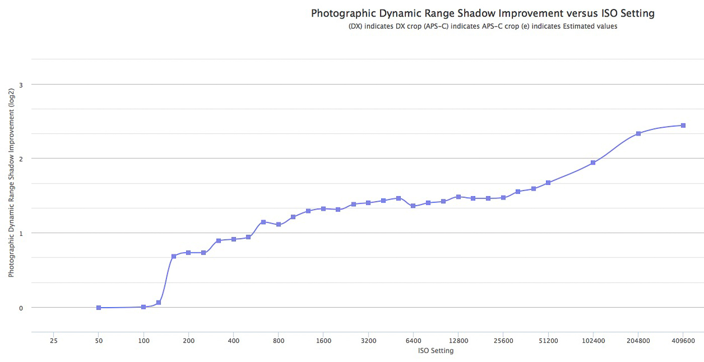

The 1DX2 is relatively ISO-less from 400 up to 25600. Not as perfect as Nikon D7200 or D500 but still very good. This would be why you could recover without too much quality loss.

Yes, you can pick from almost every current camera. Check the Nikon D7200 to see a purely ISO-less camera.
http://www.photonstophotos.net/Charts/PDR_Shadow.htm
Explanation is here: http://www.photonstophotos.net/GeneralTopics/Sensors_&_Raw/Sensor_Analysis_Primer/Photographic_Dynamic_Range_Shadow_Improvement.htm

I see the point about ISO 400 onwards, but if somebody is really trying to get the best results they can in a wide DR situation, I would think minimally 1600 through 25600? The way I think I am to read those graphs is to find the flattest area, and then consider just using the ISO at the farthest left of that "line". Perhaps I am misunderstanding the intent though?
I have a 5D4, and looked at its graph, I am very confused on the huge spike at ISO 5000, in what otherwise seems to be a pretty flat area from 1250 through 16000.

Still with a Canon sensor you are better to shoot at the correct ISO in camera. The 1DX2 and 5D4 curves are better (just look at the 1DX and 5D3 curves to see how far they've come) but you will be penalized for using gain in post instead.

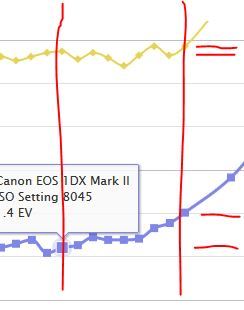

Here are the two, but these graphs don't show how much shadow noise there is on a body due to electronic noise introduced by the camera. It shows that post processing yields about the same results on the 1DX as using a higher ISO, but there are improvements on the 1DX2 to using higher ISOs, than doing post pulling of shadows.
Top graph is the 1DX, and the bottom is the 1DX2.

I'd have to think the 1 1/3 stop difference in DR at those ISOs between the two cameras would come into play with such a large push in post. The 1Dx2 is cleaner to start, that has to help. How much a difference in the any given photo is hard to say.

@NCAndy, so when comparing 2 cameras, the farther up the worse the electronic read noise? That can't be the case either, because plugging in different cameras I am familiar with, the results don't match my or the industry's findings. For example the 50D and the 1DX2 are close to the same curve...
I don't know how you can use this site to compare 2 different cameras, other than to figure out where you have horizontal lines for ISO-less ranges.
I like this chart for read noise comparisons though.
http://www.photonstophotos.net/Charts/RN_ADU.htm

That specific graph isn't to compare ISO noise, it is to show how much penalty you get if you don't use the correct ISO (or exposure in general) in camera. Look at the 1DX vs 1DX2. You can see the 1DX is a big issue if you underexpose. There are other graphs to show DR and ISO noise but some of those even state that cameras can't be compared with them.
However at 2500 and up the 1DX is ISO-less essentially where the 1DX2 is still better to get it right in camera. However from ISO 100-2500 the 1DX needs to be properly exposed and the 1DX2 is a little more forgiving but you will still get a penalty if you underexpose and boost it in post.
D7200 is a flat curve along the bottom of the graph showing you can shoot at ISO 100 and push it in post say 5 stops to what would have been ISO 3200 and the noise and DR would be equal to if you shot at ISO 3200 to begin with. But on the Canon cameras, doing that will not net you the same result and pulling up 5 stops will result in a worse image than if you had used 3200 in the field.

So the 50D and the 1DX2 have very similar penalties of using analog gain vs digital leveling during post.

I'm certainly no expert on these charts and sensor specs. To me, the 1Dx2 and 5D4 are able to take more adjustments than any other Canon camera I've used, even if the 1Dx shows to be slightly better in read noise at high ISO. I'm not sure you can put the total sensor performance into one chart though many obviously do that. It was interesting to me that it seemed in my example above that there was little penalty for my exposure mistake. I think for Canon sensors anyway that's an improvement over my previous cameras. I would always aim for a proper exposure in camera though, but in a pinch it's good to know a file might be salvaged when needed.
