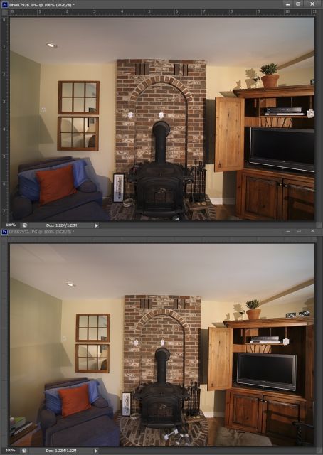

Here's a comparison of a Tokina AT-X Pro 17/3.5 (top) and Samyang 14/2.8 (bottom), on 1DsIII. That's the closest example I have on hand.
I own the Samyang and 16-35/28L II. I might have a chance to compare them directly, but not for at least a few hours.

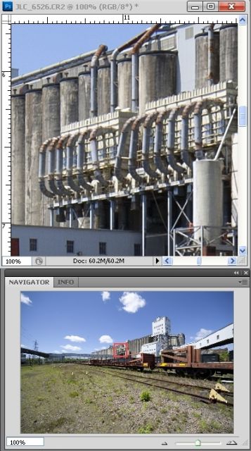

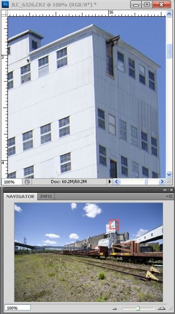

jcolwell
p.1 #12 · 14mm vs 16mm FOV comparison?

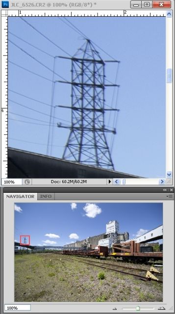

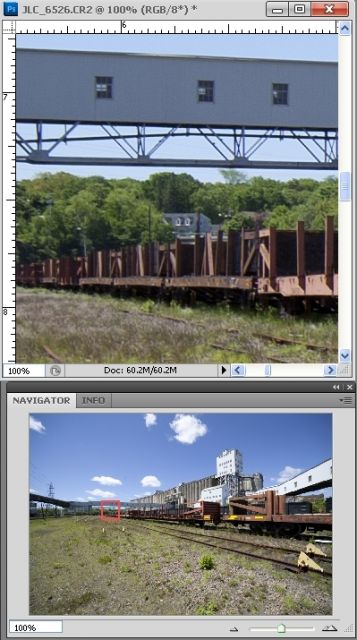

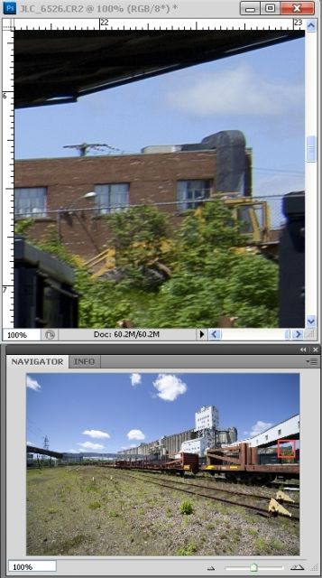

The Samyang 14/2.8 UMC is an incredible bargain. Here's some sample 100% crops from a test I did a few years ago (1DsIII, f/8). The red square in each bottom panel shows the location of the 100% crop in the top panel.
Jul 10, 2014 at 06:45 AM

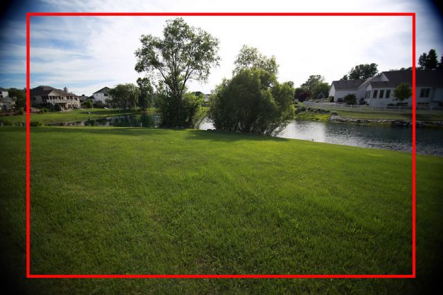

Here you go, my Tokina 11-16 on my 5D3, 14mm vs 16mm, ignore the vignetting, I can use this at 16mm on the 5D3, or I usually put a 1.4x on it, giving me a 15-22 f4 lens.
14mm with a 16mm crop box, vs the 16mm shot...

Very helpful! Thanks for posting this!

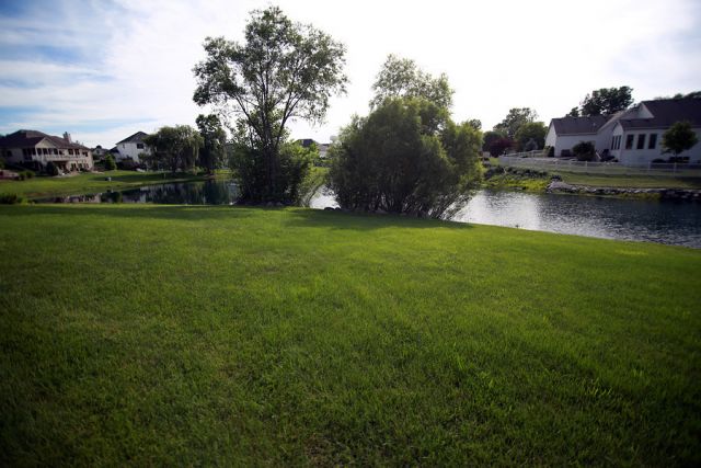

This may not be exactly what you are looking for but it is an example of 14mm FF vs 10mm Crop. (16mm)
