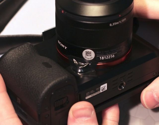

Roger at Lensrentals tested Sony A7R Light Leak
Roger at lensrentals.com just posted an article on the Sony A7/A7R light leak issue.
Here is summary of his finding:
  1. We tested several A7rs and several A7s and all were the same, so it’s simply a design issue, not a batch of defective cameras.
  2. The light leak occurs with the body cap in place, but is more severe with a 35 f/2.8 Sony lens mounted instead of the body cap.
  3. The leak is worst when the light is shined onto the lens-release button area. It is also bad when the light shines onto the lower left quadrant of the lens mount, and directly above the lens mount. Other areas either didn’t leak or showed only a thin line that was far less pronounced than these areas.
  4. Wrapping something around the lens mount stopped the left side leaks, but not the leaks around the lens-release button.
Read Full article: The Sky is Falling and the Light is Leaking: the A7r Anti-Massacree

I guess the Pentax K5 nor K3 have light leaks, nor the Olympus EM-1 or even Sony NEX-6 (according to Imaging-Resource) so I guess it's not like it's impossible to properly design a light tight, interchangeable lens camera.
I'm sure it doesn't matter to most users (practically) but for a few, it does...and it really should not exist on any high end, modern camera. Folks should not have to worry about putting hair ties and tape on their expensive $2K+ bodies to "bubble gum" fix them imo.

I guess this means you guys don't think I'm going to make a fortune selling my patented self-adhesive lens-release button light seals?? Come on, only $19.95
Mar 11, 2014 at 08:15 PM
Tariq Gibran
p.1 #8 · Roger at Lensrentals tested Sony A7R Light Leak
I think Sony should just include a roll of electrical tape and pack of hair ties in the box with the A7's. Yet another thing they left out... like the battery charger! Hey, you wanted Sony bashing right. Ha ha.
Tell people it also fixes the A7r's shutter vibration and you'll have yourself a homerun.

Thanks Roger. I tested my copy of the A7 and couldn't find any light leaks. 30 second exposures at ISO1600 while shining all around the mount and camera with a very bright LED light. Every photo was black, without any trace of light leaks. If it only shows at very high ISO it's a non-issue for me.
