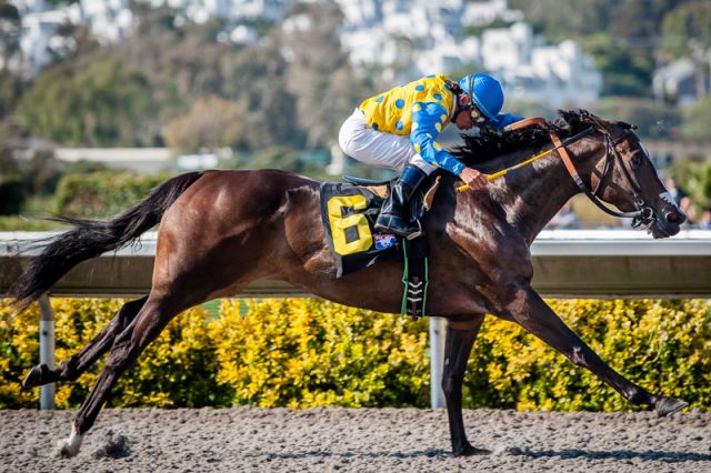

Shot from next to the track with a 70-200 @ 180mm - This was the perfect combo of location and lens

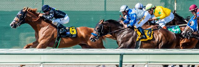

Out of the starting gate with a 70-200 @ 200mm and heavily cropped (a 300mm + would have been nice here)

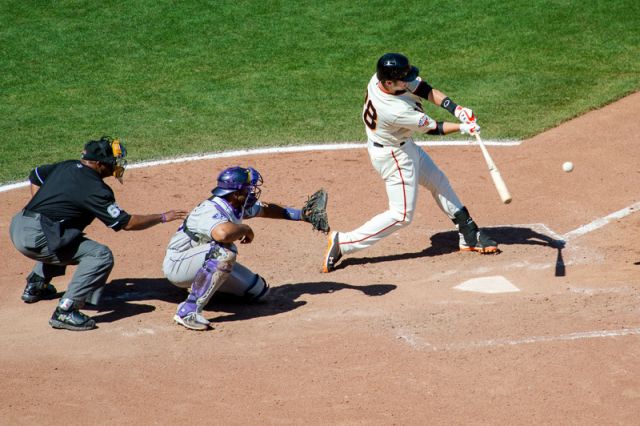

Shot from Club Level at AT&T Park with a 70-200 + 1.7x @ 340mm and moderate crop.

DPC1-- I am going to try my best to emulate those shots when I go to the track, especially #2.
