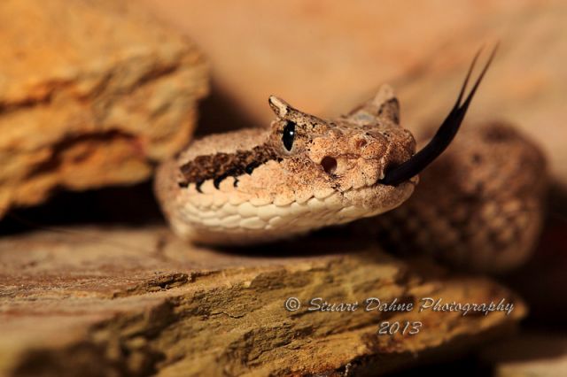

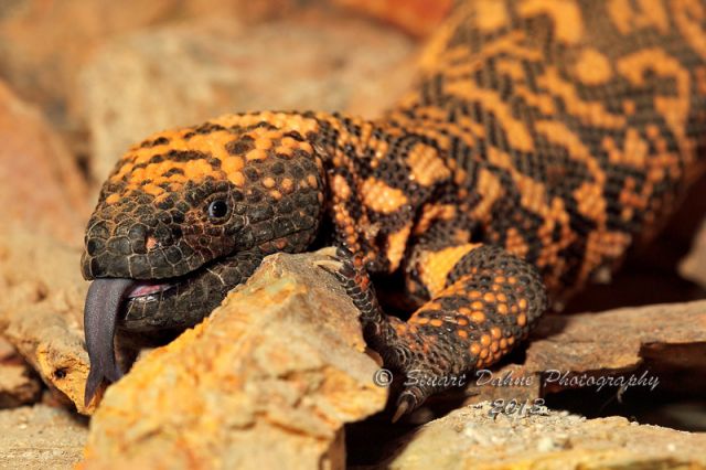

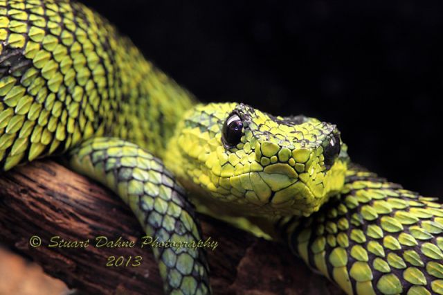

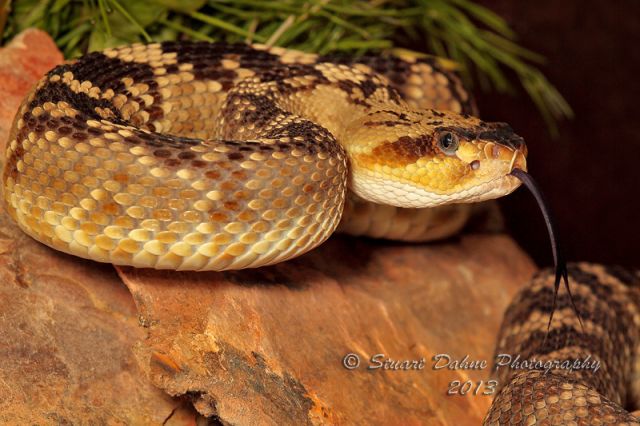

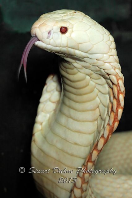

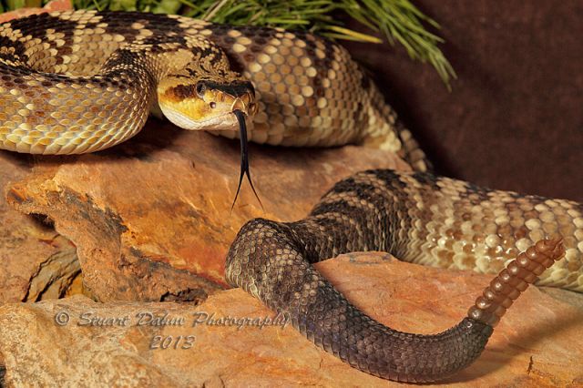

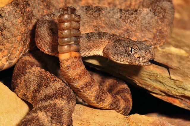

O.K. I have been asked by a local zoo to document an entire collection of Venomous Snakes (hundreds). I have been shooting them for a while using a Canon 1D MkIV and a 580EX II off camera and mainly a 180 macro however I think that the 70-200 f2.8 might focus faster and give me what I need. The zoo has asked me to design a station that we can bring these snakes into in order to photograph them. The table is a 6ft table and I need to be able to easily change the environment to simulate a natural setting. I attempt to shoot tight however we can't tell the animals where to pose so the entire scene needs to be functional. I am thinking about some simple backdrops and then using large trays for the "flooring" that would already have sand and rocks or natural greenery. I am not sure about lighting, I have a 580 EX and a 580EXII (that got dropped and broke the red lens this weekend but appears to still be functioning) and I also have a pair of Einstein 640's. I may also be replacing the 580Ex II (for trust reasons) but that would be with a 600rt.
Below are some shots that I did this weekend with the 580EX II and some quick creating for the scene. Because of our scene limitations we were limited to shoot similar species.
All and any thoughts, diagrams, input... or any help at all will be greatly appreciated!

Ideal lighting would be back rim light from 45° overhead and behind like 3PM sunlight to define the shape and separate from background. Then in front to fit scene to sensor key and fill to simulate the skylight outdoors which is a combination of dominant downward vector and less strong vectors from the sides. Do that by placing fill near the lens and key light directly above it.
I have not shot snakes but direct flash which creates specular refections off the scales will probably create a better impression of 3D in a 2D photo than a big diffuse source.

I'm thinking one over heah light, one light on each side of the subject flagged as to not reflect in the lens also one fill light from the camera position. Balance each light for effect then take reading for all lights. My goal would to get as much highlights on the scales and reflection of the fill light in the eyes but not so bright that your unable to tell if the snakes pupils are round or slits like a cat. Easies way to tell a poisonous snake in the USA round pupils are non venomous where slit pupils are. Also try for several poses stretched out, sleeping coil, sticking coil etc
