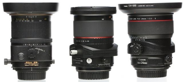

Left to right: The Nikon, Samyang, and Canon 24mm tilt-shift lenses

It looks like a nice lens. Do you know if the tilt and shift axes can be rotated with respect to each other? For example, in the lens images at the Adorama link, the lens is set up for nose up/down tilt when you shift side to side.

In the first shot, it looks like the knobs are in a row...which seems to imply that you can.

We got a bunch in yesterday - you can rotate the tilt and shift lanes with respect to each other.
I did preliminary testing yesterday and have one to shoot with this weekend. Initial impression is that optically it's OK -- no Canon 24 TS-E, but still OK. Hopefully have a post up with Imatest results by Monday.
I've got real concerns with the build quality, though. The lever that you push to rotate things is very flimsy plastic (it's metal in every other tilt shift I've used) and I can definitely see it breaking off, for example (it flexes 30 degrees just pushing it to rotate things). With most of the RokiBowYangs I don't worry about build quality too much, the price makes that a very reasonable trade off. But I'm a little leary about a $1,000 lens that will be nearly impossible to get repaired being quick to fail. I'll probably tear one down next week and poke around inside to check on that a bit further.
