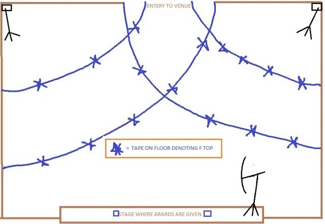

When I have had to shoot events/awards/receptions/awards. This is the typical setup that I use, and have great results with it.
The lights in the corners can be a linked speedlight system, Quantums open bulbs with half reflectors, or any system you can link to for i-TTL type shooting. I've even hidden these with fake trees....
The bands and X's on the floor are either duck tape/masking tape with a PER-MEASURED f/ stop marked on them. Whilst shooting, you merely look down at the floor when moving throughout the room to know what your stop will be. Of course, the linked shooting with mean you can use a 1/64 or about there... fill flash on body to get full even filled shots. Keep in mind these bands I've drawn are merely as a guide, and the only thing people would see on the floor is a 2" X 3" tape with (eg) 8 or 16 on it.
A PRIOR CUSTOM white balance is mandatory due to wall/ceiling colors etc...
The stage or dais, I usually set up an umbrella off stage (out of plain site) and balance that with on camera fill... I place a duck tape on the floor with an " X " so the recipients know where to hand off the hardware..
KEY POINTS : Measure prior to people arriving. Custom White balance. FILL FLASH IS A MUST. Be accurate with you're flash meter in marking the tape f/ stop markers. Sorry for the ' kids ' type diagram.. I shoot better than I draw.

Wow I love this forum and thank you guys for your excellent tips! John you're a great drawer, really. I fully understand both of your input and there's lots to learn for me. I have only two flashes, they can both go off camera and fired using manual flash. So I'm not sure if I can pull off John's setup. I could do some test shots with the two flash setup, although I'm not sure how I'm going to get the on camera flash up 12-18 inches, unless I just hold it in the air with my hand.
I've got a lot to chew on here so thank you again!

I've never found lighting up the entire room as John suggests necessary. Instead I utilize the inherent fall off of the flash like stage lighting to put the "stars of the show" in the spotlight of the flash. To deal with the color temp difference between the 6000 K flash and >3000K dimmed tungsten typical at events I gel the flashes with 1/2 CTO gel and set Custom WB with gray card off the gelled flash.
Setting Custom WB off the 1/2 CTO orange gelled flash makes anything in the range of the flash. 1/2 CTO isn't an exact match to the ambient background and gives it a slight warm look that matches the perception of "normal" looking faces on the people you focus on in an overall warm ambience room.
Because the color temp of flash and ambient are a close match the ISO of the camera can be increased to utilize more of the ambient intensity without the undesireable orange bias you'd get in a high ISO shot with ungelled flash. You can find the gel in sheets at B&H for a couple bucks. The Rosco Cinegel filter sample kit it sells for a couple bucks is also large enough to fit a speedlight and will give you one a wide range of gels and diffusion material Rosco sells with specifications telling how much they change color temp and exposure.
