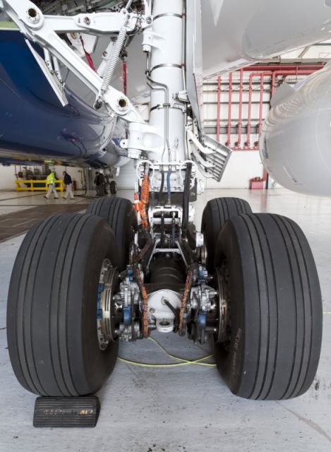

the much maligned (due to an unrelated component) 787 is currently over 50% composite overall. I say currently as it design and build are still in progression and that percentage will increase as they come off the line with even newer improved structure and components.
its probably better to refer to mixed material as composite then just CF as there is quite a difference. tripods today are still pretty basic tubing layup.
the main braces (see white angled parts left upper in image) on this 787 gear are pretty sophisticated composite components. now these can take a beating.
with this technology you can have that composite camera body you crave vs Mg alloy if you really want and the price comes down.
ref explanation:
http://www.albint.com/businesses/aec/IndustryApplications/SampleApplications/Pages/787-Dreamliner-Main-Landing-Gear-Brace.aspx
© sjms 2012
