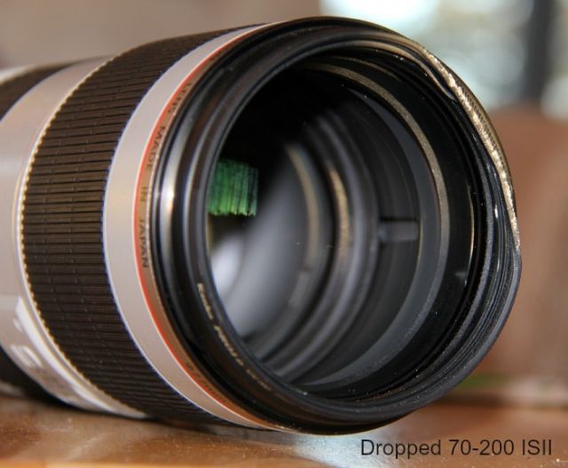

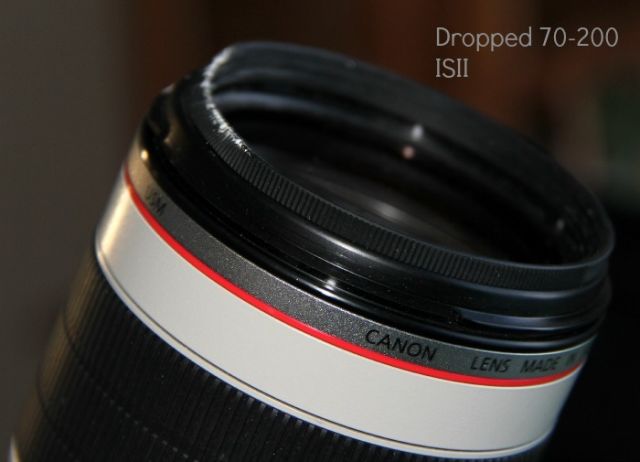

Well.......DadBlastedPackaFlatteraps !!!!!
It slipped from my grip and fell on it's face.
I am pretty sure the lens cap and filter saved the glass.
Can this be fixed?
My apologies if for any offence.
The filter ring is still attached.
Enough to make you puke.

Well, I have calmed down and had another look.
Seems like only the Kenko ring is bent. Tried to get it off by hand with a couple twists but it must be wedged into the threads. Nothing else looks damaged.

If it's just the filter that's destroyed, I was able to VERY carefully cut the filter ring with a dremel tool or a small hacksaw type thing. Cover the glass, of course, shove a rag in there or something like that, but if you are able to get the ring cut it will come off very easily.
A buddy of mine dropped his nikon 70-200 and the same damage occurred. It was as good as new once I got the filter off.

Oh, I got the filter ring off yesterday. Best $100 I ever spent. Saved my glass.

Good news.
Got a new UV filter today. The front barrel is not bent. The filter threaded on smoothly.
