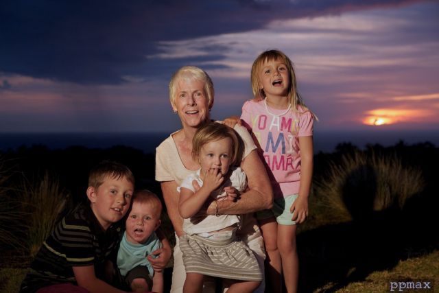

I finally had a chance to work on some of the files and would love an opinion or two.

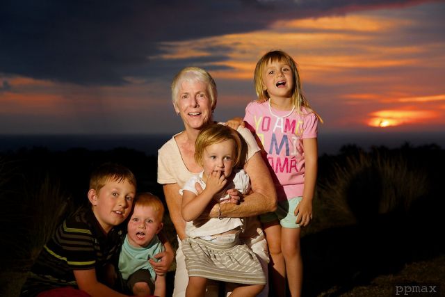

Here is the original, plus two files processed with Aperture and Lightroom. Lightroom has a great feature where you can use an adjustment brush to change the color temp within a brushed region. Aperture had brushes first, and I love them, but it's beyond me why I can't do a similar color temp change within a brushed region with Aperture <end rant />
Which do you prefer? IMO the cooler background of Aperture image gives the subjects a bit more pop, but I feel the LR image is more faithful to the color of the sunset. The subjects in the LR image are still a little warm...this was just a quick edit. The subjects in the Aperture image may need a bit of a push...
I prefer the more natural skin tones of the Aperture image; the purple sunset looks fine

Regarding the harsh shadows, looking closer at the highlights in the eyes it looks like my 2nd flash didnt fire for some reason...I had my A off to the left and B on the camera as a fill...looks like it didnt fill

I keyed in on the inside flap of the diaper, a hot spot on the babies shirt for and the letter A on the girls shirt for WB (they all read nearly the same at max R, middle G, low B). In review of the individual channels, red was really hot, so I brought up green and blue, as red was too hot to reduce. That is what gave me my WB for the group. Then I masked off the background/sunset to keep it from shifting with the WB adjustments as well as added some extra flavoring, this time masking off the group. (CS6)
I like what you did with the BG RustyBug. Looks like you increased saturation in various spots in the sky?
When I corrected in Aperture I set white balance by picking a gray stripe in my kids shirt, then warmed it up a bit.
Looking at the image again, I feel like I should have set my A on the right side of the frame, to possibly get some flash highlights from the same side as the sun...
