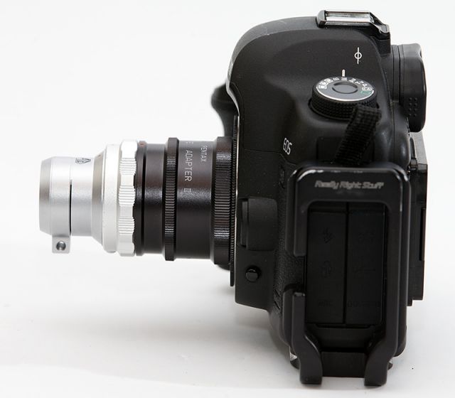

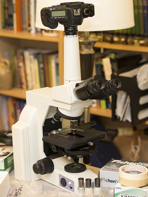

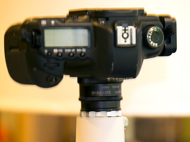

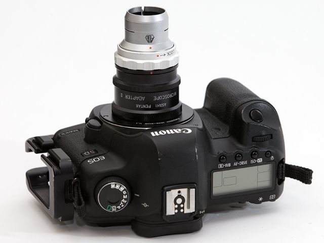

My daughter is getting great results on her microscope with no lens on the camera. She's using an old Pentax Microscope Adapter II (with M42 to EOS adapter) that I had hanging around, and shooting either down the eyepiece tube (after removing the eyepiece), or straight down the 'photo tube' that's on one of her mic's. She has the camera (5DII) on USB tether to a computer, where she uses LiveView Remote shooting in EOS Utility to view the image on screen and adjust focus on the mic. The microscope adapter isn't actually a good fit on the mic's she has, but it keeps the camera in place on top of the vertical 'photo tube'. It also works fine shooting down one of the two the eyepiece tubes, but she has to handhold it. It would be pretty easy to rig a magic arm and/or macro focus rail to hold the camera steady for shooting down an eyepiece tube. The cardboard core from a roll of toilet paper would probably do just as good a job, if you could find a TP > EOS adapter.

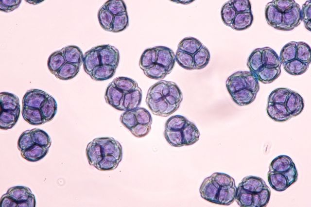

Here's a sample. Cranberry pollen at about 800x.
